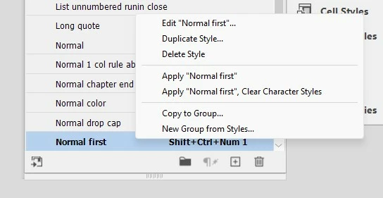

Hi all! Recently, perhaps after a update, when I import text from Word, almost invariably when I apply a paragraph style, I have to click on it in the Style palette and clear character styles (see Ckear Character.jpg below and attached).

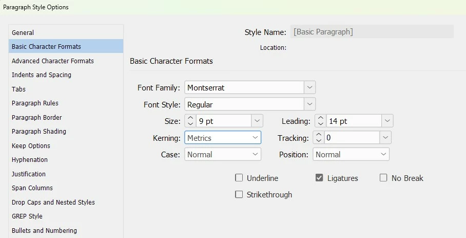

I've set up Basic to match the main font of the book (in this case Montserrat Regular—it's an unusual book, don't ask), but the Word doc still imports in Calibri, which I edit the Word files in. Then I apply Normal, say, and I still have to clear the character styles (see Basic paragraph.jpg below and attached).
It seems no matter what style I apply this happens, and I'm quite frustrated, as typesetting is taking my twice as long as usual for having to touch every paragraph.

The solution turned out to be the Character Style I had selected when I imported (Normal, which was set to Monserrat Regular) was making everything Regular and not responsive to applying the different Paragraph Styles. When I changed the Character Style to None prior to importing, I could apply Paragraph Styles and they worked fine. So, easy fix, but I wouldn't have realized it if I hadn't read the various responses.
