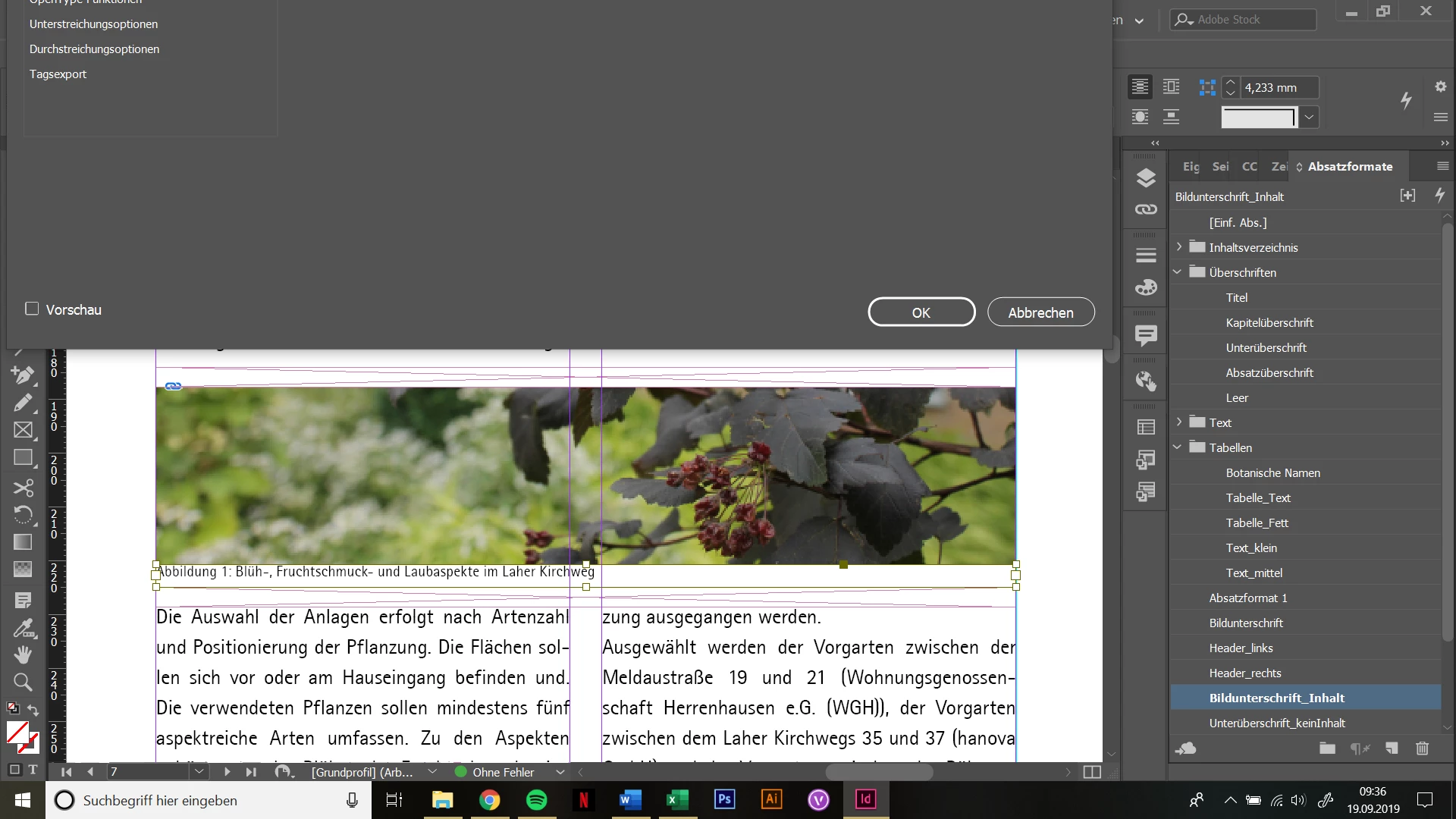

Paragraph styles window out of reach
Hello!
If I try to open paragraph styles in an extra window, it is half out of reach. There's no way to pull ist down or reposition it.
I've been working with two monitors and after separating them the first time, this happend. Now, even if I connect the second monitor, the window stays out of reach.
I'm relatively new to Indesign, so I'm sorry if this is an easy fix. I tried googling, but the solutions there (reinstalling etc.) just didn't work. Resetting prefernces didn't work neither, because ctrl + shift + alt didn't work ... I also suspect it might not be a problem with Indesign but maybe with my monitor settings. I'm just hoping someone here might have a solution, because it is really annoying and I have to print my thesis in about a week, so it's kind of pressing.
Thank you in advance!

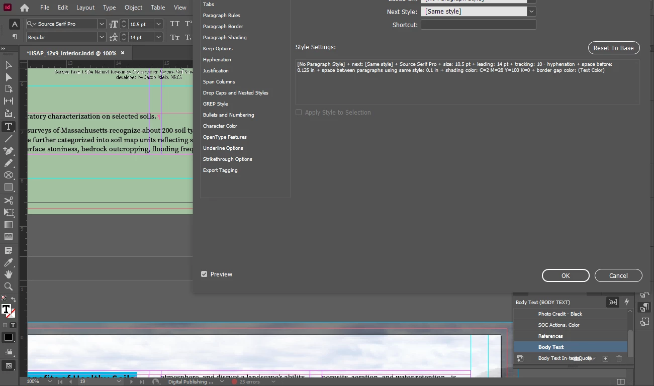

    January 29, 2021
    Hi, I'm having the same problem with the paragraph styles window and have not found a solution (resizing, changing display settings on my monitors, restarting). Character styles and object styles open in an accessible location.  Would appreciate any guidance, thanks!

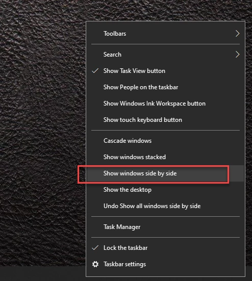

    September 19, 2019
    Try this -
