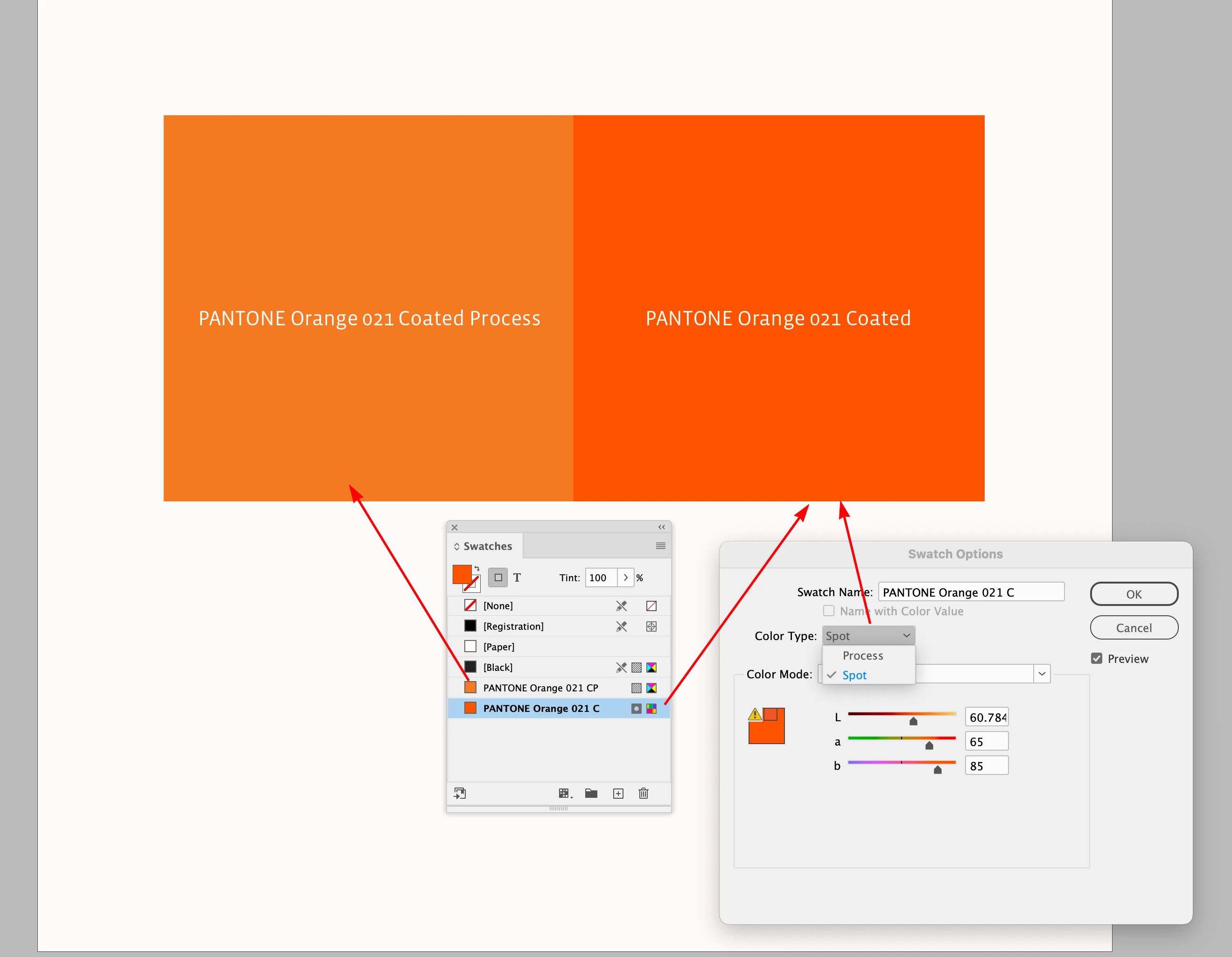

Hi @dimitri_cas , Check the definition of your PANTONE Swatches. InDesign no longer includes Pantone Libraries, but when they did there were solid ink spot libraries with the colors defined as Lab (C), and separate libraries for CMYK process color simulations (CP) .
A large number of Pantone solid ink colors are outside of the typical CMYK color gamut, so to display out-of-gamut Pantone colors you need the solid ink Lab definitions. Here you can see the difference with the out-of-gamut PANTONE Orange 021, which cannot be matched via CMYK printing:
