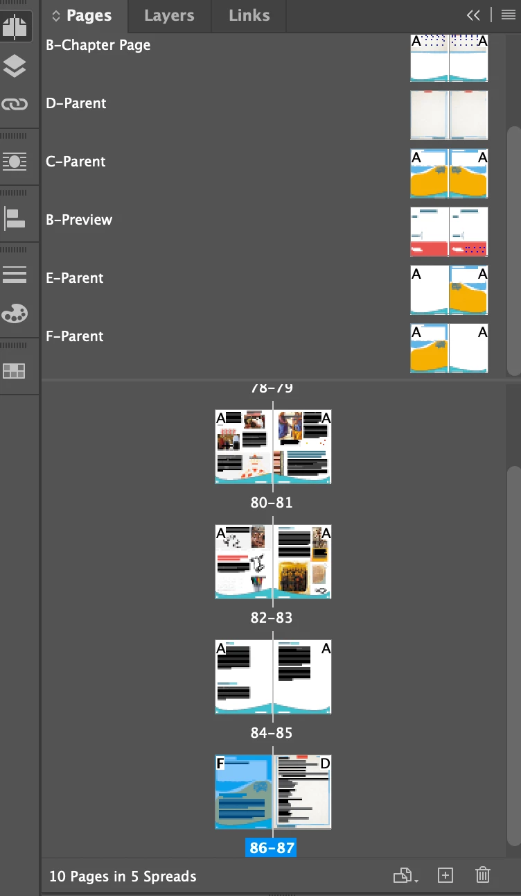

 I don't know if this is helpful, but to address both MrZZY and Willi A., I still have problems, even with the latest ID, of master/pareent page spreads affecting the other pages, so this is what I have to do sometimes: make the parent spread the way I want it (in my screenshot it's the C-Parent), but don't use that one for any pages. Make 2 copies of that parent spread (E-Parent and F-Parent) and then delete half the spread in each (the recto in one and the verso in the other). Use accordingly. Of course, can't use if your pages would need to shuffle 😞   I wish this weren't a problem. I've even tried locking different elements to a page: doesn't work.
