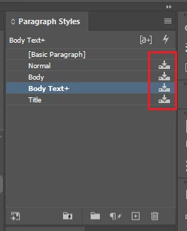

Some extra mess has been imported from WORD:

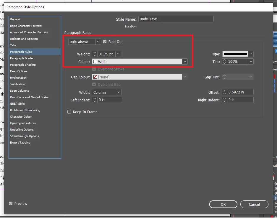

And, in the BODY TEXT ParaStyle, you have:
Both rules - Above and Below are ON:

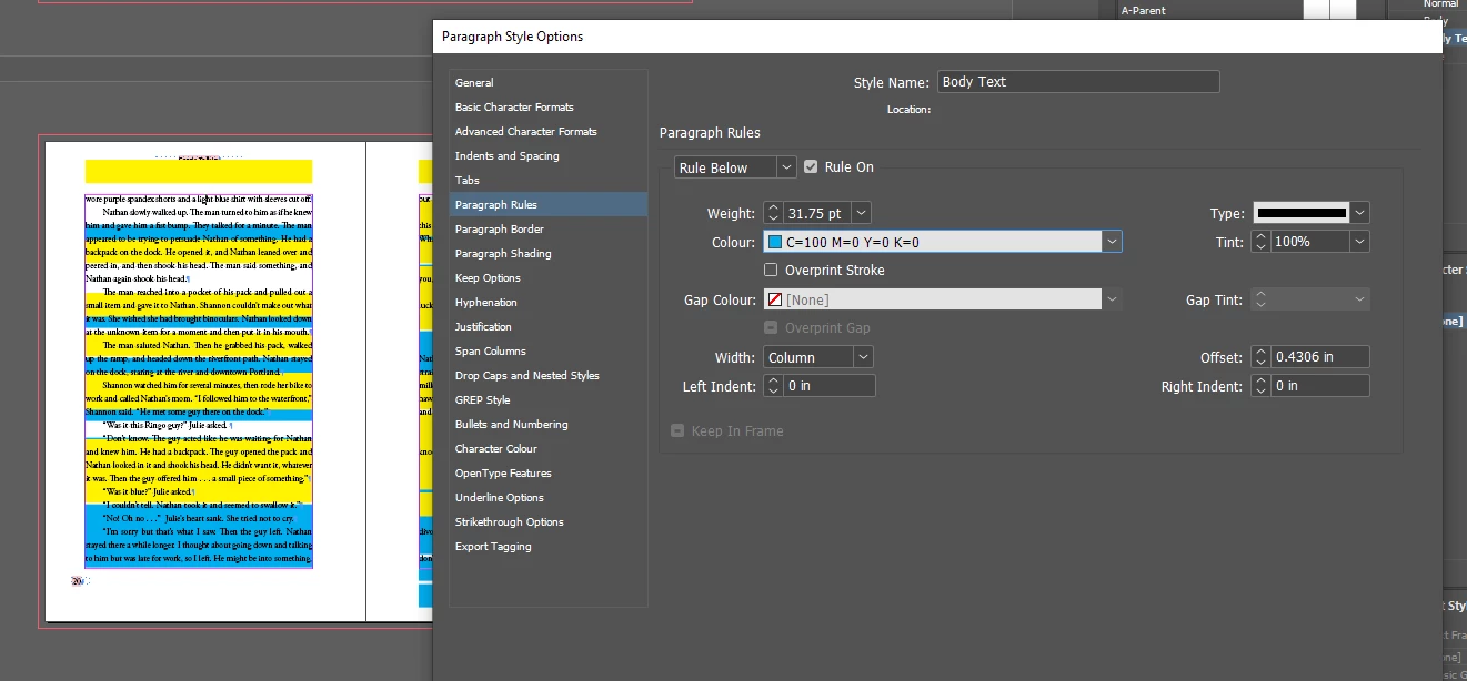

To show it better - I've changed them from White to Yellow - above, and Cyan - below:

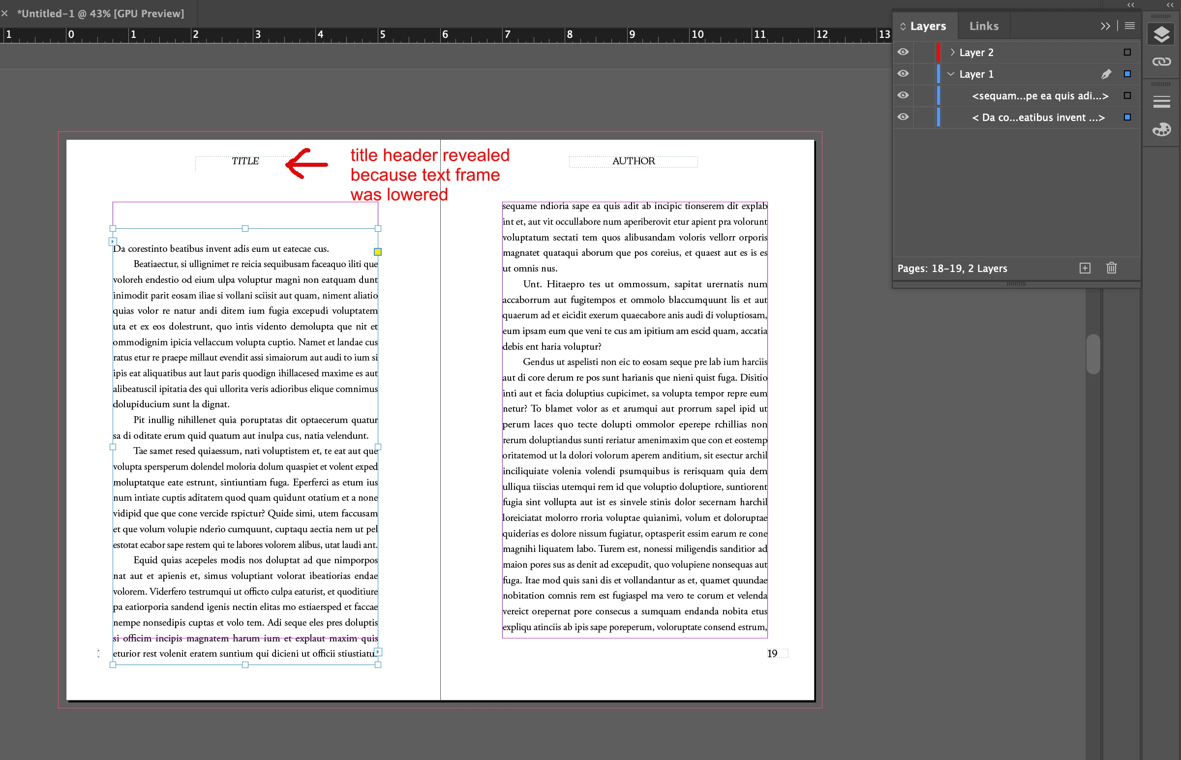

May 15, 2025 1:02 AM UTC
Thanks so much everyone for your responses. Sincere apologies for my slow followup. My heavy schedule has prevented a faster reply.
For the project that inspired this query, I found a temporary workaround which involved reordering the layers on a page, placing the layer with the parent page on top. (Thank you Willi for suggesting I look at the layers.) Now I'm on a new project and that solution doesn't seem to work anymore.

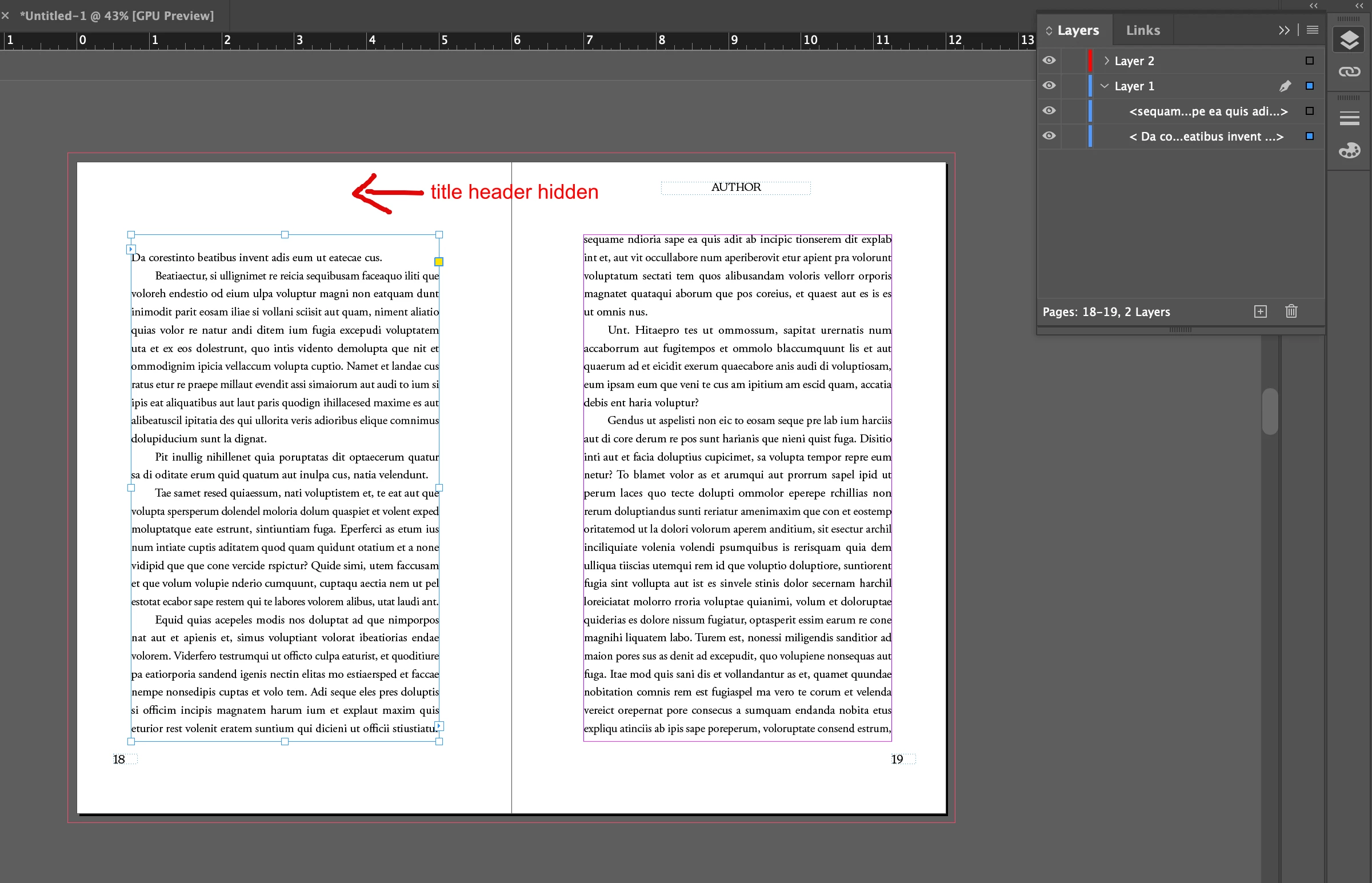

I created a mockup with three images so you can see what I'm dealing with. As best I can tell, it's as if there's an invisible border (about one-inch thick) around the text frame that blocks out anything below it. This border only appears on certain text frames, I have no idea why. (Some spreads work just fine.)
In the attached photos, the right-hand page is as I want it (text frame, author header, page number footer). The header and footer are on the A-parent.
The issue is with the lefthand page.
  • In image 1, the title header is obscured by the text frame's invisible border.
  • In image 2, the title header is revealed because the text frame was lowered (but note that this obscures the number footer).

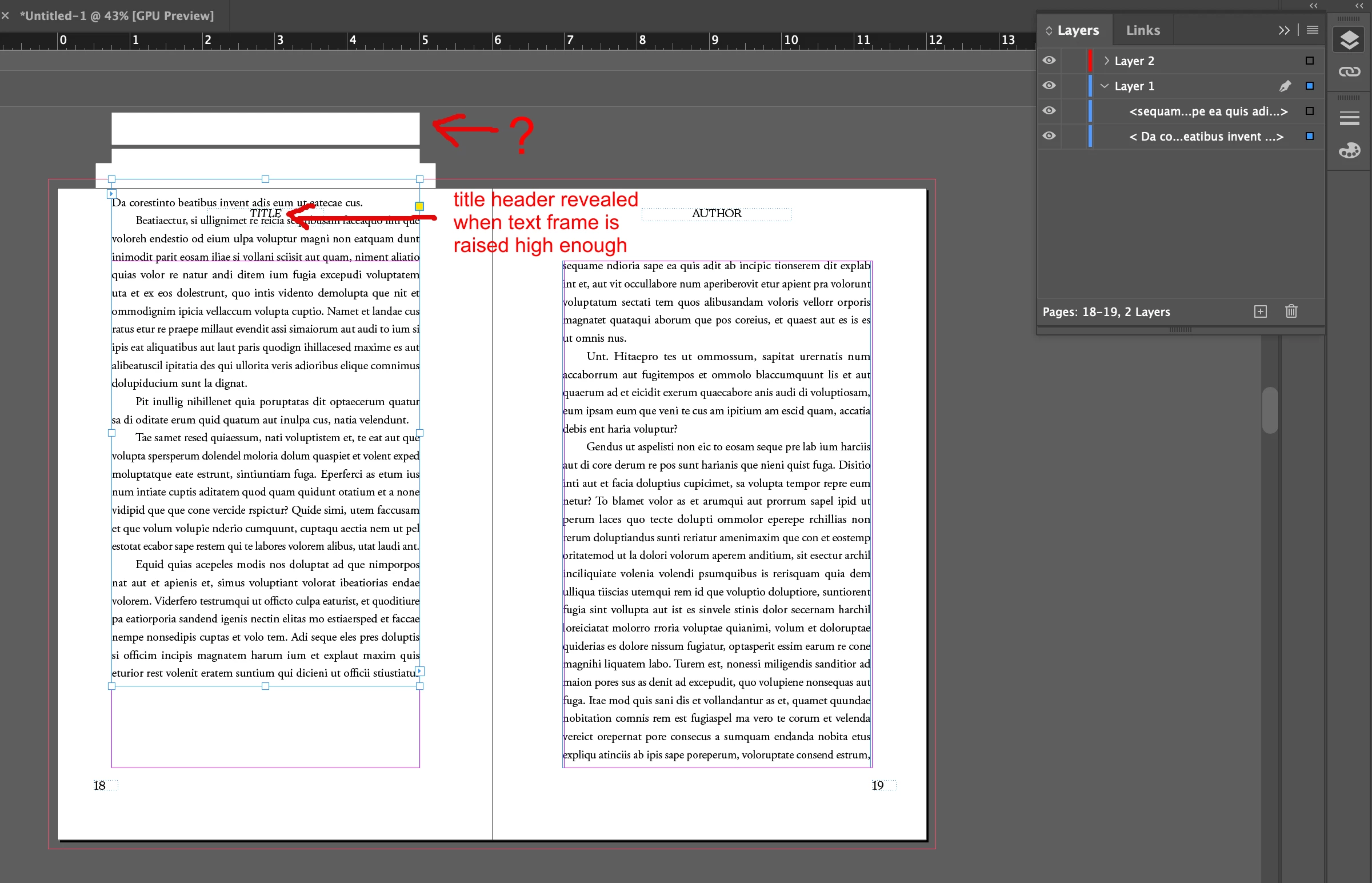

  • In image 3, the title header shows through the body text because the text frame has been raised quite high. (Apparently only the invisible border blocks the content underneath.)
Does anyone have any idea what the heck is going on here? As I said in the original post, I've been using InDesign for years and never had this problem until the most recent update.
Thanks so much!
