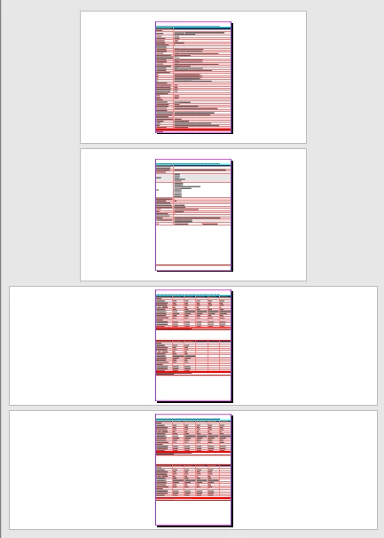

My pasteboard settings are:
As far as I know, these are global. They might be local, but I have 4 very similar documents open of which three look the same regarding the pasteboard, but one doesn't. However, the pasteboard settings of that one are the same as with the others. So how does this come?
Pages 1 and 2 have a top/bottom margin of more than 10 mm, while pages 3 and 4 have 10 mm, but are wider. According to my settings, pages 3 and 4 look correct. I checked other settings like "Document setup" or "Margins & Layout", but there is nothing related to the pasteboard. Only in the prefs.
I also thought about Indesign perhaps enlarging the pasteboard automatically when you place objects there, but I never saw that actually happen.
Does someone know a way to align the pasteboards?

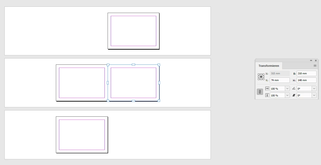

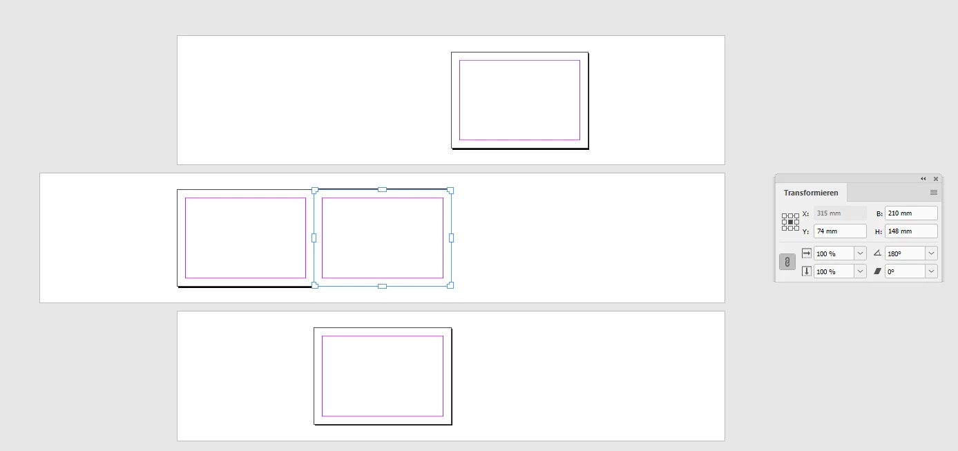

@Doc Maik said: "…Also, this is about the pasteboard, not the page. I don't see the relation."
You'd be surprised.
Page is selected with the Page tool:
Selected page is rotated to 180° with the Transform panel:
Uwe Laubender
( Adobe Community Professional )
Doc MaikAuthor
July 21, 2022
Yes, that's the auto-stretch of the PB. But if you don't transform or you do rotate 90° and then back, the PB should adapt.

You cannot align different pasteboards directly, because you cannot select the pasteboards and use the Align panel to align your selection. What you can try is to select all pages with the Page tool and use the Align panel to align the selected pages. To select all pages, switch to the Page tool and do the keyboard shortcut for Select All.
But this Align panel trick will not work in your case, I think.
Your screenshot is already showing all pages aligned.

Doc MaikAuthor
July 21, 2022
to align = angleichen
[1] Didn't change anything yet.
[2] Don't know how untransform a page. But it was never transformed. Also, this is about the pasteboard, not the page. I don't see the relation.
[3] Sounds logical to me. Thanks.
By the way, I now saw it for the first time  that Indesign would extend the width when placing a guide on the PB. Removing that line would resize the PB again. I checked something else I didn't mention before: the master page. It has the size of 1 & 2.
