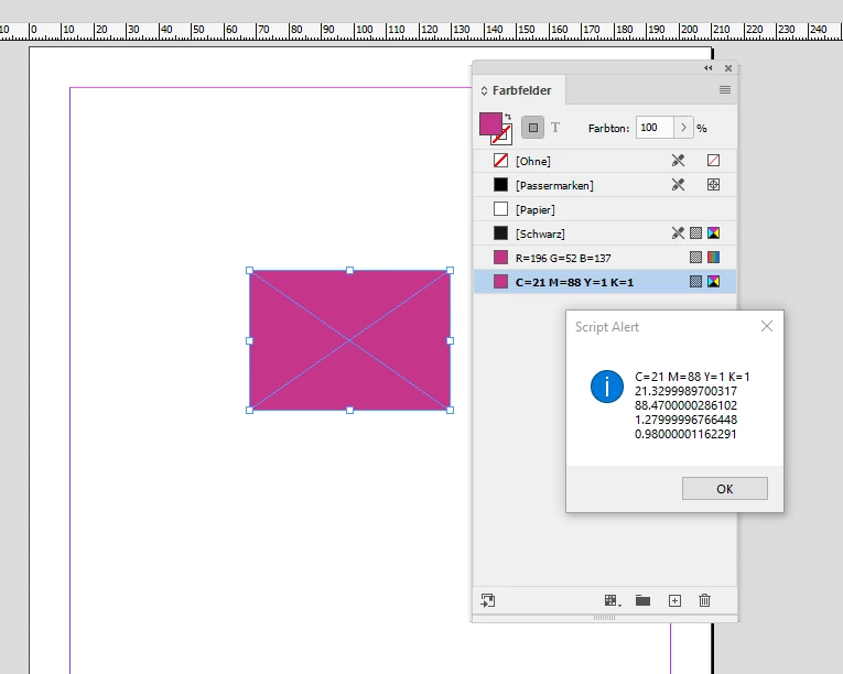

Or others as well. Even if you see the same value in the user interface there could be different values internally because of the rounding. If you want to see exact values you could fill a rectangle with a process color and run a script like this:
var fillColor = app.selection[0].fillColor;
var fillColorName = fillColor.name;
alert
fillColorName +"\r"+
fillColor.colorValue.join("\r")

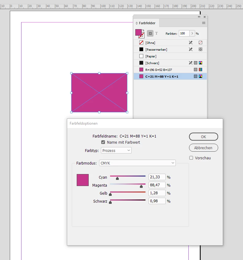

One example where I converted an RGB color to CMYK.
Compare its name to the values that are showing up in the GUI:
And to the internal exact color values:
