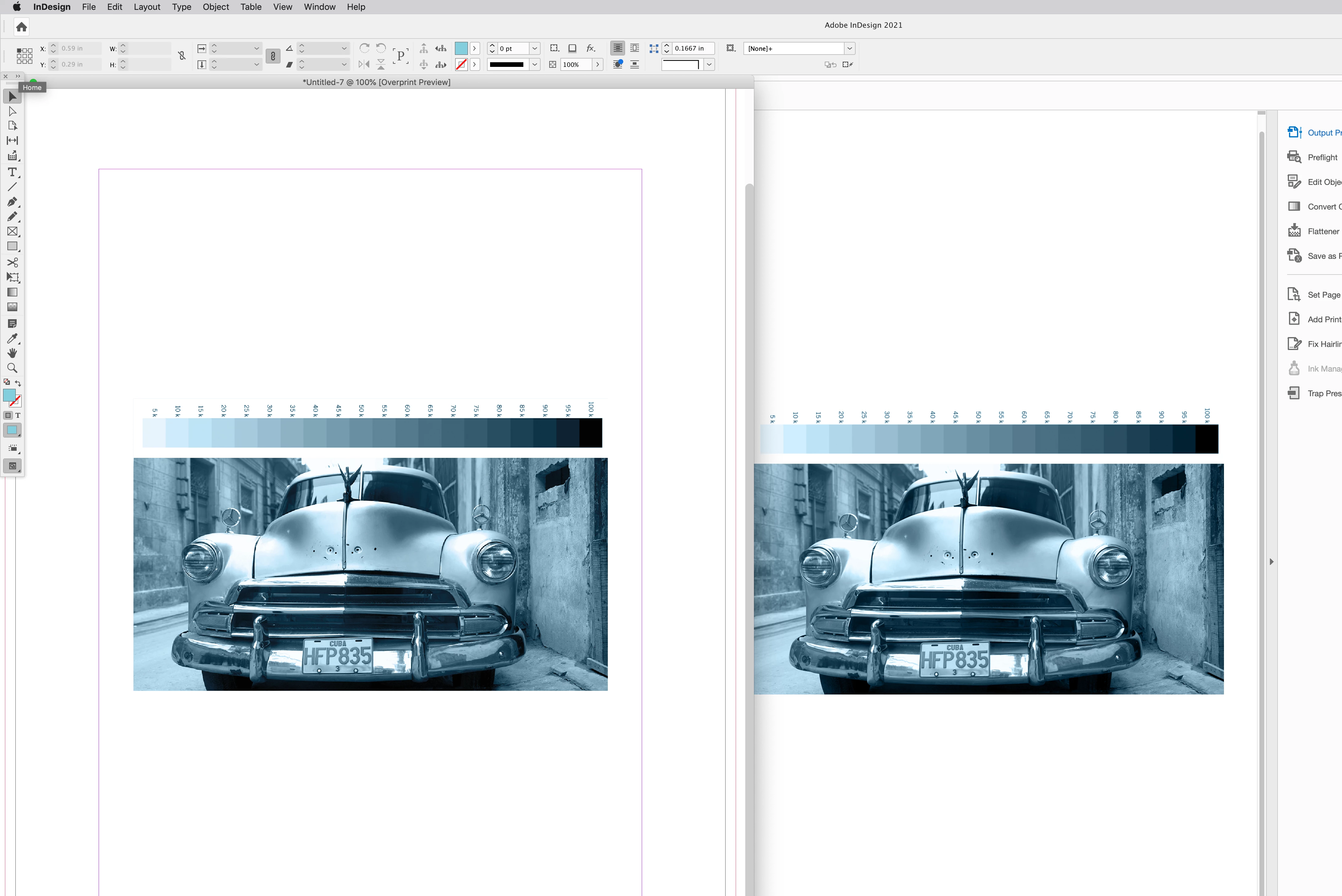

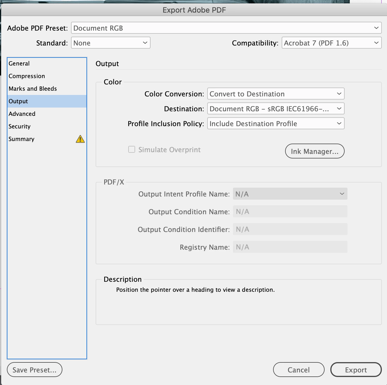

Hi @23121922udmu , What is the InDesign document’s Transparency Blend Space set to? If you export to an sRGB Destination with live transparency the PDF’s blend space would affect the color. Here my InDesign Transparency Blend Space is set to RGB, and I’ve set my Export>Output tab to this:
The exported PDF matches because the exported transparency is live (Acrobat 7), and both the InDesign and PDF docs are displayed using the RGB blend space:
If the InDesign doc’s blend space is CMYK, I don’t get a match because the Luminosity Blend Mode effect produces different color with a CMYK blend space—the export to the sRGB destination includes an RGB blend space when transparency is live:
