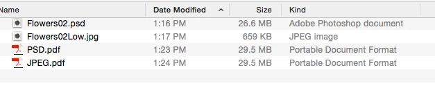

    Here's an example that shows how InDesign doesn't use the jpeg's starting compression. The top two items are the same image saved as a PSD at 26.6 MB and a low quality JPEG at 659K. Exporting them to PDF/X-4 with compression and resampling turned off results in the same 29.5 MB file size—the JPEG's original compression has no effect on the export:

    Right because the 4 quality compression would rearrange the pixels creating compression blocks and would no longer have the detail that an uncompressed or 12 quality compression would have. You would get some additional compression the second time around because of the repeating pixel blocks caused by the first compression. The quality 4 image and the quality 12 image don't have the same pixel structure and are two different images. It's just not worth doing the double compression.
    The reason I exported with no compression in my example was to show that InDesign doesn't pass the placed JPEG's compression benefit on to the PDF.
