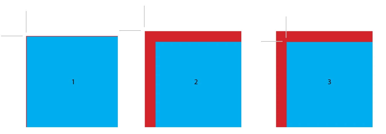

    The images that tman69 shows of the settings are basically what I'm doing minus checking the crop marks.  Just as I indicated in my first post.  This is what's giving me the undesireable effects. Purhaps you are like me and need to see an image of things to better understand what someone is trying to say.  Bellow you will find 3 options.  1 is based on one setting I've mentioned when it corps the red area (bleed area) then places the bleed marks on white space.  2 is based on another setting (see tman69 settings on the forum link you provided) where indesign ignores my background image adds .125 inches extra bleed then places the bleed marks on the white area.  3 is what I usually set up in Acrobat after exporting from inDesign and is what I'm trying to get done in inDesgin alone.  In 2 and 3 you will see the edges of the background image which is in red and will be cut off in the final cut because the red area is in the bleed.  The blue is the actual document size.  Does this help illustrate what I'm trying to do?
    Did you read my comments in the other thread carefully? BLEED marks are useless to you. They align with the outer limit of the bleed, NOT where the page needs to be trimmed. You want CROP marks to show where the cut should be. A bleed mark without a crop mark doesn't provide the cutter operator with any visual clue as to how wide the bleed margin really is and where his cuts should belong, and it's almost a certainty that the work will be trimmed to the outside of the bleed using the only marks you've supplied.
    Crop marks align with the page edge, where the bleed allowance starts. Since the purpose of bleed is to allow for the posibility of shift in the printing or on the cutter that results in a cut not falling exactly on the mark, some portion of the bleed allowance may wind up on the page (and a corresponding amount of the real page area may be cut off the opposite edge). In order to prevent any marks from accidentally showing, crop marks should be offest at least as much as the bleed allowance so they are outside any area that might get used, and as such they will be in a white border area added to the page size outside the bleed box. your illustration # 3 has the correct mark alignment realtive to the page edge, but they need to be moved away from the page edge (inicrease the offset) so they are outside the bleed area. They will get further apart as they move away from the corner, and if you were to take a pencil and extend them, the bleed corner of the bleed would make a nice little square where they intersect.

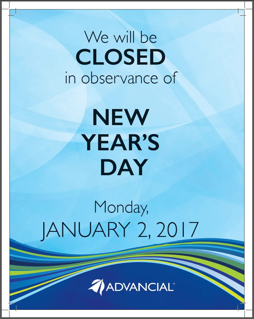

    I am getting the same thing, white space around the edges for no reason with an extra set of crop marks. I do not want the white border and extra crop marks. How do I get rid of it without having to crop each of the 20 pages in the document? See screen capture.
    rob day
    December 5, 2016
    The extra marks are Bleed marks. Make sure you only have Crop marks checked when you export. Also your bleed amount would have to be large enough to clear the mark offset and its dimension. The default marks are .2" plus  .1" for the offset, so you would need a .3" bleed with no bleed marks to prevent any white area outside of the bleed.
    s.mccrory
    December 5, 2016
    Oh, ok, I see what you are saying. Thank you for clarifying!
