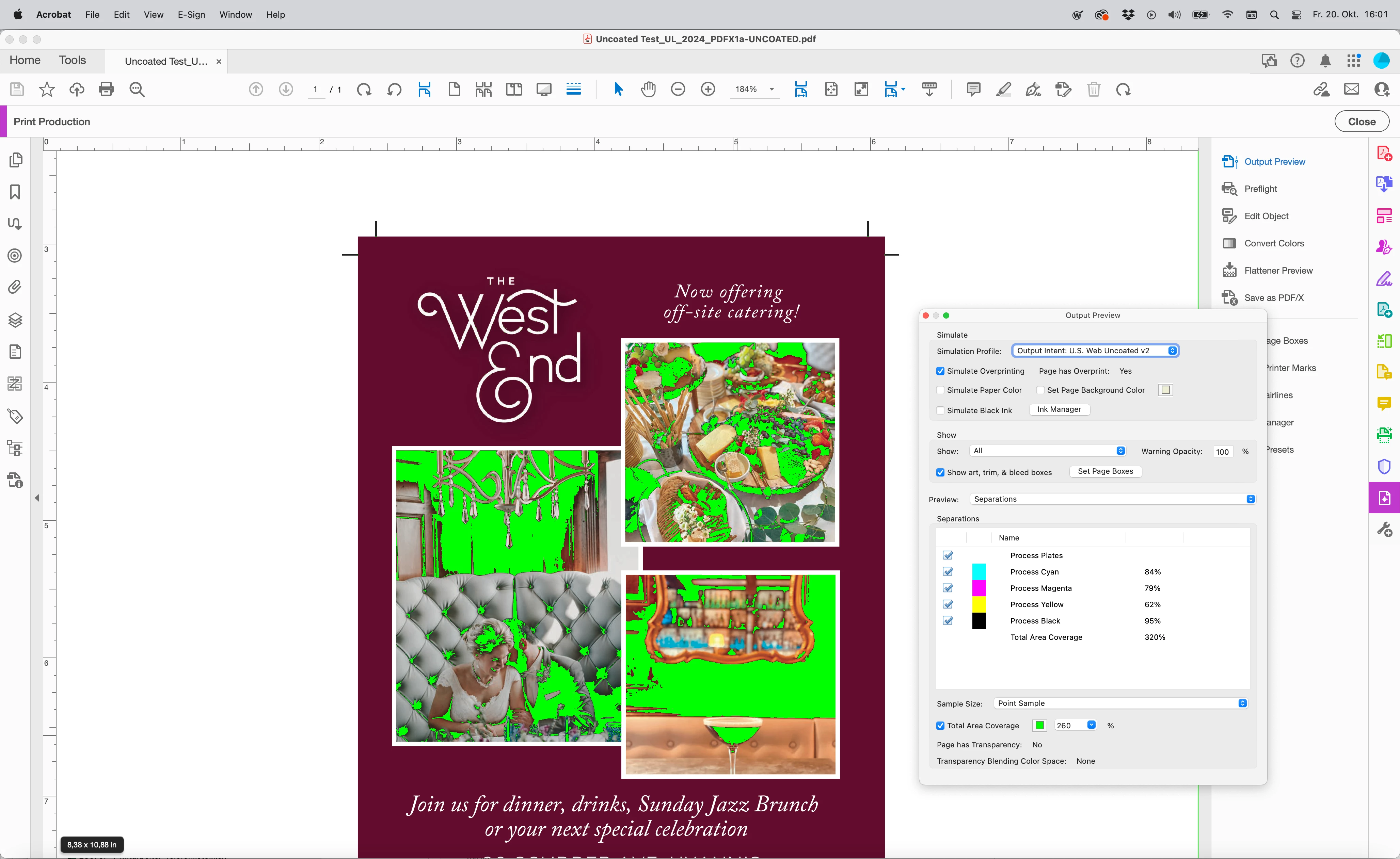

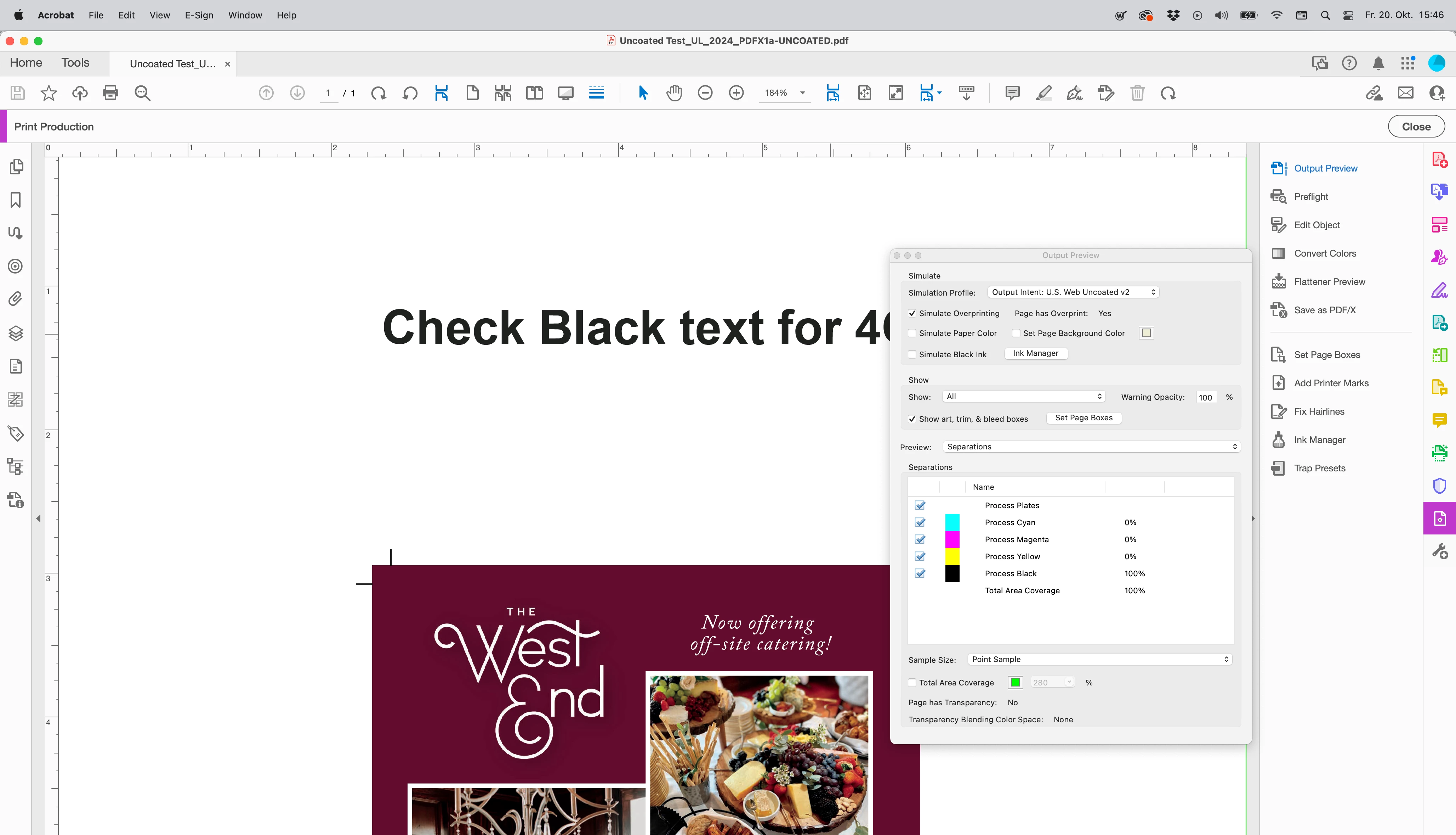

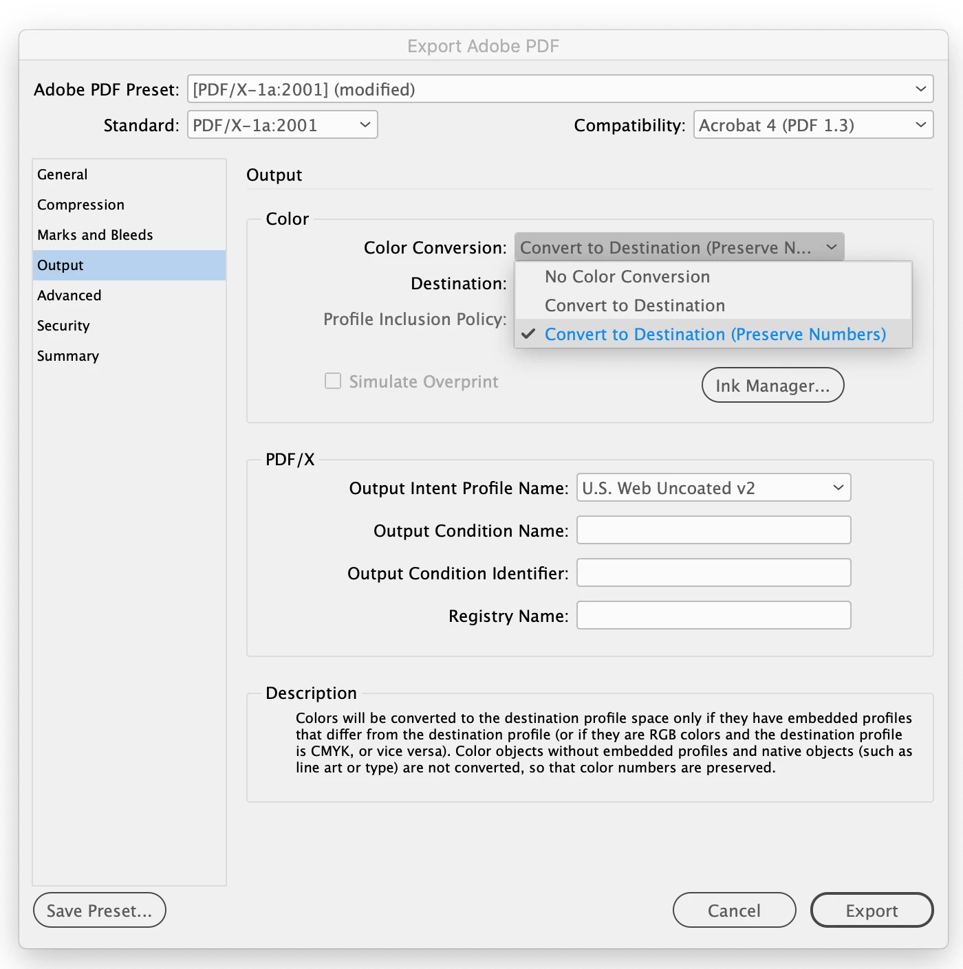

October 20, 2023
@rob day said: "Sounds like a bug, but I’m surprised it hasn’t come up yet. Maybe someone with the latest version can check— Uwe @Laubender ?"
Hi Rob,
tested with @robink40059613 's IDML document and my German InDesign 2024 version 19.0.0.151.
Exported to PDF/X-1a and used U.S. Web Uncoated v2 as output intent.
Color Conversion was set to: Convert to Destination (Preserve Numbers).
The black text stayed as 100% K only. Screenshot from Acrobat Pro:
The image contents is still way above 260% total of ink:
Opened the placed PDF in Acrobat Pro. The images in the PDF are in Device CMYK.
The output intent of the placed PDF is ISO Web Coated. PDF producer is Canva.
I would not expect that InDesign is converting the images' color of the placed PDF when exporting to PDF because they are in Device CMYK.
I attached the exported PDF to this reply.
Will test other versions of InDesign as well later; 2022 and 2023.
Currently I'm on macOS 12.6.8 with a MacBook Pro from 2021 and a M1 chip.
Uwe Laubender
( Adobe Community Expert )
rob day
October 20, 2023
Hi Uwe, thanks for testing.
I’m seeing the same for all with CC2021. I was only checking the InDesign [Black] text, but I agree, the placed PDF passes a PDF/X-1a preflight, so all of its color has to be Device CMYK. Even if there is a bug and it gets fixed, the attempt to convert the placed PDF to a different CMYK space and protect the native [Black] via InDesign isn’t going to work.
Also, looks like the test PDF @robink40059613 provided, Uncoated Test.pdf has had all of its color converted—the black point in the images is less than 260%. It’s the result you would get if the Color Conversion setting was set to Convert to Destination with a Destination profile that conflicts with the document profile—in that case we would expect the Black to convert to 4-color

If you are Exporting to a Destination that conflicts with the document’s assigned CMYK profile and set the Output Color Conversion to Convert to Destination, CMYK black only would have to be converted to 4-color. If you choose Convert to Destination (Preserve Numbers) the native InDesign colors and swatches would be protected, but placed RGB images and CMYK images with conflicting embedded profiles would convert to the uncoated profile with the 260% total ink.
If there are placed CMYK images or objects with no embedded profile, but have a total ink that exceeds 260% those images would export unchanged.
