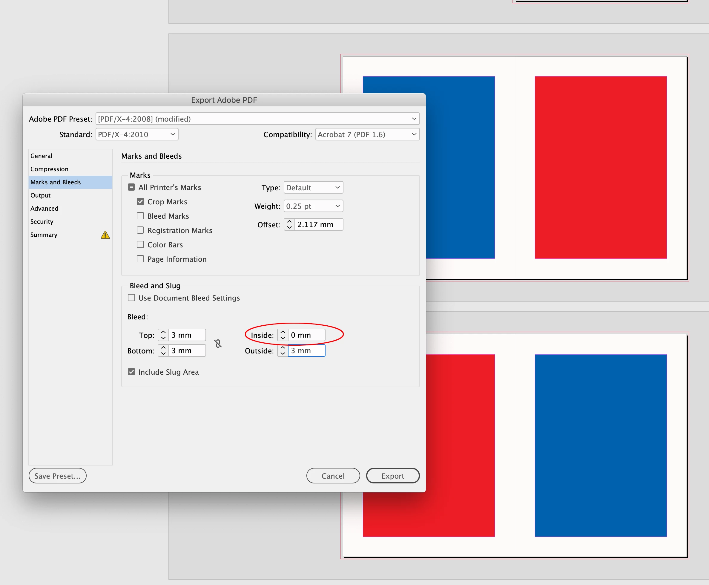

Hi @BO_mita ,  Just to clarify, you have Marks and Bleeds set like this:
And yo don’t get this?:
