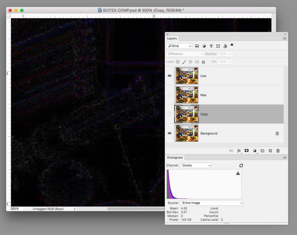

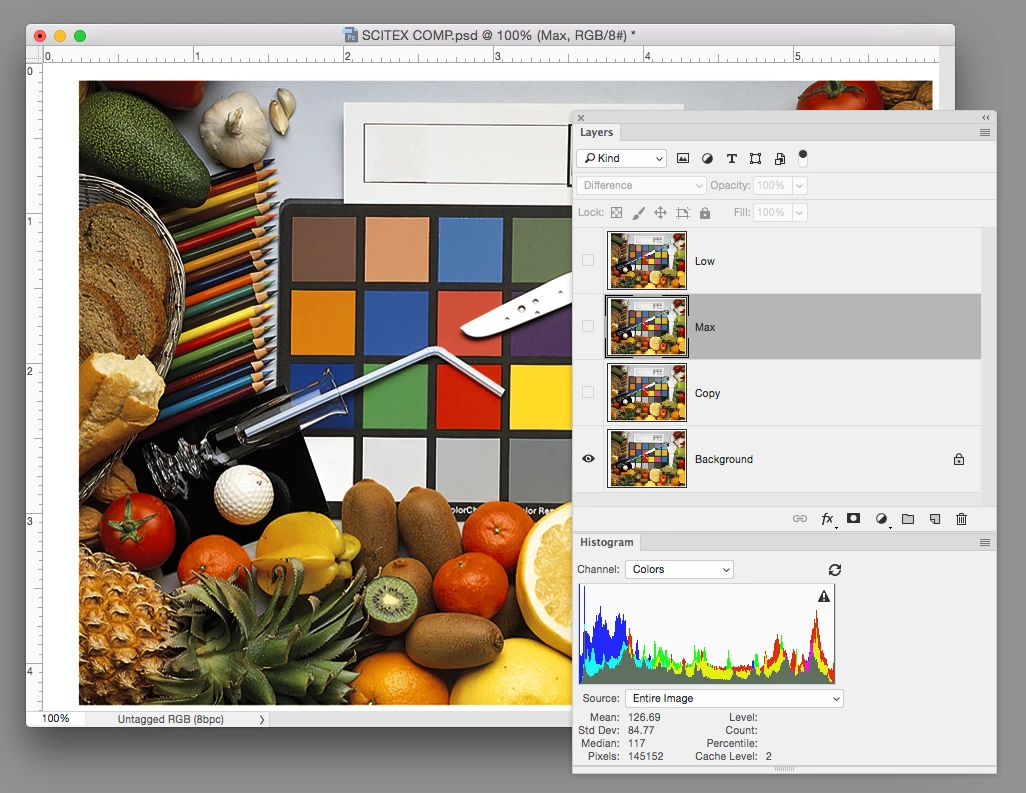

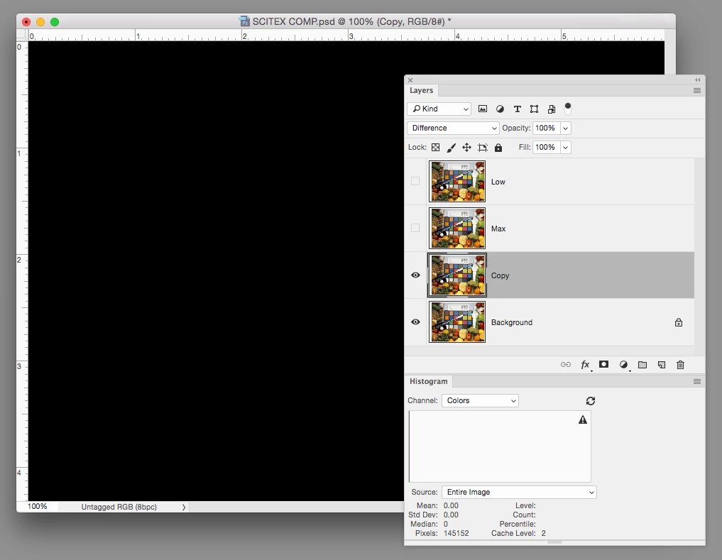

    I do realize that JPG compression can cause some severe hits in image quality, but will anyone ever notice the difference once it's in print, like when it's at Maximum quality?
    You can use Photoshop's Difference blending mode to tell you exactly what the effect of compression is on an image and the Max quality is far from severe and it is doubtful that any offset press is capable of printing the change in pixel structure.
    So if you duplicate an image to a new layer and set the mode to Difference the histogram shows that there's no deviation in the pixel because the layers are identical.
    If I save out the image as a low quality JPEG, reopen and add it as a layer, there's a significant 5% deviation and the artifacts are visible and printable:
    With maximum quality there are no visible artifacts and the deviation is less than a half a percent. The visual noise from a typical halftone screen would certainly hide any compression artifact when the quality is maximum.

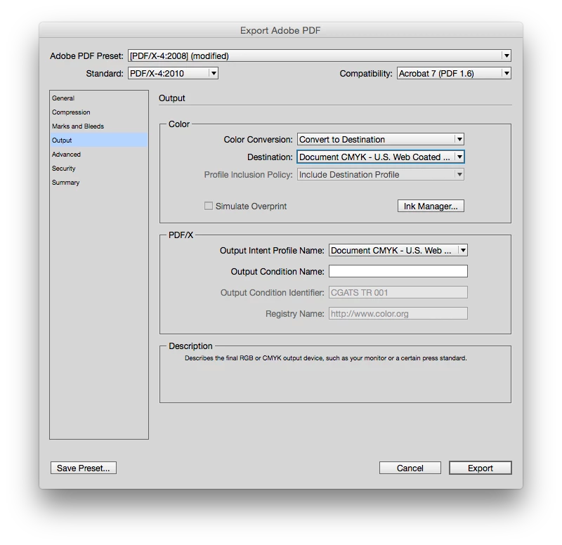

    One thing I did like about using PDF/X-1 is that it auto-converted RGB objects to CMYK, which is ideal since a lot of our ad clients don't even bother converting
    There's no reason why you cant do that with the PDF/X-4 standard even when a printer is requesting all CMYK. This would convert all RGB and CMYK with conflicting profiles into the document's assigned CMYK profile and maintain the X-4 standard. If there were no transparency in the document it would produce the same result as X-1a
    The downside of this approach is you have to know the press profile before you make the conversion on export.
