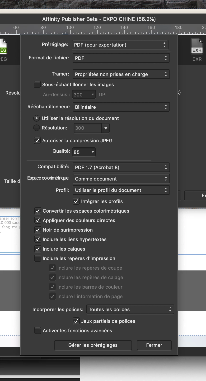

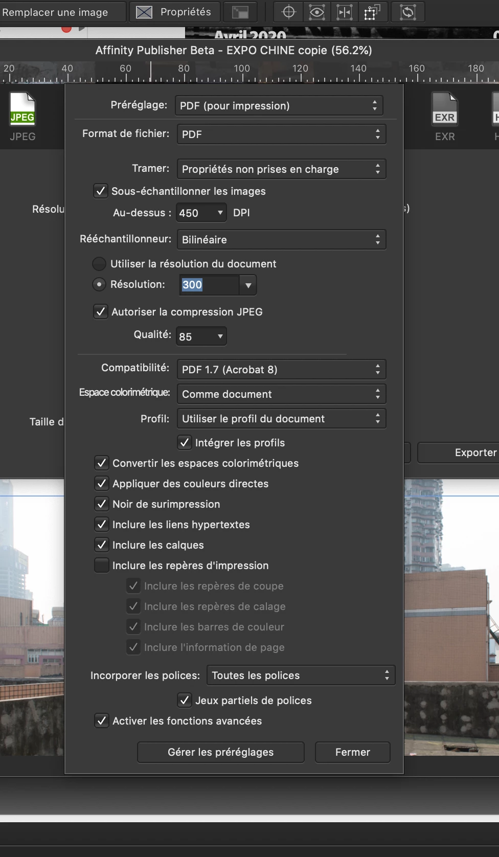

Can you show a capture of your Export >Compression tab?
Julien H.Author
April 20, 2020
Here it is but... in french...
Julien H.Author
April 20, 2020
