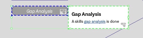

Hello, this has become a head scratcher for me, I'm hoping someone knows the answer!
I have an interactive PDF document in InDesign with buttons and pop-ups. These pop-ups are hidden till triggered, and appear when the cursor is rolled on/off the corresponding button.
I have the pop-up boxes butted right up to the buttons (it doesn't work if they are separated) so the user can then slide the cursor over to the pop-up, which is set to stay active until the user rolls off OR clicks (some pop-ups are hyperlinked)
This is all hunky dory in the Indesign Viewer, but when I export and view in Acrobat the pop-ups dissapear upon button roll off, and it's impossible to roll onto the pop-up to click the hyperlink.
Does anyone have a clue what I'm doing wrong?
I know InDesign isn't the best for creating interactive PDF's but I'm not sure what other Adobe product would work better?

Ahh I see. Your pop-up is fixed and closeable. Mine are rollover. I've set the button to reveal the pop up when 'rolled over' and dissapear when 'rolled off'.... then the hyperlinked pop-up 'hidden till triggered' and revealed when 'rolled over', dissapear when 'rolled off', then the whole box is hyperlinked when 'clicked'.... Does that make sense!?
