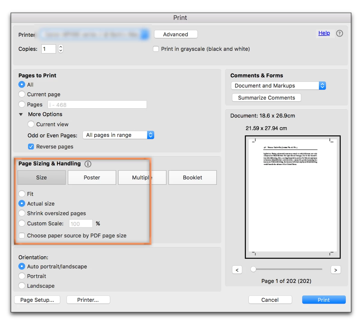

I have a 42 page document intended to be used to make 8.5" x 5.5" booklets, which has worked fine on my home printers. I need to send this file, page by page, to a printing firm who have asked for the pages in a pdf file. When I output the pdf, with printer marks, the scale nearly fills the letter size, less some space needed for the printer's marks. The bleeds are trimmed, so the file is worthless, even if the printer could change the scale.
I am using InDesign 12.0.0.81 on a Mac.
When I output a ps file, the scale and bleeds are correct, but it outputs only one file at a time, which I can only open in Illustrator.
The document set-up says that the page is half-letter. It seems impossible to get InDesign to output this correctly. What am I doing wrong? Please?

You don't need Acrobat (the paid version). You can get the same printing from Adobe Acrobat Reader (the free downloadable version).

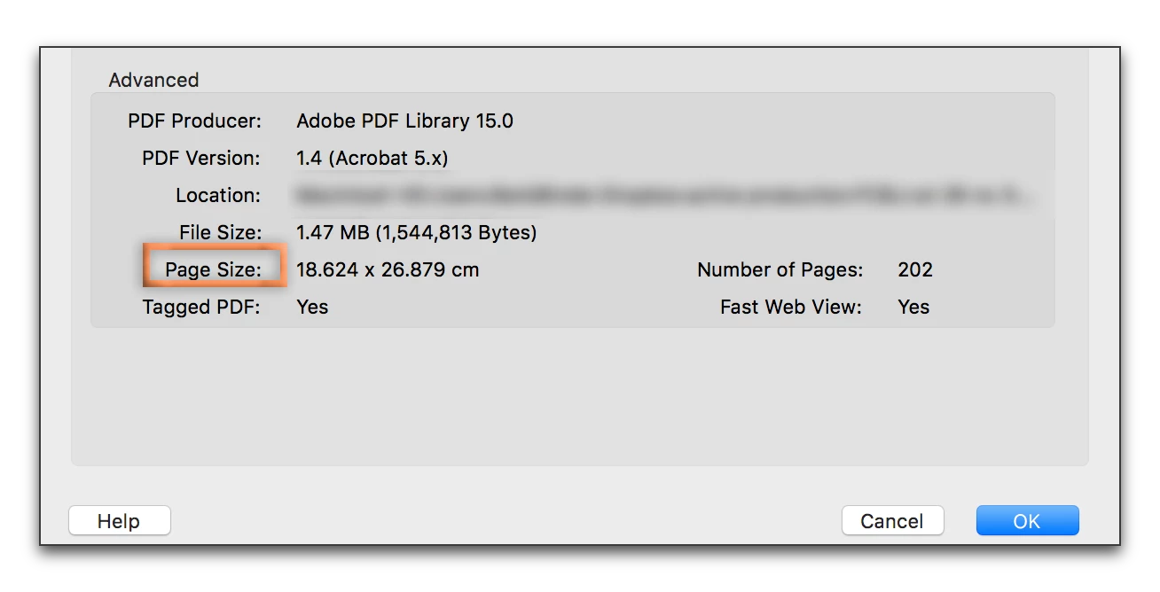

As per Steve ^^, Reader has the exact same settings in File > Print, and the same ability to see the document size in File > Properties > Description.
What is your document size as displayed in the Document Properties dialog box?

The document is "half letter" or 8.5 x 5.5. It prints exactly as I want if I first output a pdf, read it into Adobe Reader, then output it in "actual size." That should have been obvious to me...it wasn't.

Great! That print setting (Fit) in both applications trips up a lot of people! Glad it is now behind you.

Is this a result of printing test pages to see if there were exported correctly? Acrobat has a Fit setting in the print dialog box that will scale the contents up or down when you print. Choose Actual Size instead.
Better yet, go to File > Properties > Description to check the paper size. What does it say?
