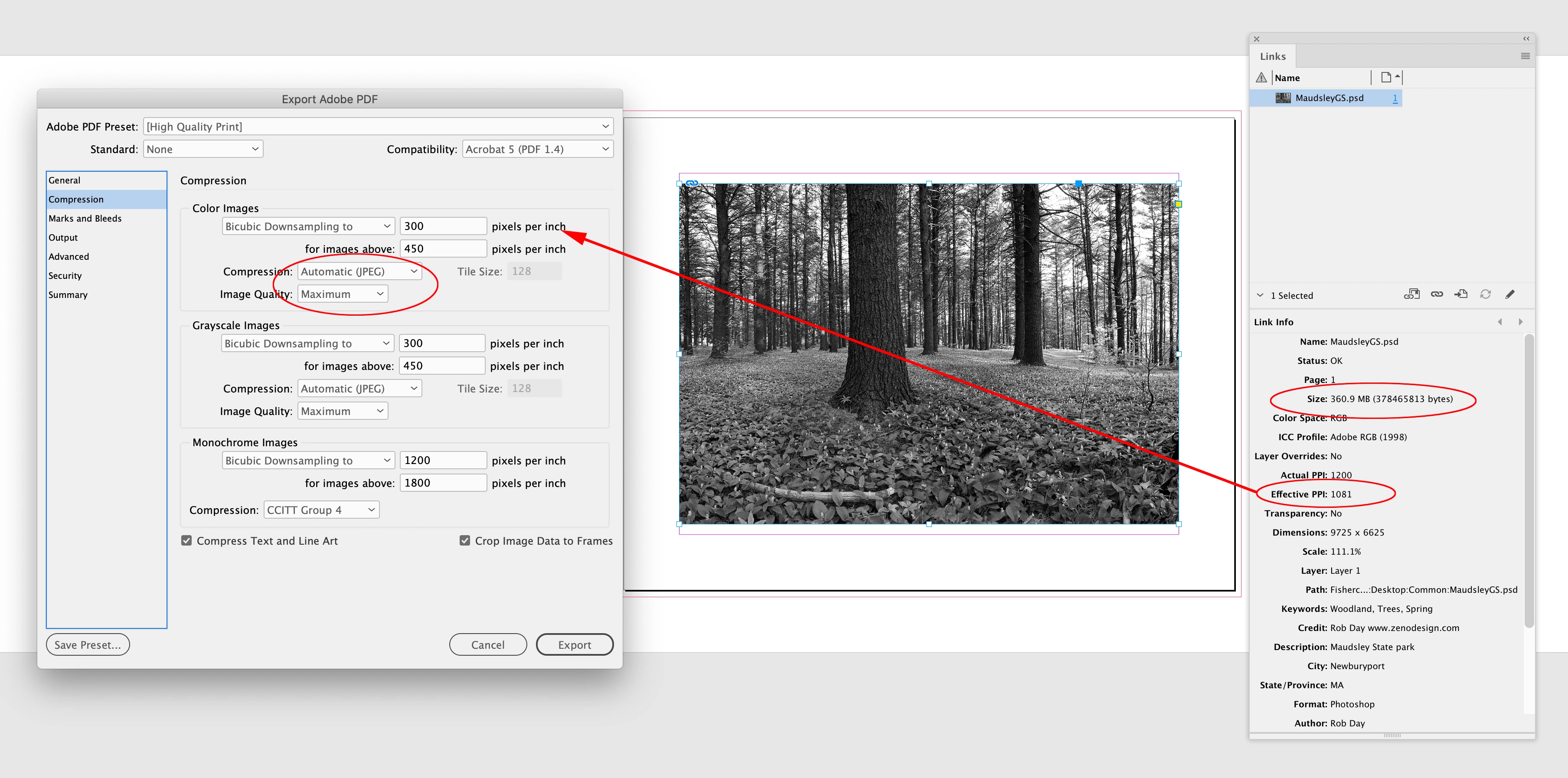

Hi @Vik Viik , Also, when you Export a PDF the image format is lost and a new flattened 8-bit image is exported to the specs you choose in the Compression tab. For example this placed .PSD has a file size of 360MB, but that includes its layers at the scaled Effective Resolution of 1,081ppi. The default Compression setting is to downsample any image with an Effective resolution greater than 450PPI and use Maximum JPEG compression, so the image is going to export flattened at 300PPI (not 1081PPI):

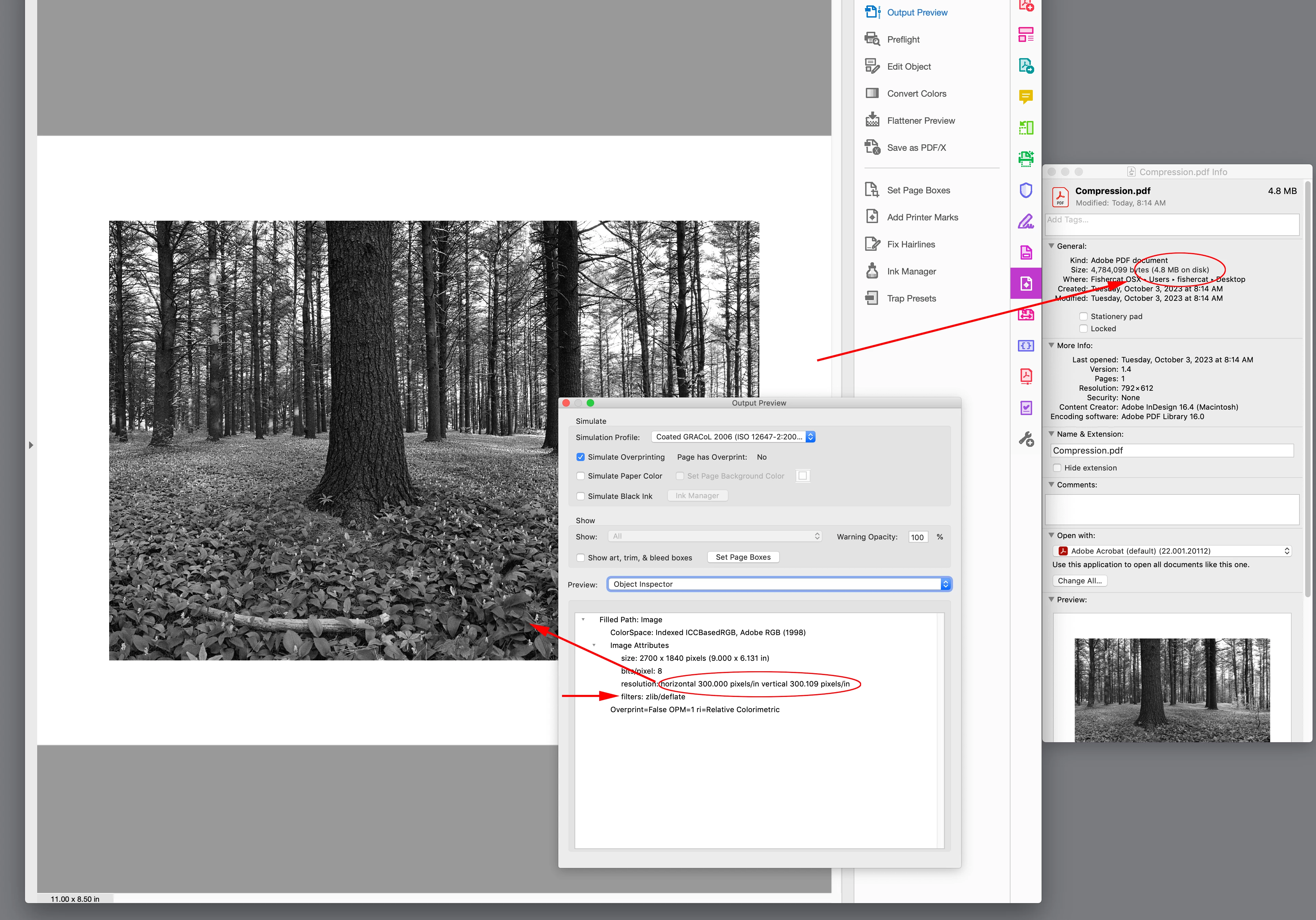

In Acrobat I can inspect the exported image and see it has indeed been downsampled to 300PPI, flattened, and JPEG compressed resulting in a 4.8MB PDF:

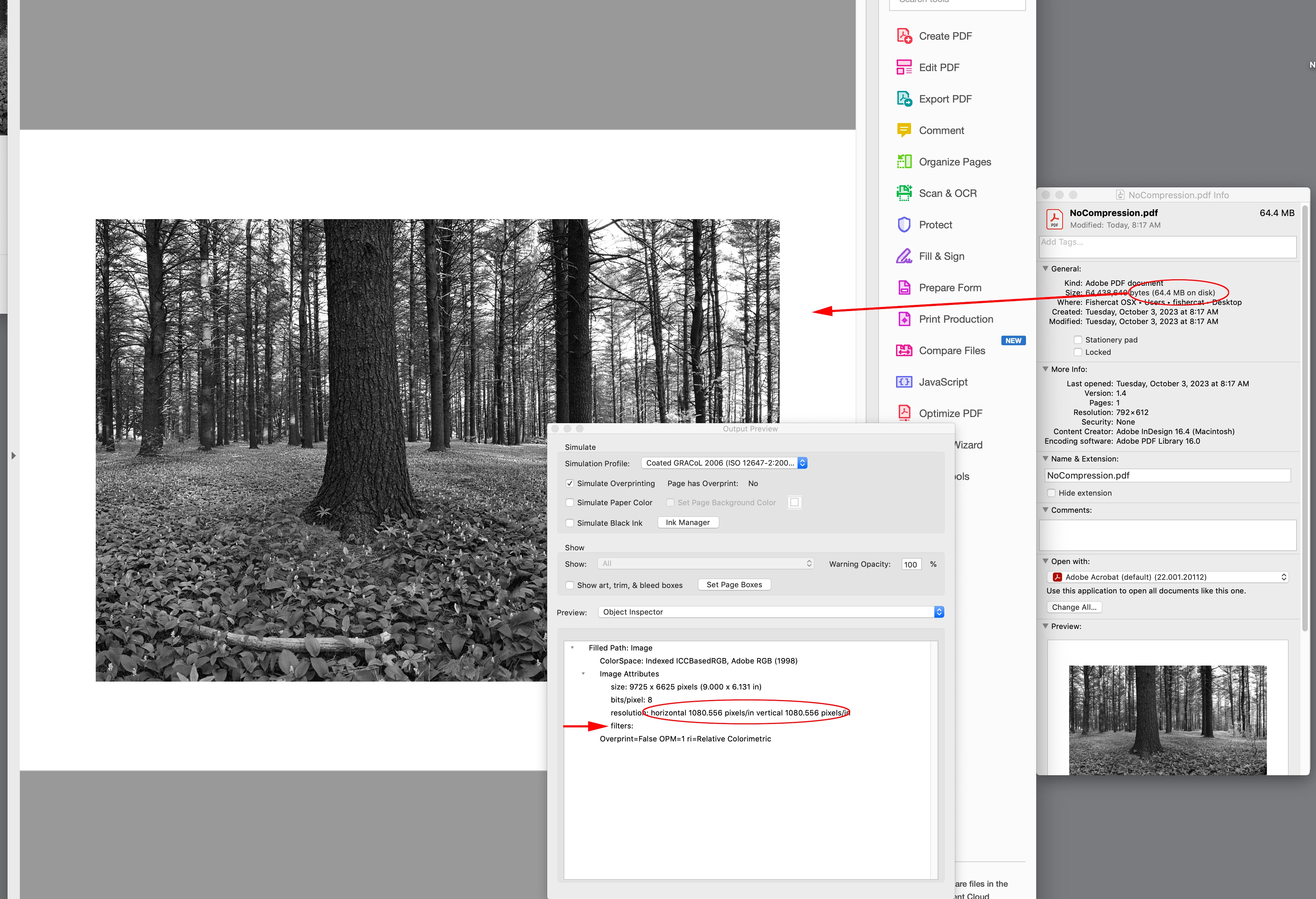

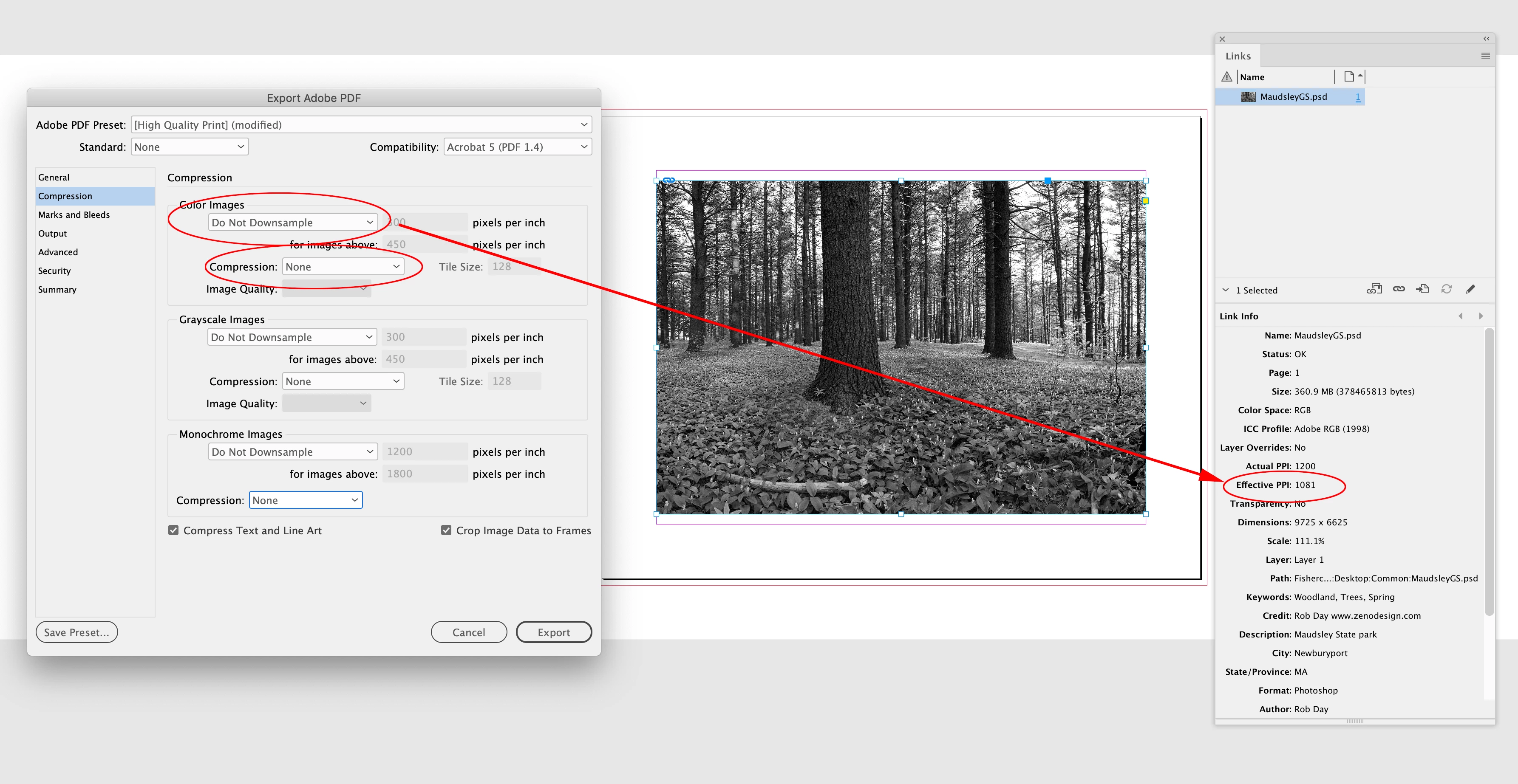

If I customize the Compression setting and turn off downsampling and Compression, the export is going to be to an 8-bit, flattened image at 1081PPI with no JPEG compression:
The flattened export with no compression or downsampling results in a 64MB PDF—the image resolution is listed as 1081PPI
