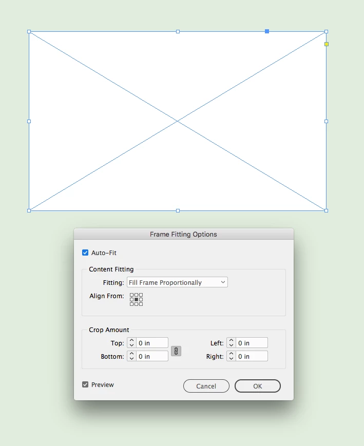

In addition to the good information above, you can save your InDesign file as a template (.indt) which will open as a new file, so you will not accidentally overwrite it.
Add rectangles for the image positions and go to Object> Content> Graphic, then right click and go to Fitting> Frame fitting options. This will help with sizing if you are placing repetitive images. Add your text boxes and set up your character & Paragraph styles.
