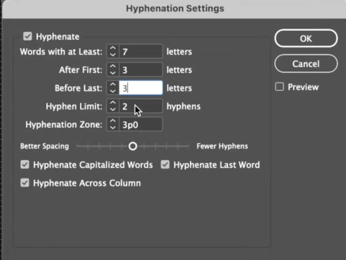

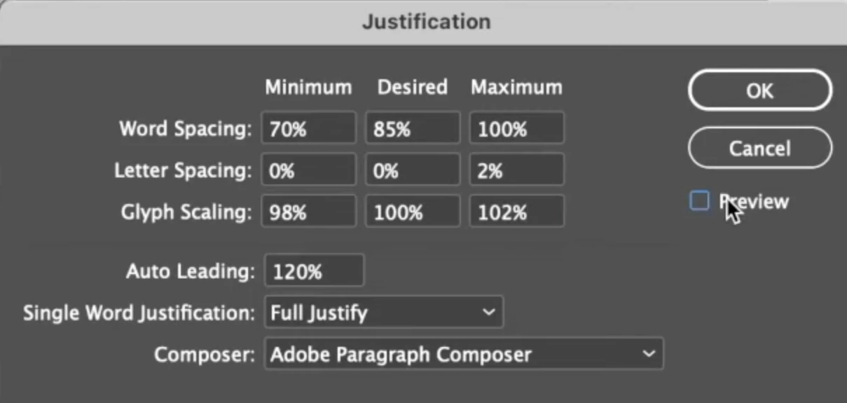

Just to give an example. You can find online a Tutorial from Charles Nix, the Creative Type Director from Monotype, where he does a very simple Video speficially on that. After I applied the settings, it just didn't look good in my eyes - too compressed and overall still too much Hyphenation on some pages. So I wonder, what is it that Top Book Publishers do, when preparing a Book for that.
Here are the settings he recommenend:

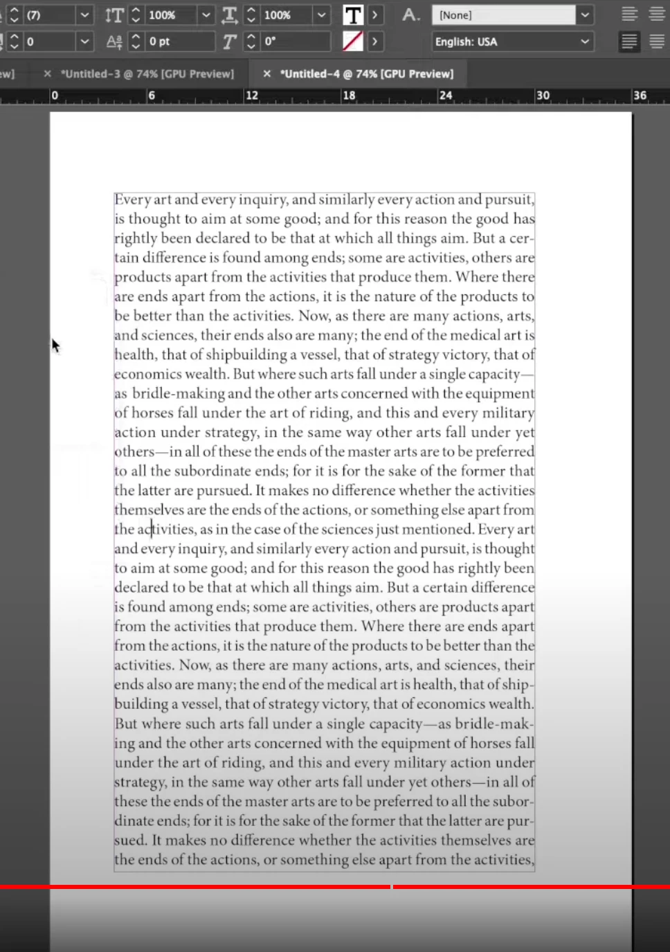

And here is the result of his text.
It looks definitely good yes. I count 5 Hyphens, which in my eyes should be the maximum on one page - but for some reason with my Document (Font: Adobe Garamond Pro / 11.5points) it is too compressed with that settings and still has on a lot of pages too much Hyphens.

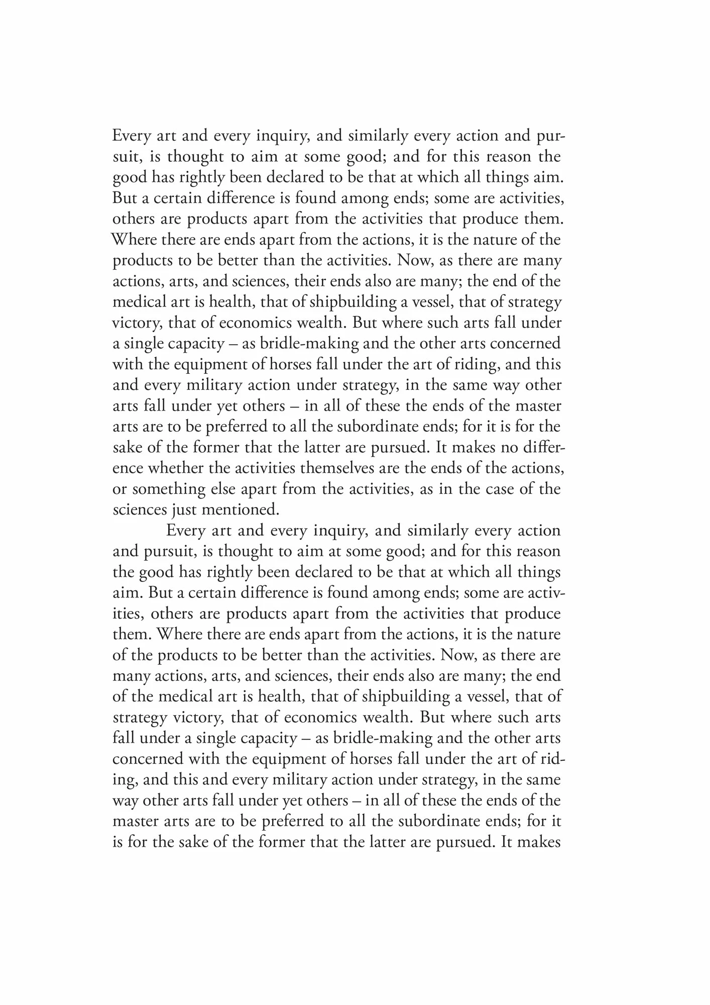

This is how my type of setting would look like 🙂
I doubled the original quoted text to be two paragraphs – to make it look somewhat more realistic.

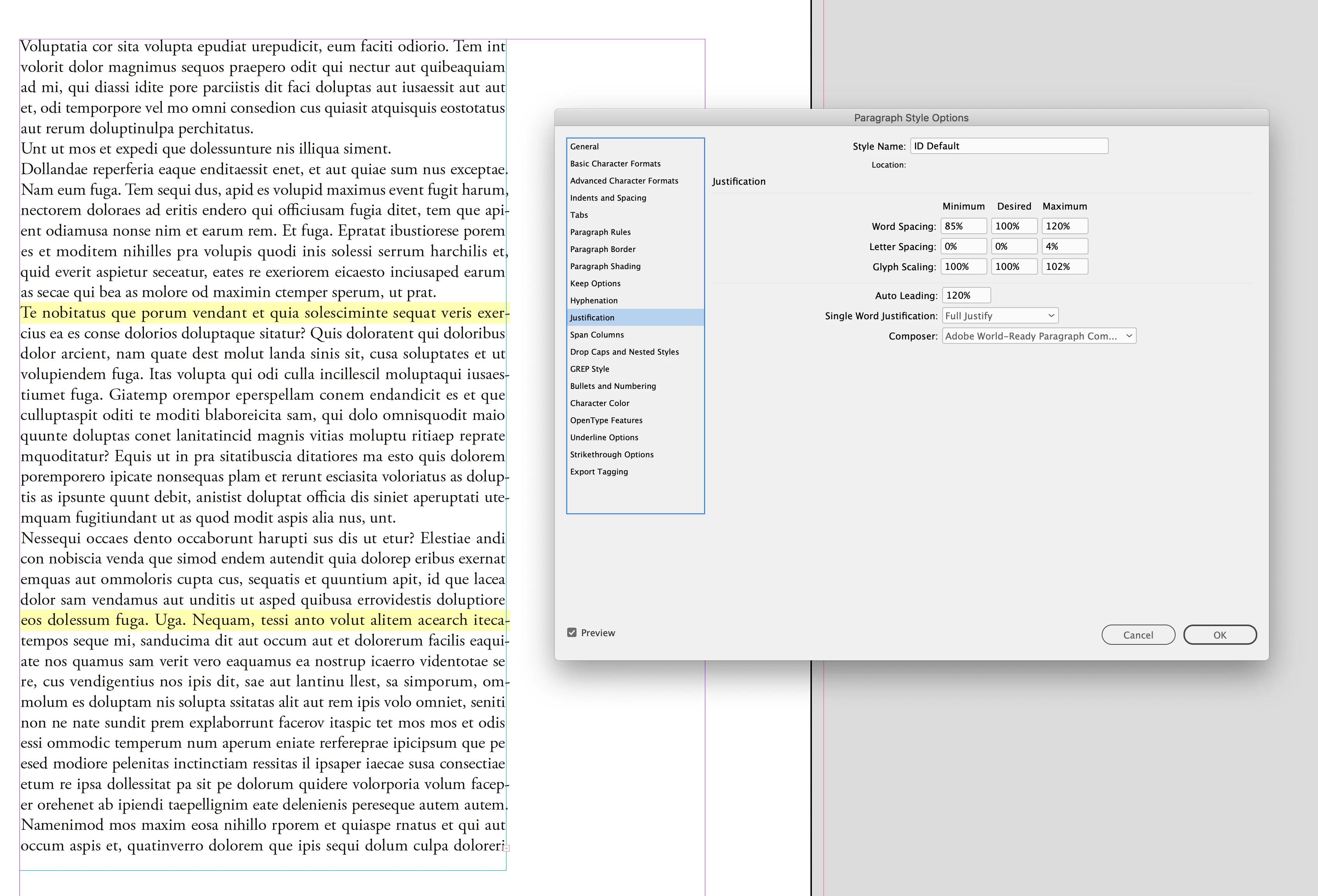

Hi @Yannic333 , Justifcation is a preference, so if you think the text is too tight just adjust your rules. You‘ve set a Desired Word Spacing of 85%, and the text has to set tight in order to follow your Desired setting. So this is going to loosen up the setting. If you turn on H&J Violations you can see the lines that can’t be set to your preference:
Yannic333Author

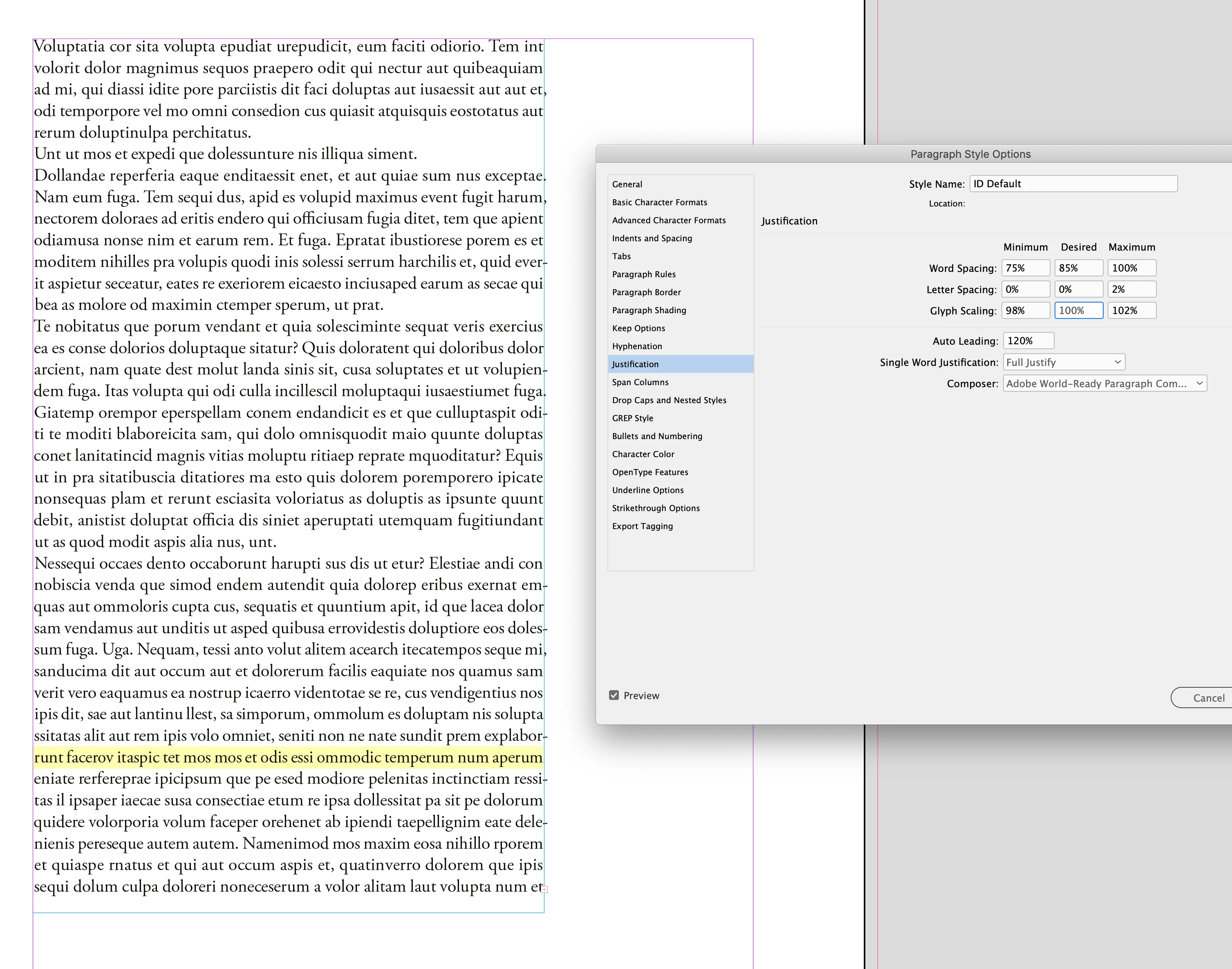

Apr 1, 2024 11:48 PM UTC
Hey Rob,
thank you very much for your reply!
Yes I understand what you describe and actually gave it "another go", after reading the replys in here - also partially with "Show H&J Violations" turned on - a great tool I must say!
As i mentioned above in my response to James, I consider my results as quite good for now but came to the conclusion that in order to reach the highest level possible, a professional should be hired, that knows his/her craft very well.
For now I am satisfied how it went. Again, really appreciate your response!
