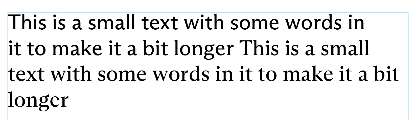

Hey there, I've been playing around with variable fonts and extend script and wrote a script that makes each character in a text block slowly go from sans to serif, I have attached the result as a screenshot. This works fine in theory but I have found that the processing time scales up exponentially. So 20 characters take 1,4 seconds to process while 120 characters already take 1 minute to process. My inital goal was to do this on whole pages or even on books and I understand that this is gonna take some time but it seems weird that its gonna increase drastically with more characters
This is my code so far:
app.scriptPreferences.enableRedraw = false;
app.doScript(variable_transition, ScriptLanguage.javascript, undefined, UndoModes.FAST_ENTIRE_SCRIPT, "Script Action");
app.scriptPreferences.enableRedraw = true;
function variable_transition() {
    var doc = app.activeDocument;
    var text = doc.textFrames.item(0).characters;
    for (var x = 0; x < text.length; x++) {
        text.item(x).setNthDesignAxis(2, map_range(x, 0, text.length, 0, 1));
    function map_range(value, low1, high1, low2, high2) {
        return low2 + (high2 - low2) * (value - low1) / (high1 - low1);
Any help on this would be greatly appreciated

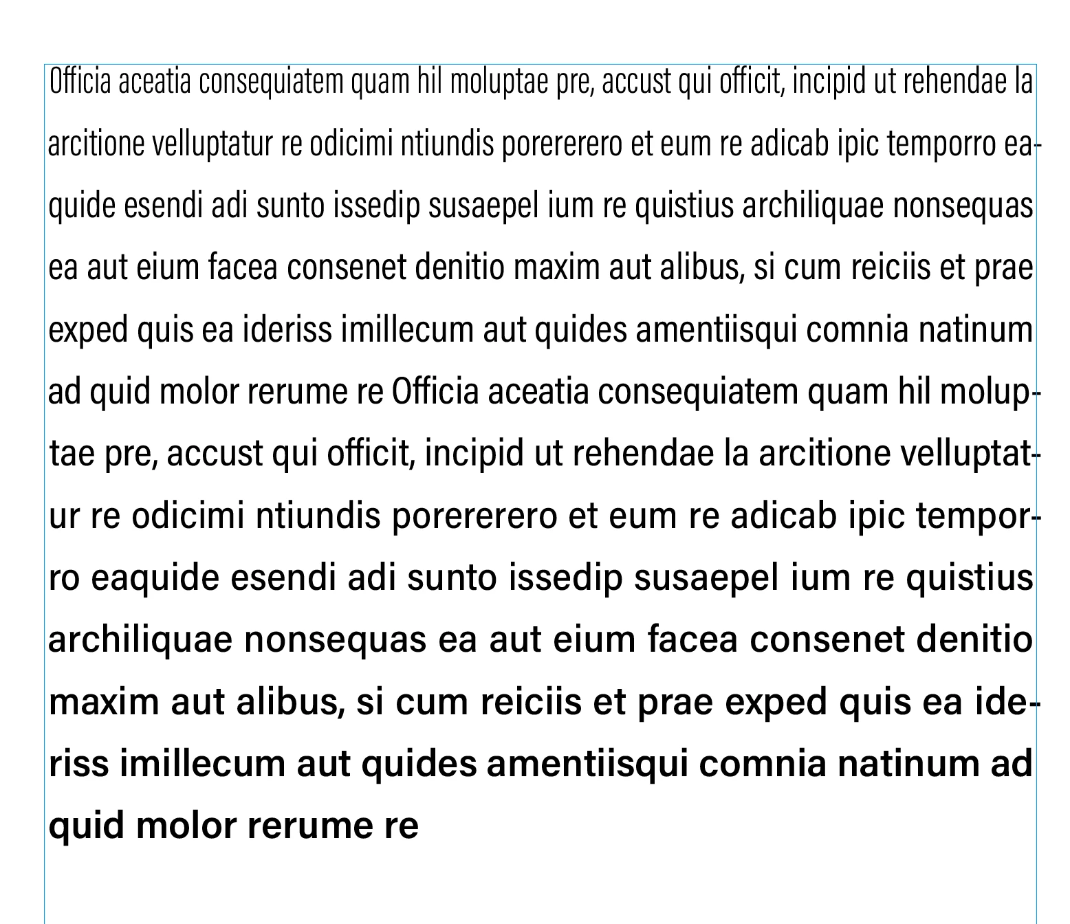

Hi @Christoph5C7F , Not sure if this helps, but I think setting the axis values to an integer rather than a real number helps with speed. This takes around 6 secs for 900 characters:
app.doScript(characterBlend, ScriptLanguage.javascript, undefined, UndoModes.FAST_ENTIRE_SCRIPT, "Script Action");
function characterBlend(){
    app.selection[0].appliedFont = "Acumin Variable Concept	Regular"
    var txt = app.selection[0].characters.everyItem().getElements();
    var t = txt[0];
    var myDesignAxesValues = t.appliedFont.designAxesValues;
    //the beginning and end of the 1st axis
    var a1s = 300;
    var a1e = 600;
    //the beginning and end of the 2nd axis
    var a2s = 50;
    var a2e = 100;
    var wstep = (a1e-a1s)/txt.length;
    var cstep = (a2e-a2s)/txt.length;
    for (s=0; s<txt.length; s++){
        myDesignAxesValues[0]=(Math.round(a1s+wstep*s));
        myDesignAxesValues[1]=(Math.round(a2s+cstep*s));
        txt[s].designAxes=myDesignAxesValues;
@rob day
    var t = txt[0];
    var a1s = 300;
    var a1e = 600;
    var a2s = 50;
    var a2e = 100;
