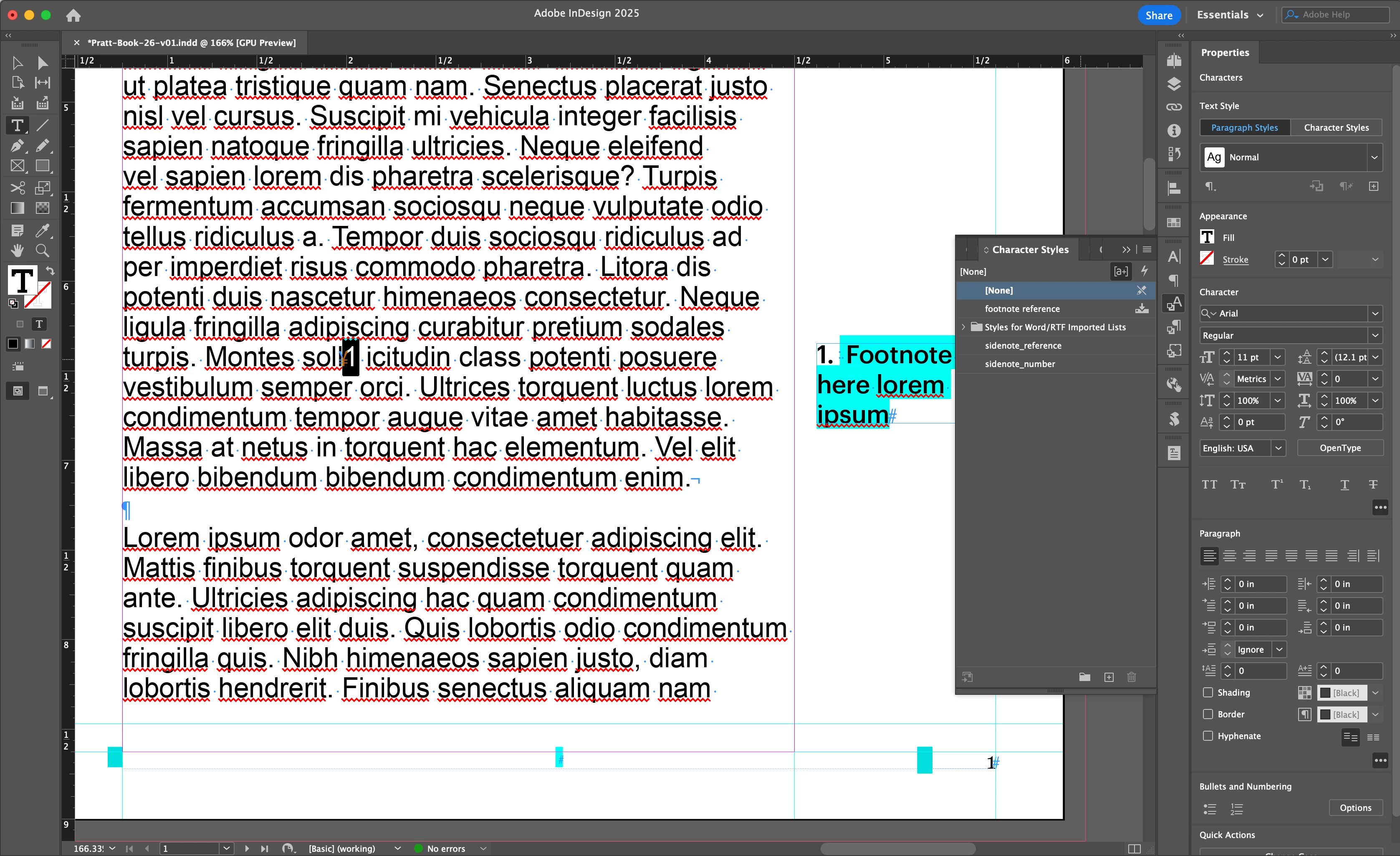

I’m having two issues using Peter Kahrel’s sidenote script:
  1. The sidenote_reference style is not being applied to the superscript footnote numbers in the text
  2. The sidenotes are retaining overrides. I can remove these randomly, but can’t figure out how to avoid having any overrides.
Both issues are visible in this screenshot:
Note that the superscript footnote marker has successfully been replaced by the Sidenote anchor+number, but the style has not been applied. The sidenote itself is showing the blue ‘Style Overrde Highlighter,’ showing that an override has been applied

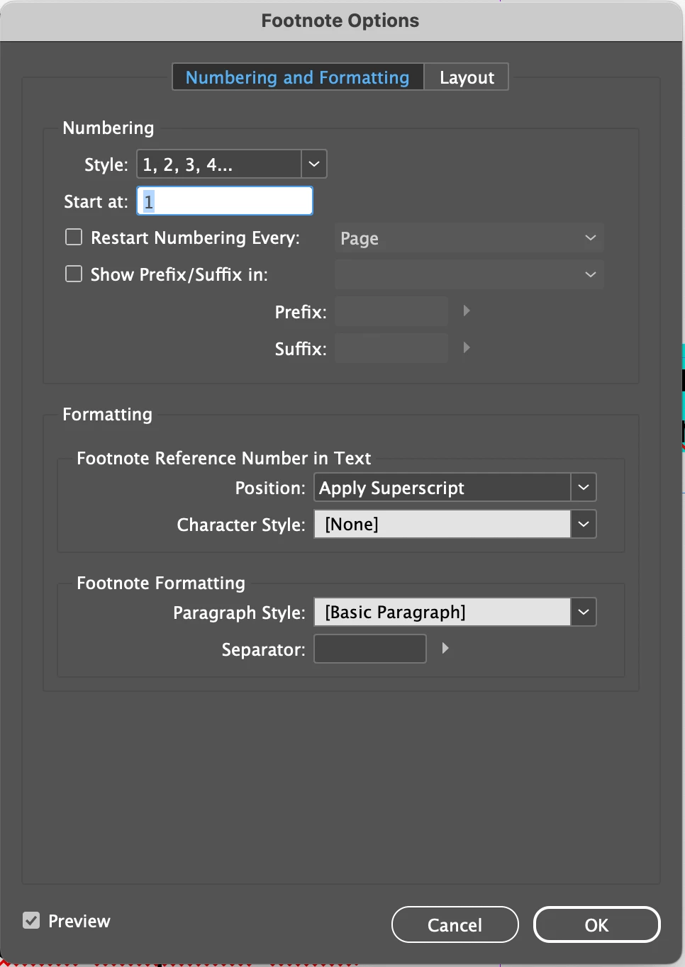

The text is imported from an rtf file, and the footnotes appear to import correctly. My Footnote Options are set to the most basic defaults.

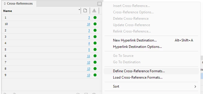

    The problem is that the cross-reference format lost its application of the character style for the sidenote reference in the text. It's easy to fix. Open the Cross-Refernces window (Window > Type & Tables > Cross-References):
    Then select Define Cross-Reference Formats from the fly-out menu:

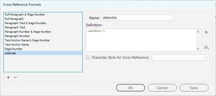

    Check the Character Style for Cross-References checkbox and the dropdown select the style (sidenote_reference). Click OK a couple of times to get back to the document and you'll see that the style is now correctly applied.
