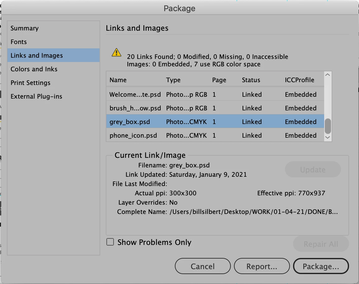

January 10, 2021
Do you mean that the actual images have been reduced in size and/or resolution after being packaged? Or do you maybe mean that the screen view of the images when seen through InDesign is blurry? If the latter is the case then see what happens when you go through View>Display Performance>High Quality Display. If the former is the case then during the package process what is the Effective ppi of the images as shown in the Links and Images tab of the Package dialog that appears? For the images to look good the effective ppi (what the resolution is at the size the image is being used) should be around 300 ppi.
