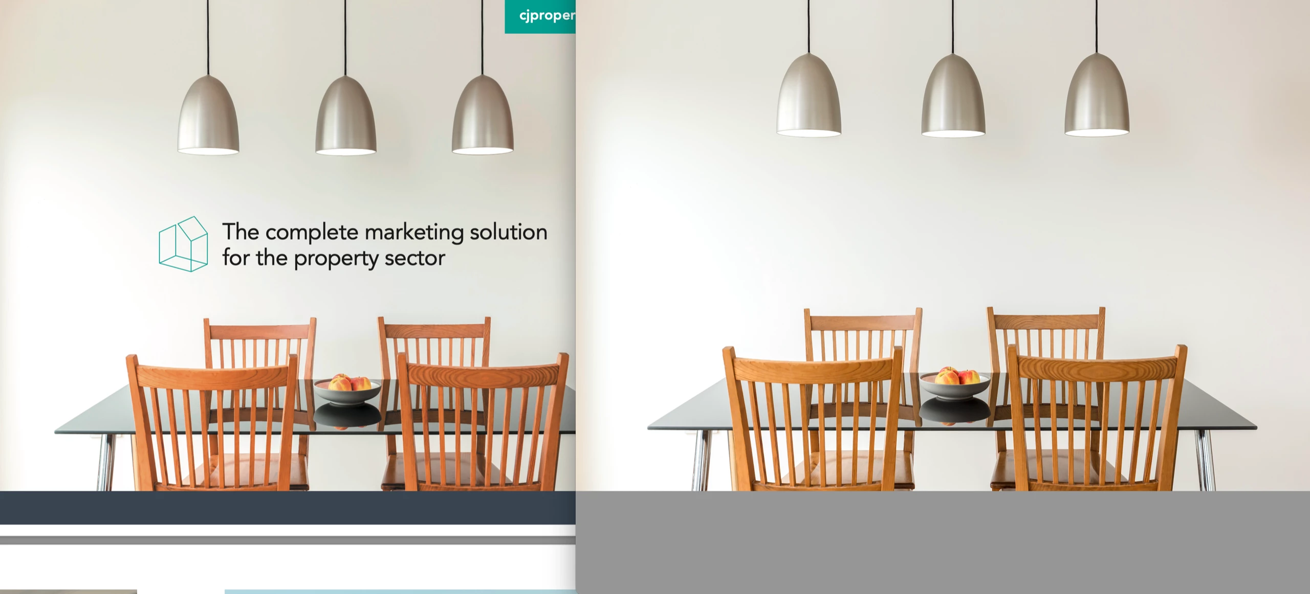

Help! I have noticed recently that when I make a print-ready PDF from InDesign files using settings that I have always used, some pictures come out unacceptably red, especially pictures involving wooden furniture or wooden surfaces. The PDF comes out of Acrobat looking different to the InDesign file (with a picture from a pro photographer). The same picture in a PDF from March 2022 looks fine, and I have not knowingly changed any PDF settings. This is a recent development and two clients have questioned it so far. I wonder if it is a problem, a change or a bug in recent Creative Suite versions that either hasn't been well enough publicised or not noticed. There may also be other changes such as pictures looking a bit dull or oversaturated other colours, but I haven't a clue what's happened or how to sort it out. The file attached is original PSD on the right and printed version on the left.

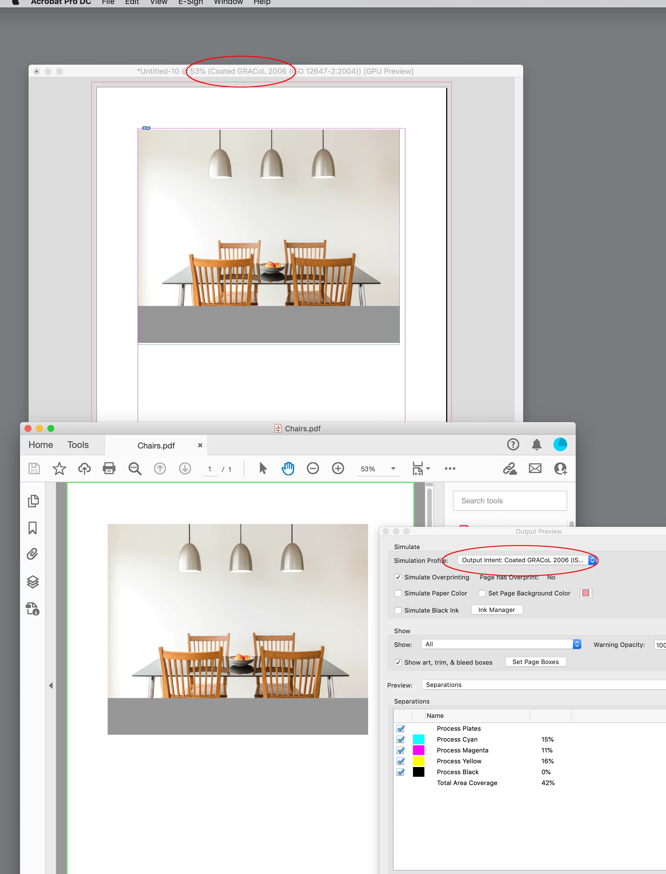

What Export preset are you using? Does it happen if you export to a PDF/X preset and view in AcrobatPro with Output Preview turned on? Here is a default PDF/X-4 export viewed in AcrobatPro. The PDF/X Document CMYK Output Intent Profile is used as the Simulation profile in Acrobat’s Output Preview

This is affecting screen display of PDFs and printed output... and is new as far as I can tell.
