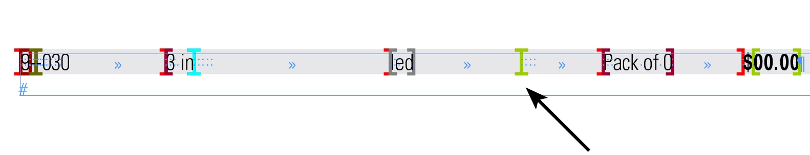

I need to insert a dot if a column is as empty. But when i use find and replace method it removes tag in between the tabs. Is it possible to place a dot without affecting the xml tags?
app.findGrepPreferences = null;     app.changeGrepPreferences = null;
app.findGrepPreferences.findWhat="\\t\\t";
app.changeGrepPreferences.changeTo= "\\t.\\t";
app.changeGrep();

Need to add dot only in the empty tagged content in the selected area? But may i know why the previous words get deleted?
Not through F/R. You may need to reach the xmlElement and set contents. I would preferably target the xmlElement specifically through EvaluateXPathExpression but here is an approach.

Thanks Loic, but when i run the provide code, it shows "Undefined is not an Object" in line 15
Loic.Aigon
September 9, 2016
I see. As <FEFF> is a kind of generic metacharacter, it may imply some other found result is not related to a XMLElement.
Let's make this safer:
