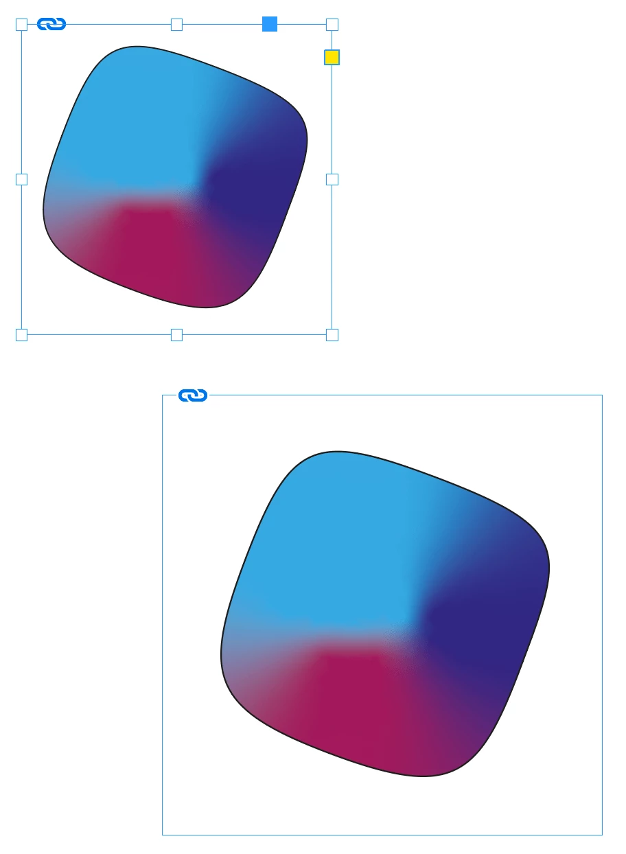

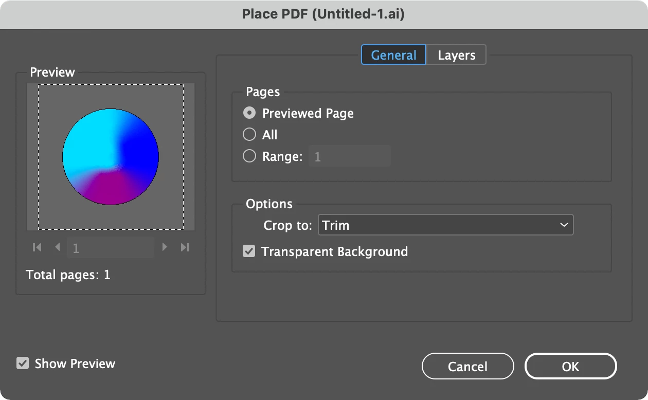

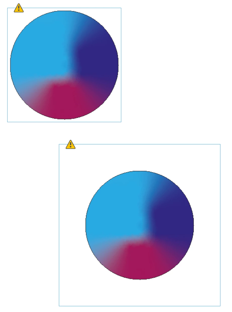

As I understand the problem, when you change some artwork in Illustrator and update the graphic in InDesign the artwork is cropped differently than it was. Either the artwork is a different size in Illustrator or has changed position on the artboard or the artboard has been adjusted.
The solution is to place the artwork in InDesign in a way that ignores the position and size of the artwork when cropping. To do that you need to select a different crop option when placing the artwork. You can do that by holding Shift when you place the art or by clicking Show Import Options in the place dialogue. There you can select layer visibility (which is probably not relevant to this issue) and select a crop option. In the image below I selected Trim, which is the size of the artboard. When the image is placed it will have excess white space because InDesign will treat the entire artboard as the image. I might decide to crop some of the whitespace out, but I know as long as I don't adjust the artboard the image will not be resized or moved unless I move it in Illustrator.
In the first example below I have edited my artwork in Illustrator but not yet updated the links in my InDesign file. The top image was placed cropped to the art. The bottom image was placed cropped to the trim. In the second image I have updated the artwork. InDesign saw the artwork has a larger bounding box so it scaled the artwork in the top image to fit the existing frame. In the bottom image the crop isn't changed because the artboard is still the same size.
You may need to re-place some or all of the images but if you use this place method the images won't change unexpectedly.
