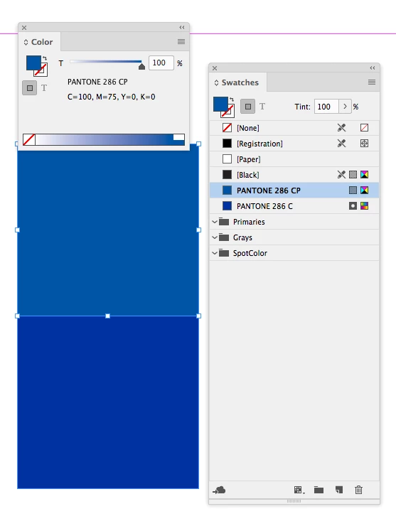

I have a placed PDF file that uses a spot Pantone 286 (cmyk values), when placed in Indesign and exported, the spot Pantone 286 turns to a LAB build.
Using Indesign CC 2019
My export settings are: Export for Print, standard: none, compatibility: acobat 5 (PDF 1.4), no compression, crop image data to frames, crop marks only, .125 bleeds, no color conversion, don't inclued profiles, no opi.
Can anyone shed any light on why the spot color would change from cmyk values to lab values with these settings?
Thanks!

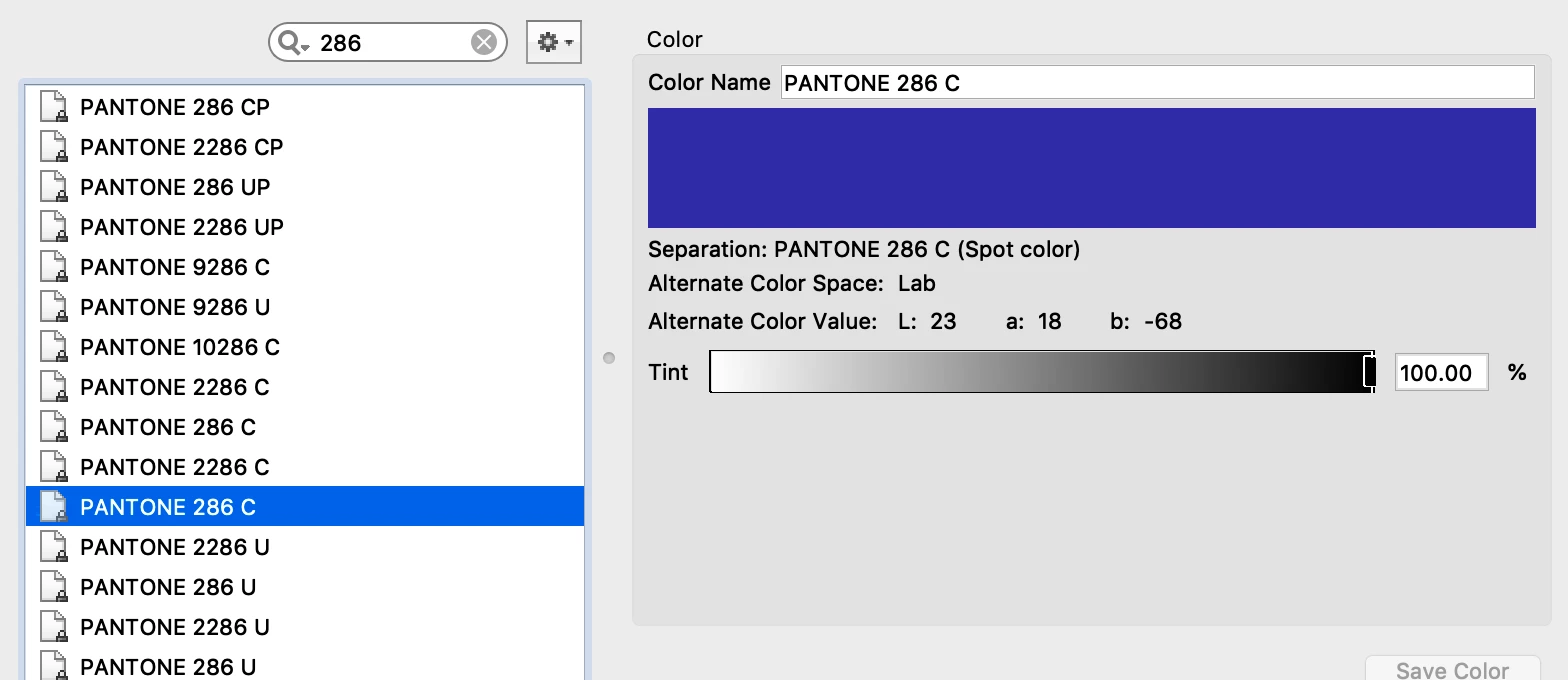

    Starting with CS6 the Pantone Libraries were changed.
    The Solid Ink libraries are now defined as Lab values, which allows out-of-gamut colors (like your 286C) to be correctly displayed. If the Solid Ink spot colors are converted to process CMYK, the conversion is color managed and the values would depend on the destination CMYK profile used in the RIP.
    There are also new process CMYK libraries—the PANTONE + Bridge libraries. These libraries are defined as process CMYK colors (not spot) and if the destination is Document CMYK, they would export with unchanged CMYK values:
    The Bridge version
    The Solid Ink version

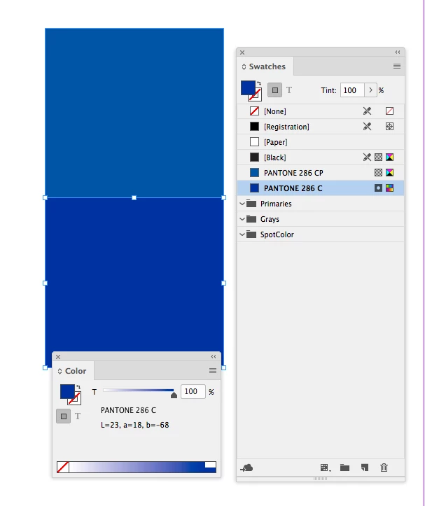

    Not in the way the RIP interprets the builds. Take a look at the 2 screenshots. The one with the CMYK values is what is placed in Indesign. When I export with no color conversion, it should come out like it is placed. Instead, it comes out with LAB values. Although both are set as spot 286, the RIP interprets the color builds based on the alternate color space.
    I want to know why Indesign changes it to LAB. Is there a setting that needs to be changed in my preset?

    Swatch Colors have 2 properties: Color Type and Color Mode.
    A Pantone Swatch can have Color Type: Spot and Color Mode: LAB
    From the PDF that you are placing, can you determine the Color Mode of the PANTONE 286C ?

    I am exporting to a spot color and letting our rip take care of converting to process. But, the LAB build has yellow and black in it, while the CMYK build only has cyan and magenta. The placed PDF has the CMYK 286 C selected pantone color which is what we are wanting, the exported PDF has the LAB 286 C pantone color build and our rip is converting that build.

    It should be the same build as the placed PDF, but Indesign is changing it somewhere to LAB.
