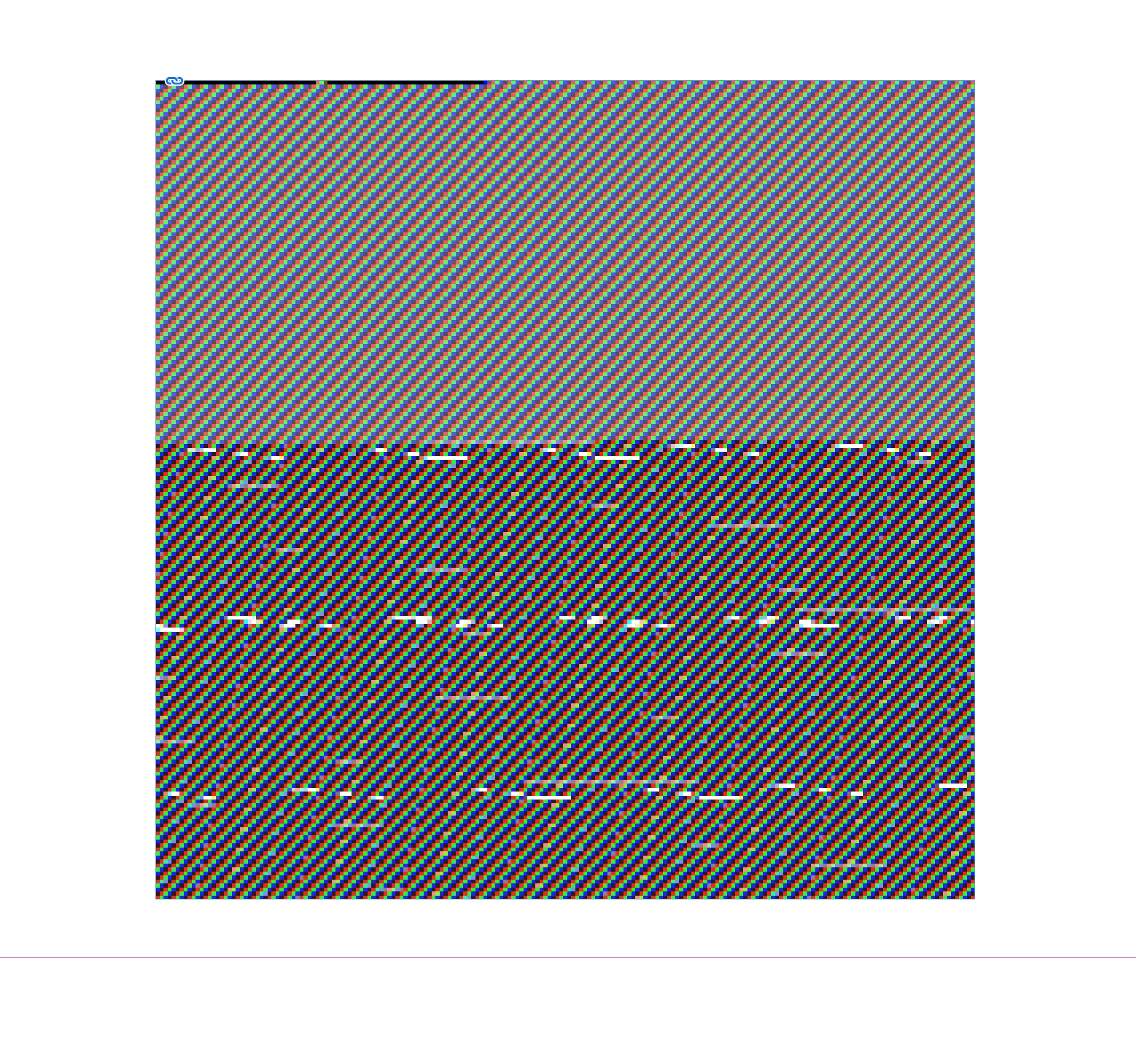

placed PNG QR Code glitch
Hello!

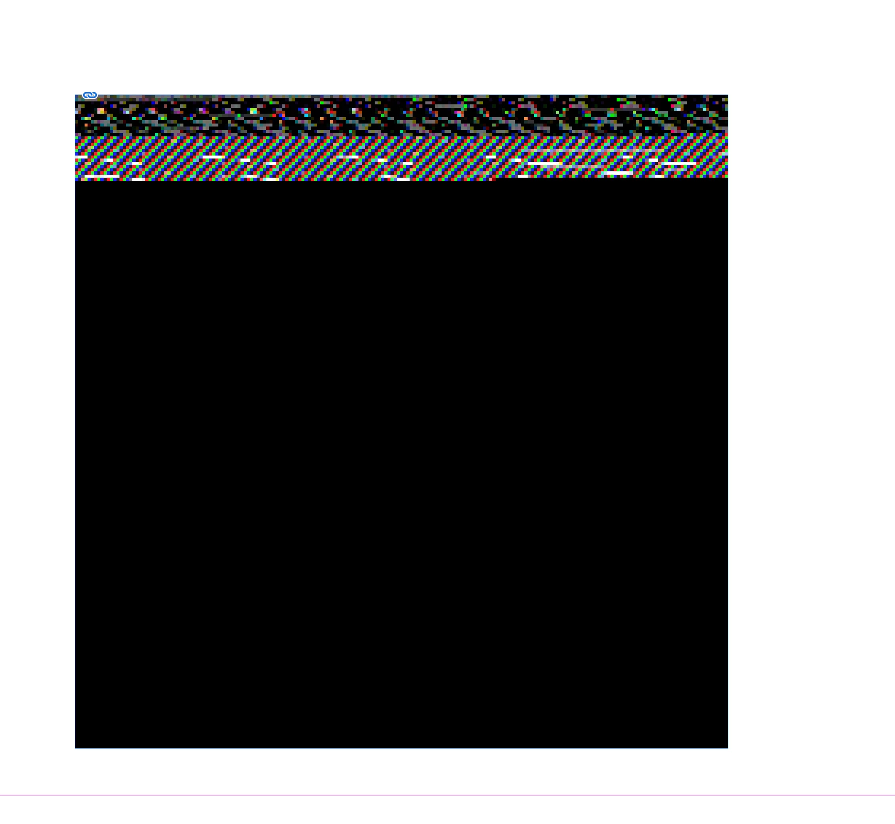

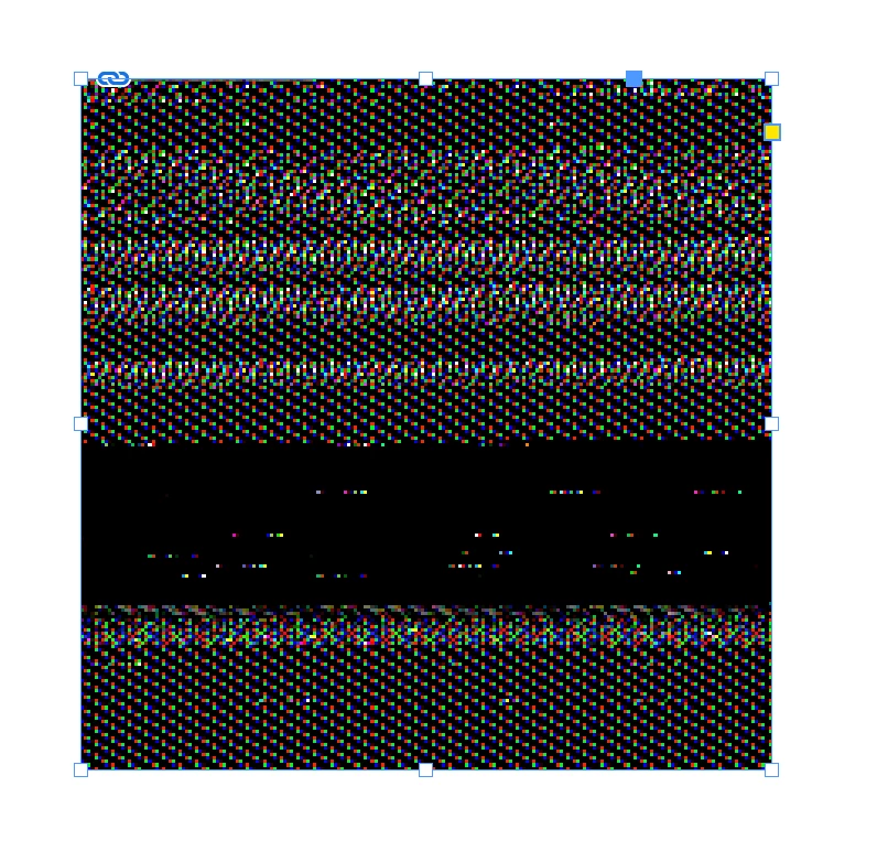

I have a PNG of a QR code generated outside of adobe that I'm trying to place into a flyer in InDesign. The image works and is stable elsewhere. When I place (linked) into my document, it appears normal and after a minute or so it glitches out, and changes every minute or so. I think some other community posters are experiencing the same thing but many of the answers are related to the native QR code feature. See attached images for examples. I can delete the placed image and place it again and it will appear normal for a few minutes before doing this again. Each time it looks different.

Wanted to follow up: I'm using a 2022 Macbook pro with Sequoia 15.6.1 and the file was stored locally in a folder on desktop.
I tried several different QR codes. Unfortunately PNG was the only format offered by the analytics tool we're using (QR was link to survey tool).
I don't think the PNGs were corrupted, as I stated that they would appear normal and then spontaneously glitch within a minute of placement. I didn't try to export with the placed glitched PNG, so no way to know atm if it was due to GPU perfomance though I thank Bob for that thoughtful suggestion!
I can say that I exported the doc from indesign without it as a PDF, and then placed the QR code in illustrator. Ideal? No. Clunky? Yes. Illustrator had no issues with the image.
This was a one-time and time-sensitive issue so it's unlikely I'll pursue fixes for this, but it was extremely frustrating while it happened.
