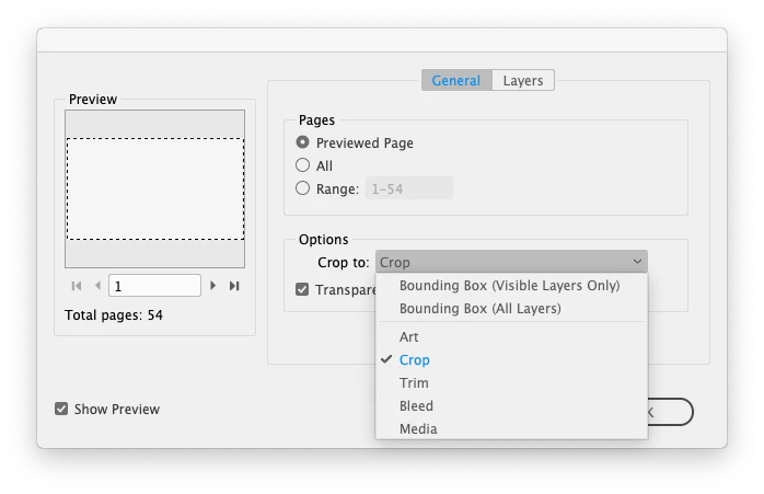

Hi Dan - it sounds like it could be the import options:
If the crop options change to anything different to how the file was originally placed then Indesign will change the scale and position of that file due to inclusion/absence of additional areas.

Check your preferences. Is content aware fit turned on?

I would bet that Dave's answer is it.
