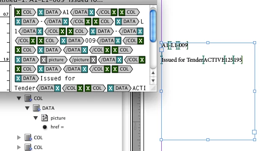

Hi John-
Here's what my situation looks like. I get this for the FileMaker XML that I'm given:
So I can programmatically specify where I want the placed PDF as an XML reference:
app.documents[0].selection[ROW].associatedXMLElement.xmlElements[COL].xmlElements[0].xmlElements[0].xmlAttributes[0].value
and obviously I can get a filename. I just don't know what to do with this information to place the graphic.
Thanks again,
Charles
John Hawkinson
May 31, 2011
Oh, right. Did we forget to tell you that trying to use XML in InDesign is usually a bad idea and that you could do much better without it?
Anywhohowwhichwhywhere...
In keeping with that theme, XML doesn't really come into play. If you have a rectangular frame rect and a filename filename and you want to place  filename in the rect then you just use: rect.place(filename);
So in your case, it's just about defining the two. I guess:
var rect, filename;
rect = app.documents[0].selection[ROW].associatedXMLElement.
    xmlElements[COL].xmlElements[0].xmlElements[0];
filename = new File(rect.xmlAttributes[0].value);
Of course, if your filename is really a URL you'll have a spot of trouble there, maybe.
And you might be better off using XPath, i.e. .evaluteXPathExpression("//picture") to get your rectangle.
And what if href= isn't the first attribute of the <picture/> tag?
I suppose that perhaps you should consider using the .placeIntoFrame() and .placeXML() methods of the XMLElement class. I suspect you'll be sorry if you try, but go ahead :-).
