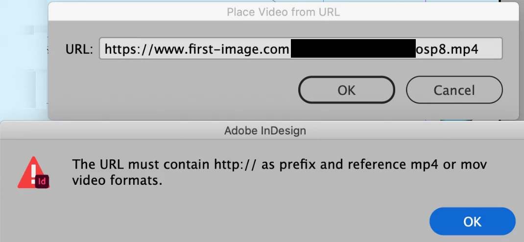

In InDesign I created a frame and went to the media panel and selected “Video from URL...”. When I entered my URL it said the file name had to start with, “http:”. My URL starts with, “https:” and it wouldn’t accept it. Is there a work around? I am using InDesign 17.2.1.
I will be exporting the final version with in5.
