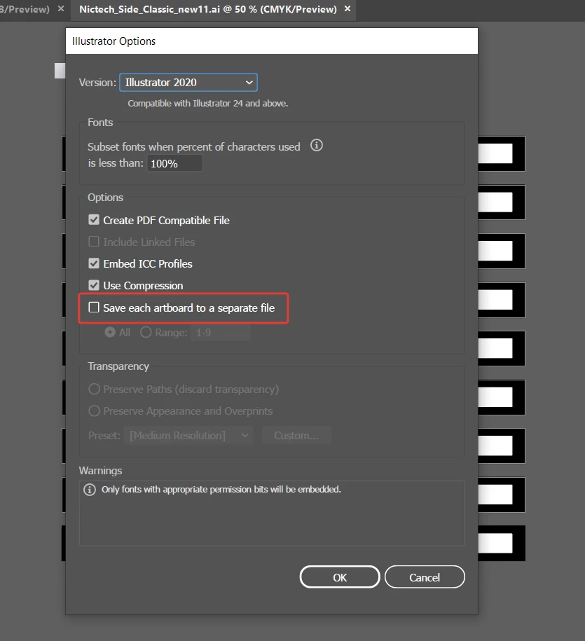

But I want to sav out out individual artboards in illustrator as separate ai files, and I cant get that to work, or even saving out a selection as an ai file. my ai doument is huge wit lots of different graphics on it) Is there a way to do that?

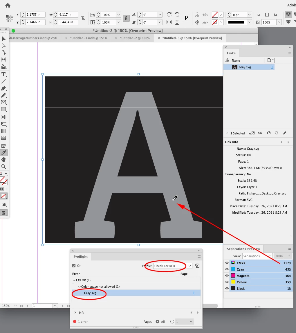

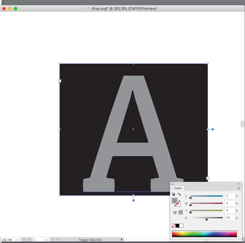

.SVG files do not support CMYK even if your AI document Color Mode is CMYK. Saving as .SVG outputs RGB color with no color profile—you really don’t want to use SVG if color mangement is important.
InDesign’s Preflight will flag an .SVG file as RGB:
The file in AI with the "A" filled as 50% Black and the color mode set to CMYK:
