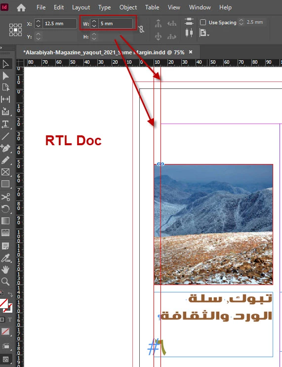

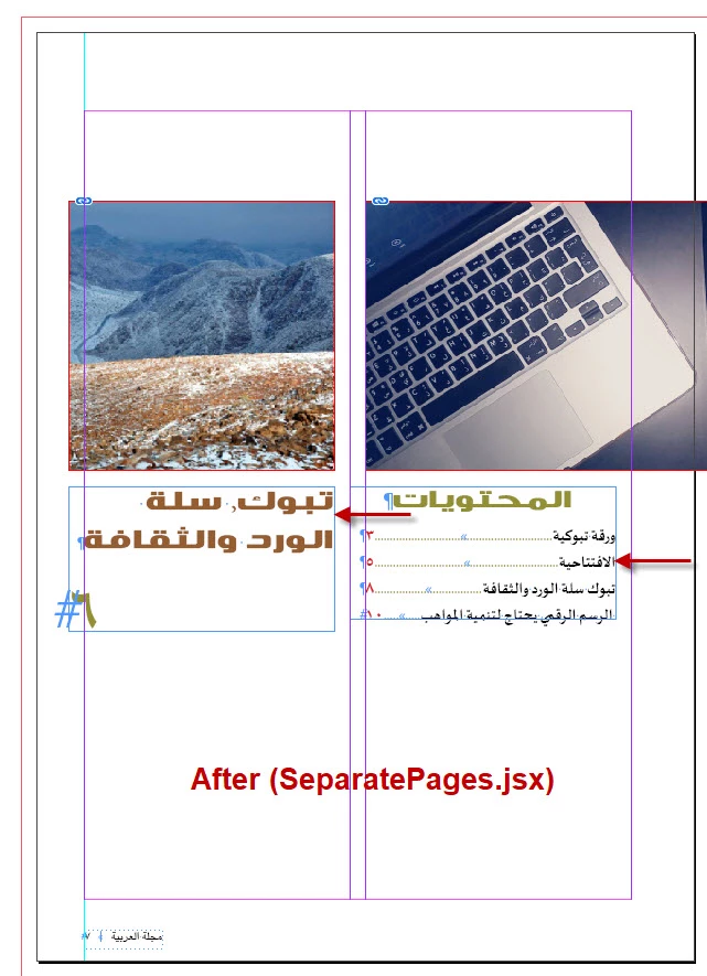

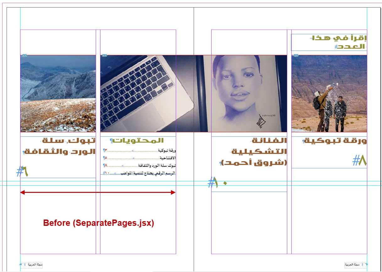

i see after running the script that the splitted pages have items moved to the left (images and text frames), that including images and text frame!, I don't know why, no error messages! but it moves to left, thats mean vandalize the document!
Please can you help me to identify the problem, i still learning javascript so i can't figure where is the problem?, here is screen shots.
Thanks in Advance
Best
M.Hasanain

Thanks FRIdNGE for the Update, But Actually the Problem is Still Exist!, I found if the Doc are (LTR) so the  Right Hand Pages items need to be Shifted -5mm and if the Doc are (RTL) so the Left Hand Pages items need to be Shifted 5mm!, So the Problem is still exist.
Mohammad Hasanin
