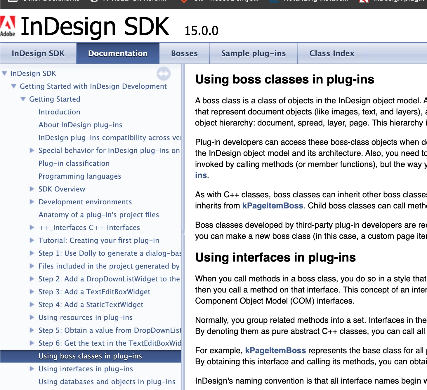

Refer the documentation shipped with sdk for a detailed descrption on boss class. Look at docs/html folder open any html file and in the left hand tree structure go into Getting started and read the section "Using boss classes in plugins". See screenshot below
-Manan
