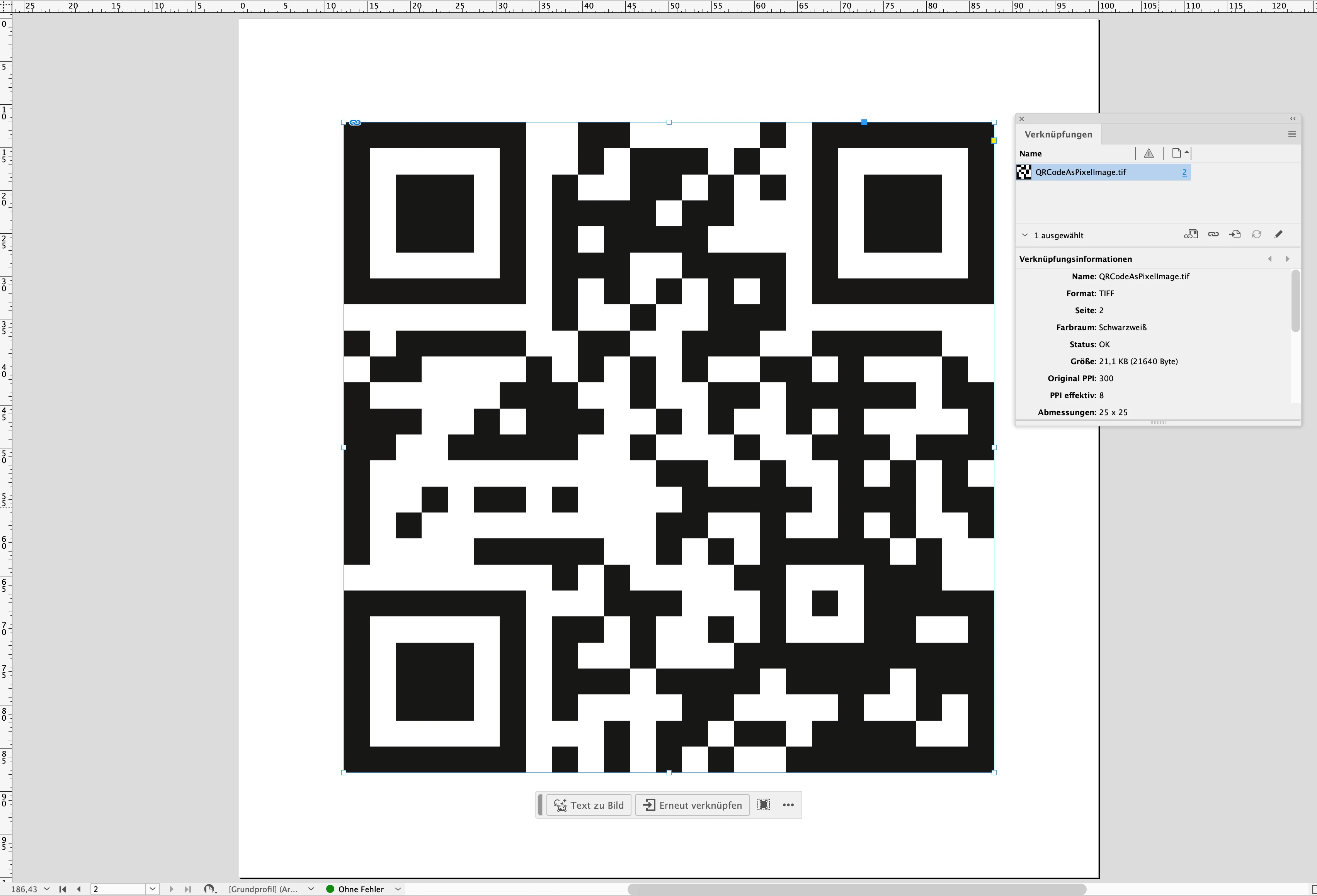

Hi @Steve5FD8 ,
in case you are using pixel-based images for an QR code it's not so much important if the files are high-res or not.
In an extreme case every square in an QR code could be exactly one pixel wide. There would be no loss of quality with exporting to PDF if the right image type is used and the export will not try to re-render the placed images.
For example:
Save the QR codes as 1-Bit bitmap data in PhotoShop as TIFF file, place that in InDesign.
When exporting to PDF make sure you do not downsample bitmap data.
Download a sample from my Dropbox account:
https://www.dropbox.com/scl/fi/f4cltq0hx70nkb4yzujsa/QRCode-Vector-vs-PixelImage.zip?rlkey=j9j3tp5009teh8l8umztqbwv3&dl=1
QRCodeVector-vs-PixelImage.indd
On page 1 is the QR code generated in InDesign as vector graphic.
Page 2 is showing a placed lowres TIFF image of the same code where every square of the QR code is just 1 pixel wide.
All in all the whole QR code image is 25 x 25 pixels. Effective resolution in InDesign is about 8 ppi.
I exported the InDesign document to PDF where I disabled downsampling for 1-bit images.
From my German InDesign showing page 2 where the bitmap is placed:
Uwe Laubender
( Adobe Community Expert )
