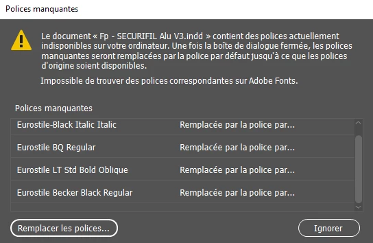

Bonjour,
J'ai un problème avec mes polices.

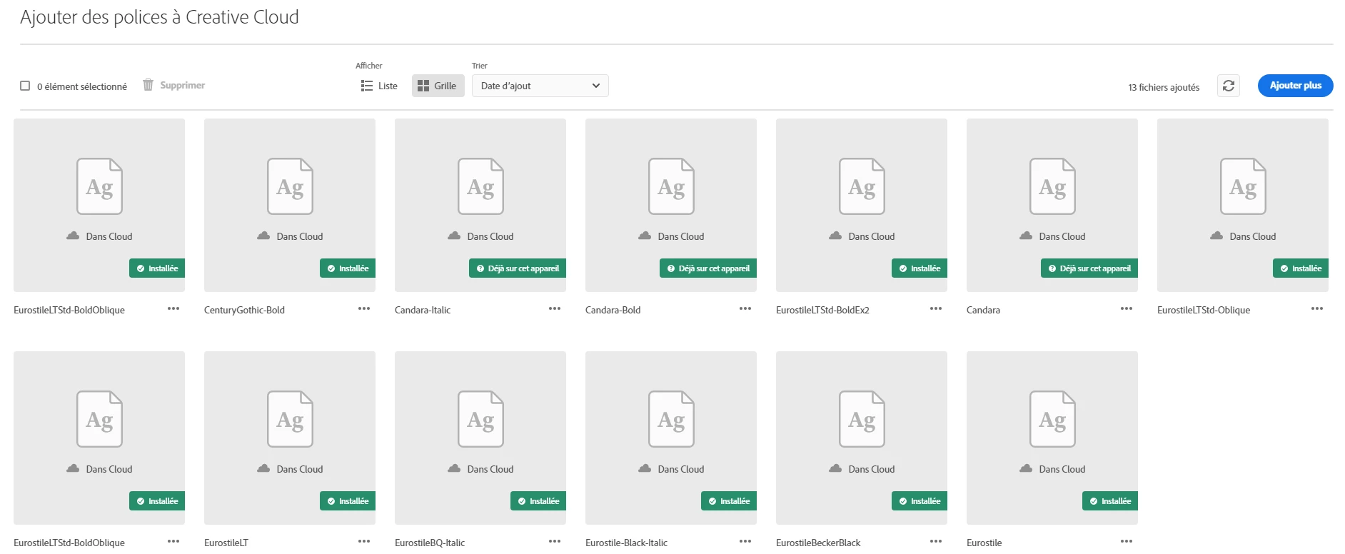

J'ai ajouté des polices à Creative Cloud, le jour même, tout fonctionne, mais le lendemain, dès que je ré-ouvre un document, que ce soit dans Indesign, Illustrator ou Photoshop, j'ai un message me disant que les polices sont manquantes.
Cependant, lorsque je vérifie sur Creativte Cloud, les polices sont bien marquées comme "installées".
De plus, si je supprime les polices de Creative Cloud, et que je les ré-installent, les polices se mettent à jour et je n'ai plus de problèmes dans mes documents.
J'ai donc l'impression qu'il y a un problème de synchronisation entre Creative Cloud et les logiciels.
Comment faire svp ?

You're going to have challenges trying to sync fonts from your Creative Cloud drive to your system. Frankly, even Adobe's cloud fonts, through Adobe Fonts, sometimes has challenges with that.
Because every time you shut down your system, you're breaking the connection from your cloud drive and ending your session with the cloud location. When you fire up the system again and re-connect to your cloud drive, you're establishing a new session. The files are still there, of course. But you will have to re-connect to your cloud resources because you ended the previous session and any connections you had to that cloud drive when you shut down. That's why you have to re-establish the font links to your system every time.
Are you trying to, like, sync fonts you use in the office with your home system? Have you tried simply downloading the font files from the cloud and then installing them on your system? That should end the issues you're having here forevermore.

I need to ask you a couple of questions here before I can help, because these factors greatly affect the answer(s) which may help you:
1. What software are you using? Mac or PC? Which version of operating system for your chosen platform? And what version of InDesign/Creative Cloud is installed within that operating system.
2. Are you using any third-party font management software? If so, what software/version is that font management software? Or are you relying on your operating system to install/store/activate fonts?
Your answers to these questions will affect what we can do to help you with your issues. Please advise, and we can hopefully help you from there.
Randy
November 22, 2021
Bonjour,
  1. J’utilise un PC avec windows 10 pro. La version d’Adobe Creative Cloud est 5.6.0.788 et celle de InDesign est 17.0.1
  2. Mes polices sont stockées sur mon système d’exploitation et transférées sur Creative cloud pour être installées aux logiciels Adobe.
