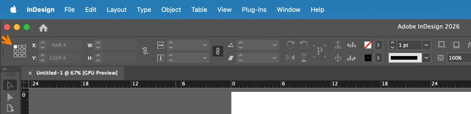

    Barb Binder
    Feb 21, 2026 1:43 AM UTC
    No, and in situations like this where you are working with a third-party application, your best bet it to ask the developer. I think this is the link you need: https://jans-in-scripts.org/feedback__en.php
    In the meantime, you might experiment with the reference point in the proxy. Potentially, changing it will impact the script the way it impacts any mathematical movement in InDesign.
