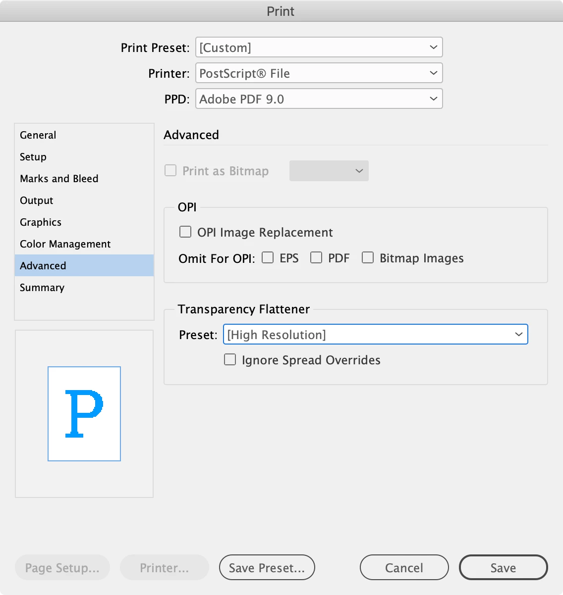

Tried the "print as bitmap" under advanced options.
Hi @Michele DM , If Print as Bitmap is not grayed out you must not have the Printer set to PostScript File? Does this Advanced setup change anything?

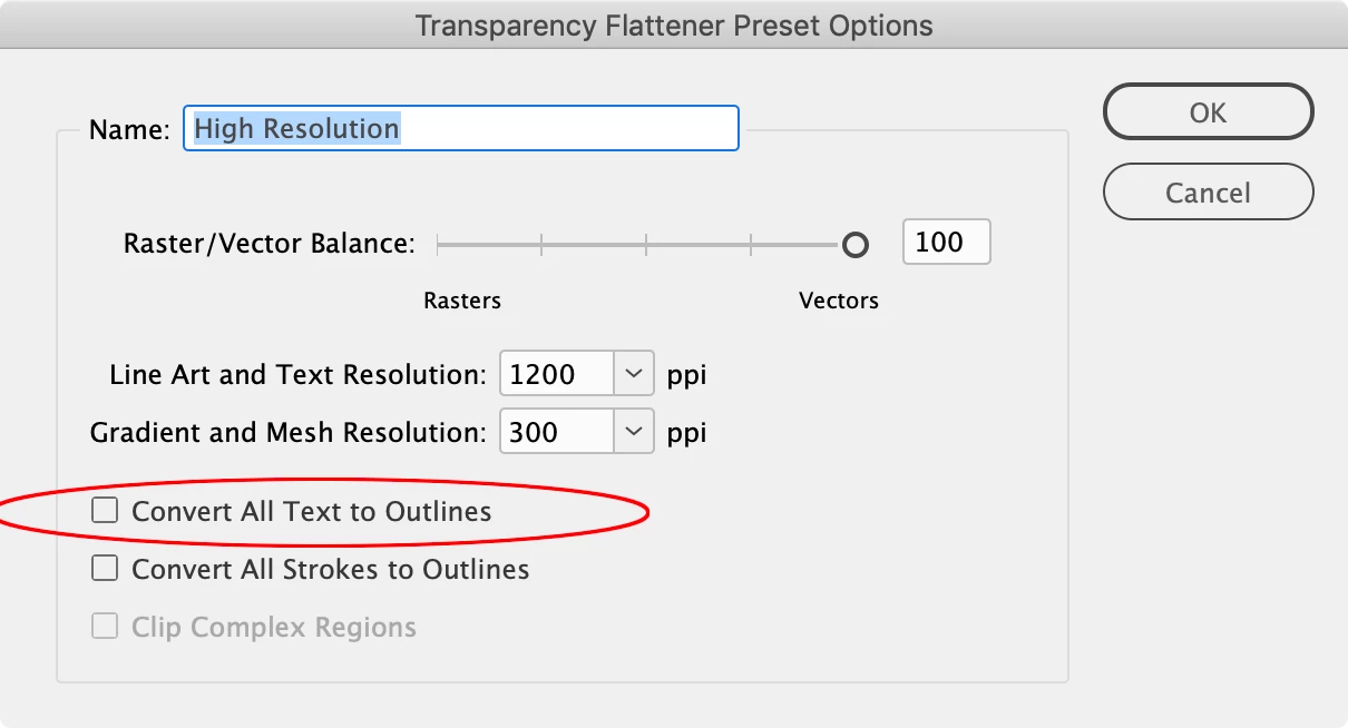

Also, is there any transparency on the pages? If a page has a transparent object the selected Transparency Flattener would be used—at 2GB+ it sounds like the text might be converting into outlines?

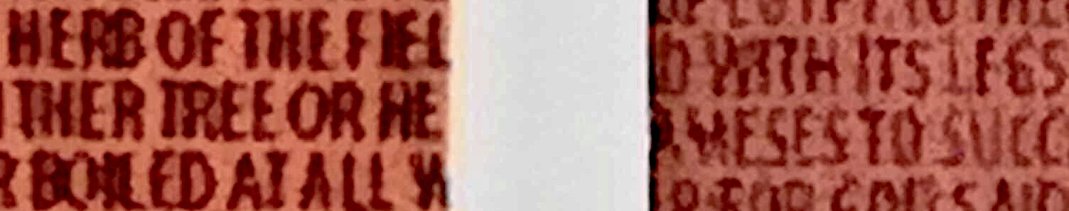

Yes, that would reduce the file size, but unfortunately I have to print from InDesign, it's because the text is miniscule and the text loses shape when I export to pdf.
I've tried the pdf route many times before without success.
I tried it again now, saved as a high quality pdf, no compression - please see attached, the result is on the right, text is sketchy.
On the left is when I send it directly from indesign, acceptable and readable text.
