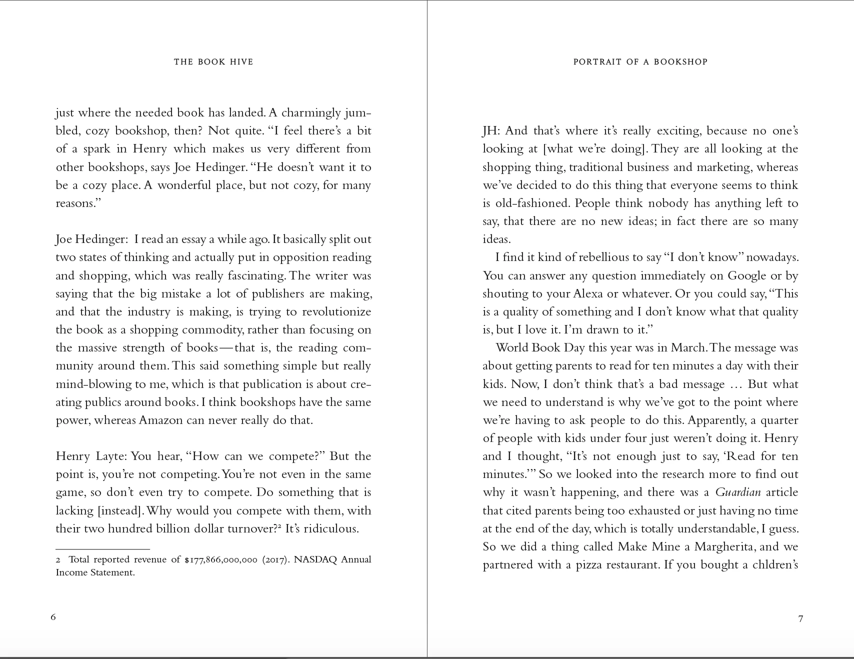

    Dear all,
    Thanks for the very helpful suggestions.  I will attach a screenshot of my layout.  You can see that I need both normal carriage returns (between paragraphs) and something equivocating a double-return (separating interview questions and sections).  You will also notice at the top-right how my archaic double-return has created an unnecessary space at the top of the right column.  But the "Space After" setting would add space everywhere, so that's not an option.  How can I keep the general paragraph "Space After" setting the same but somehow prevent this "ghost line break" which can be seen at the top of the right column?  Thanks!  This forum is extremely helpful to me.

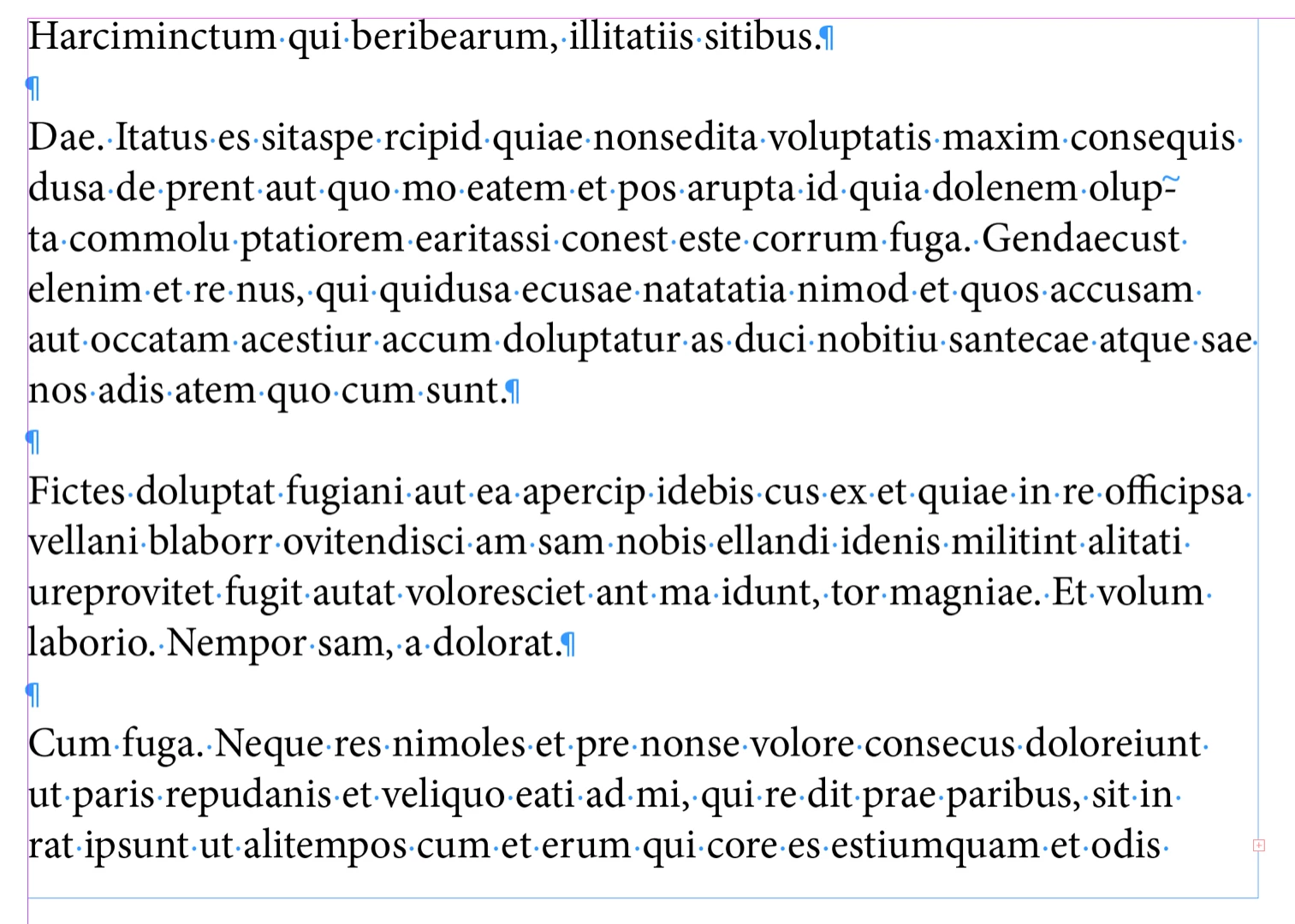

    Hi Jon:
    Using double ¶s as a way to add spacing between paragraphs is a mistake that carries over from typewriters and word processors, and you have discovered why it is not a good idea.
    Take a few minutes to remove the double (and potentially triple) returns, and then use the paragraph spacing commands to define the same spacing, which eliminates this issue.
    Before:

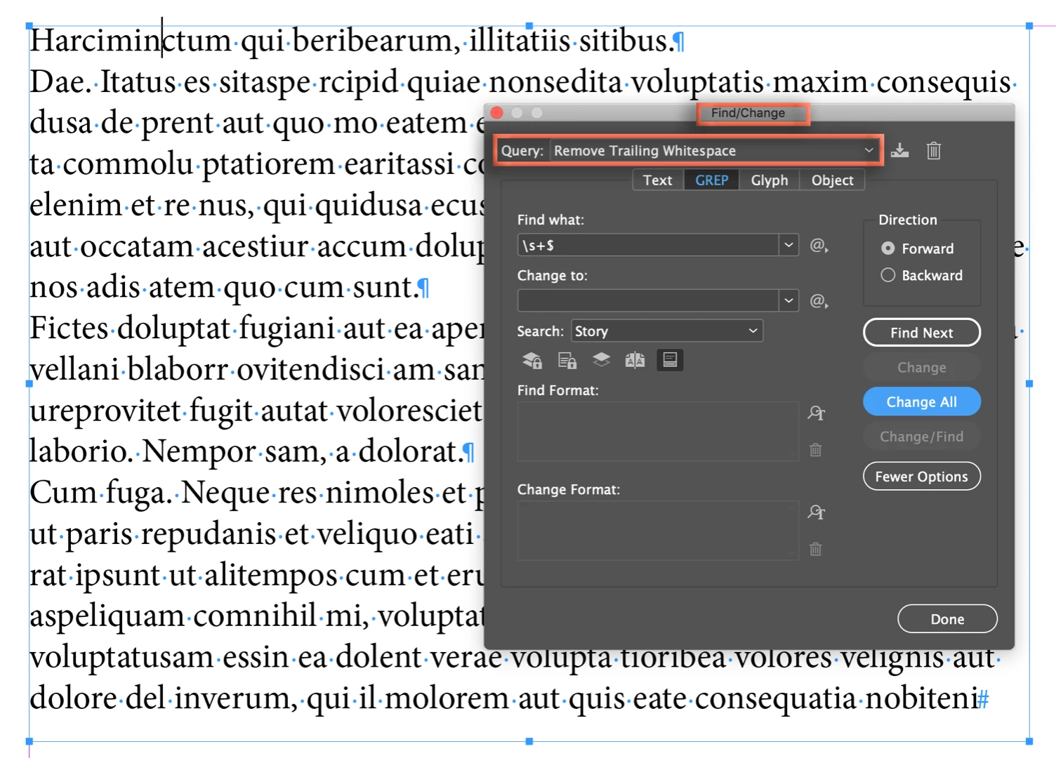

    After running the Remove Trailing Whitespace* query in Edit > Find/Change. (Save the file first):

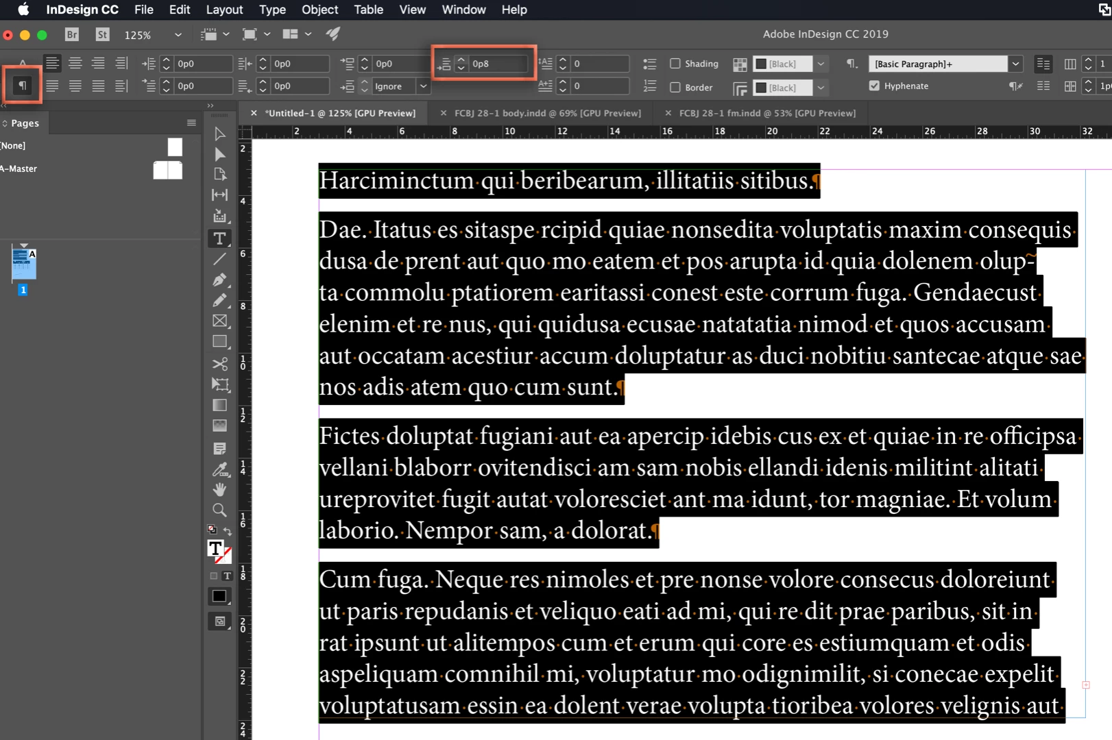

    Define Space After in the Control panel. (Redefine your style after you do this if you are using styles):

    * You can use Remove Trailing Whitespace -or- Multiple Returns to Single Returns. Both come with the software.
