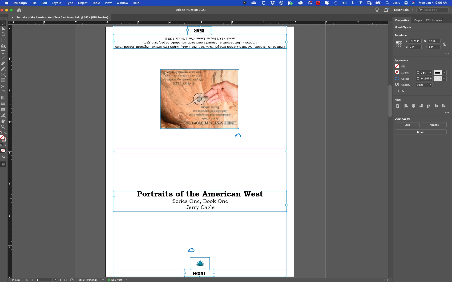

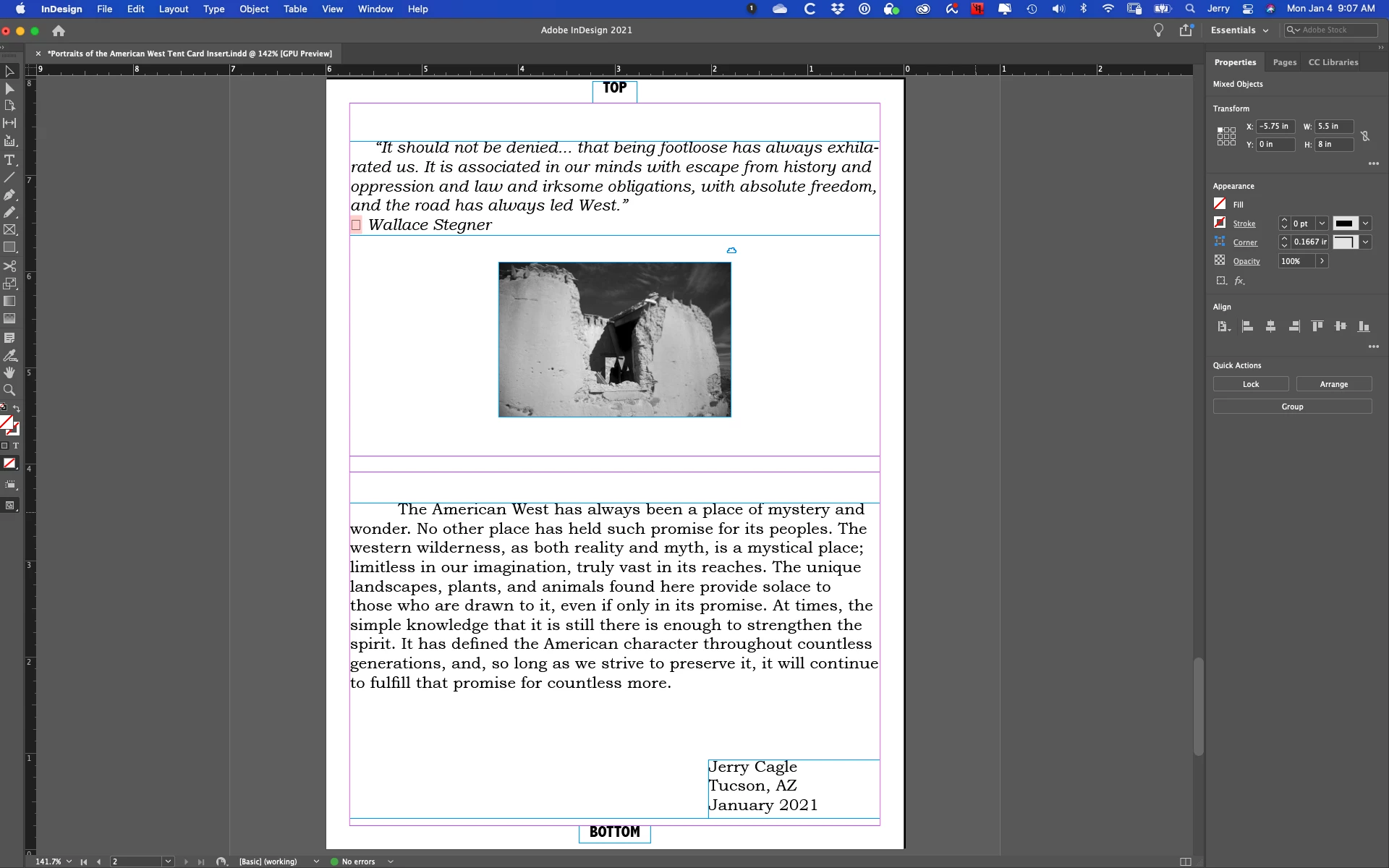

Everything in my document is aligned correctly, but when I print it it is misaligned (see attachments), and I have no clue as to why. Anyone have any ideas where to start?

If youre printing on actual 6" x 8" paper, you should set a Custom page size in your Print dialog. Also, make sure your orientationj is correct. in your screen shots, you're 90° off.

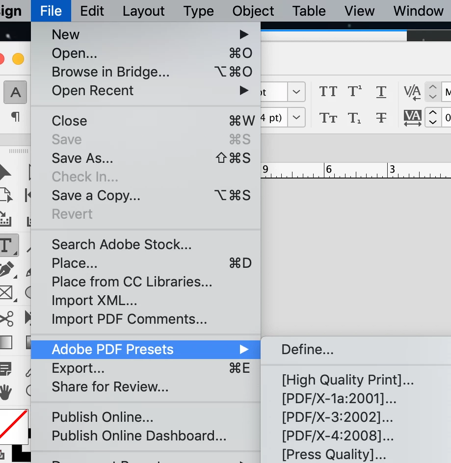

As for making a PDF, that should never be done from the Print Dialog in ID. Export it from the File > Adobe PDF Presets menu. For your purpose, try either Press Quality or High Quality. No need to change any of the options when you Export.
But since you have a special paper size, you will need to configure Acrobat accordingly. (Page setup > Paper size > Manage Custom Sizes....)

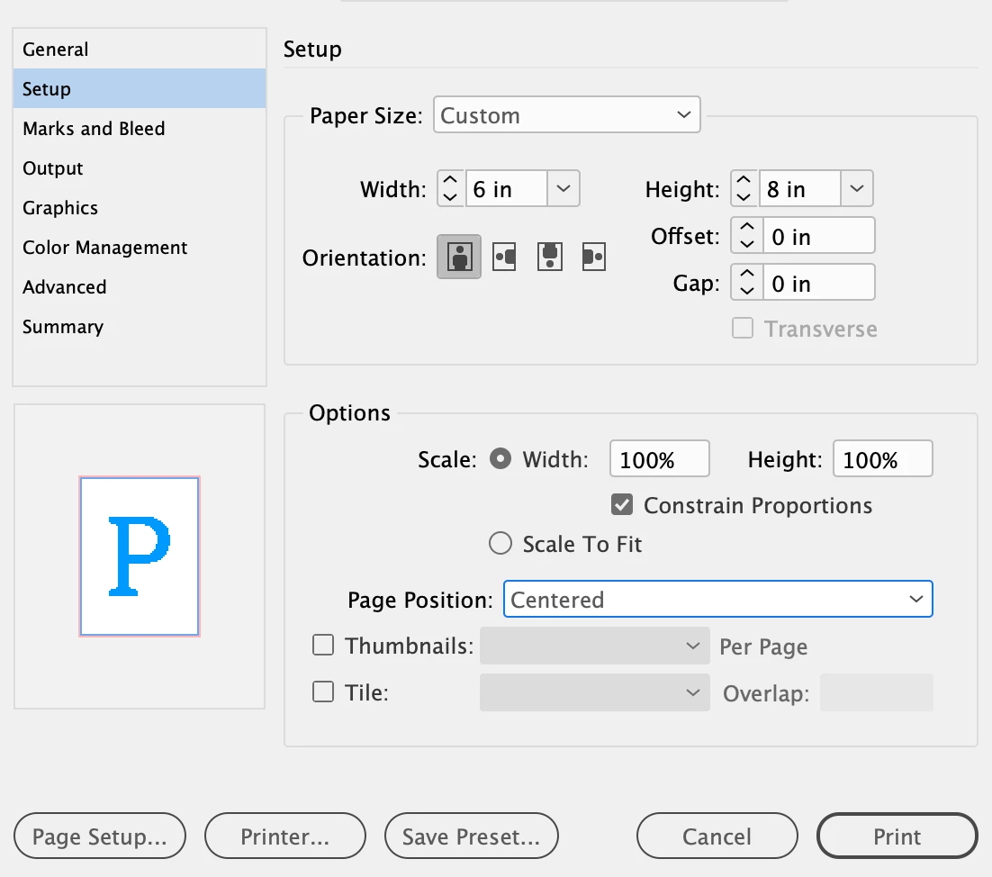

Sound slike a mismatch somehwhere with your Printer Driver. In the Print > Setup > Paper Size, what do you have there?
If you have "Defined By Driver" check Page Setup at bottom left to make sure there's not some weird page size selected in there.

If I'm understanding the issue, in the Print dialog window, look in the "Setup" section and for Page Position, choose Centered.

Thanks Jeff, but that doesn't seem to be the problem. Centered was already selected.
