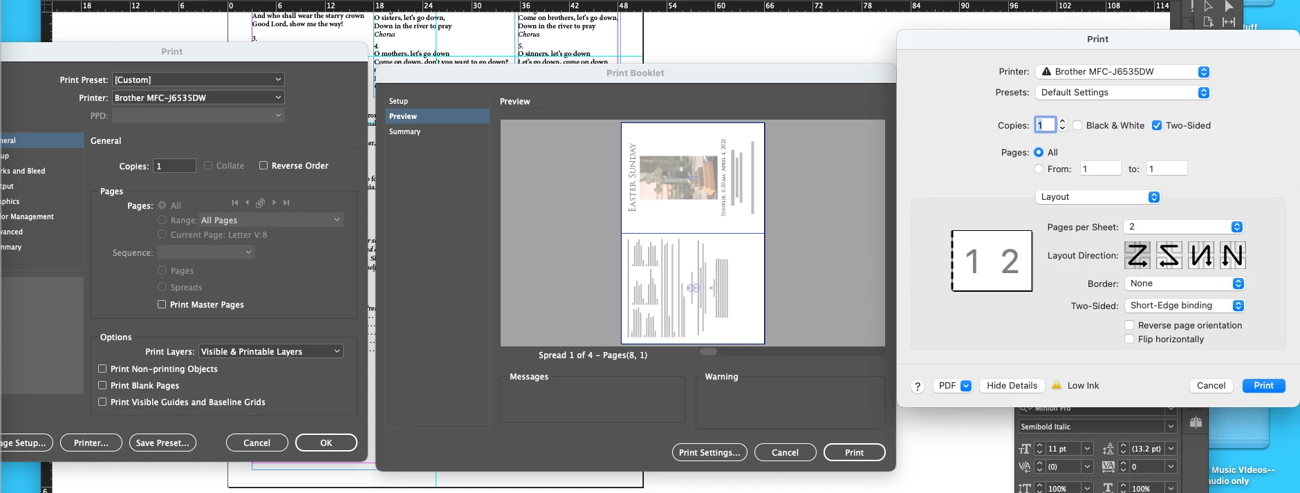

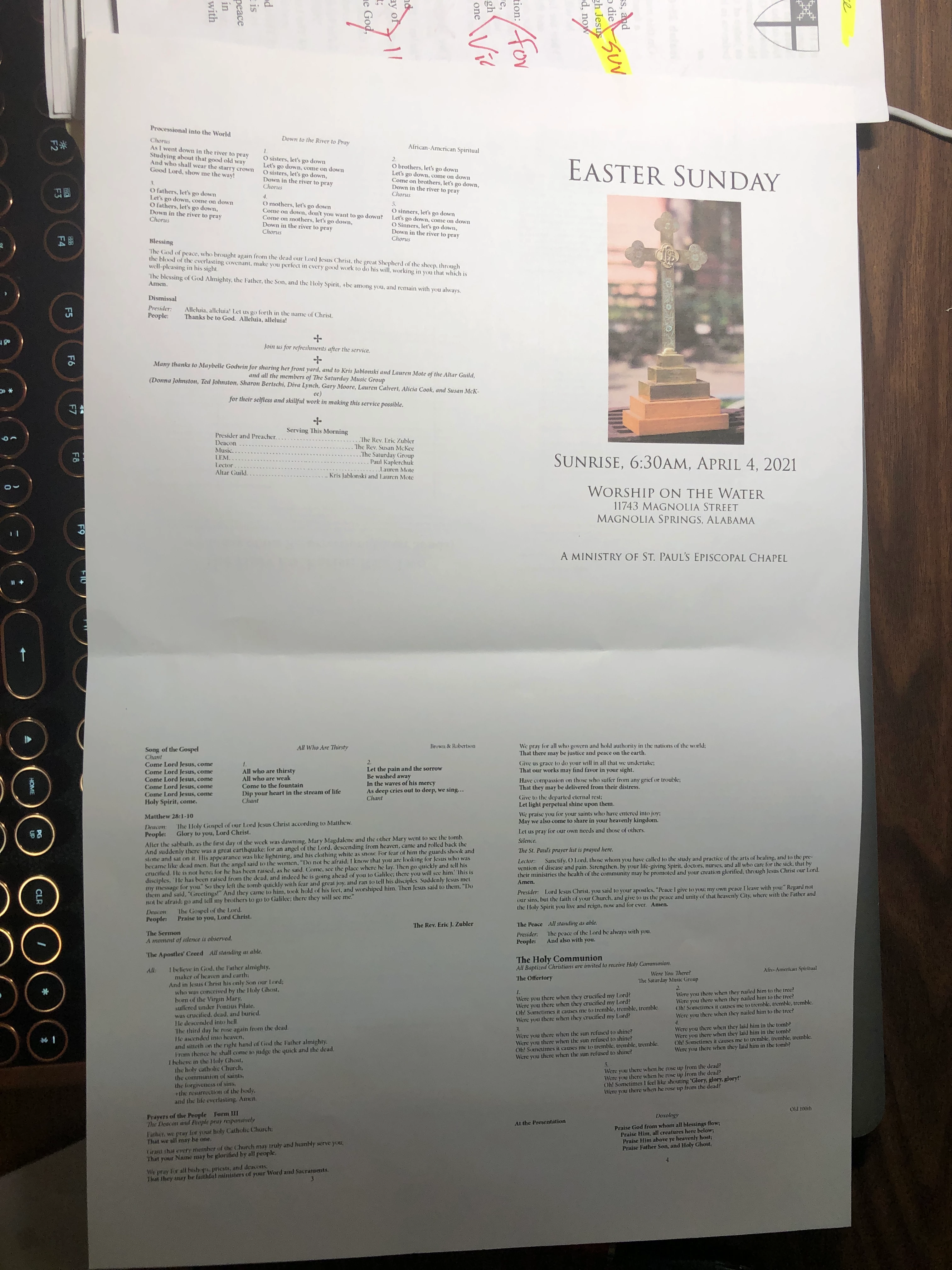

I am trying to print an 8-page booklet, 2-up saddle stitch, from InDesign CC 2021, individual page size 8.5x11, onto 11x17 paper using a Brother MFC-6535DW. Both the "print booklet" preview in InDesign and the "Layout" preview in the printer (see attached screenshot) show the correct size and orientation of pages. However, the output from the printer is the wrong size and orientation (see image attached), and the pages printed on the other side of the sheet are head-to-foot rather than head-to-head with the pages on the side shown.

I think it depends on the print driver. I print via a Postscript RIP to my large format printer and don’t have any problems with InDesign printing. I also tested Print Booklet to my non Postscript Brother printer and was able to replicate the OP’s problem when I set Pages per Sheet to 2.
rob day
March 18, 2021
It‘s because you are setting Pages per Sheet to 2 in the OS Print settings. Print Booklet imposes printer spreads so you need to leave it at 1.

  • First I'd try changing your two-side Printer Setup setting from Short Edge to Long Edge. That would align the duplex printing to print pages in a vertical format instead of a horizontal one.
  • Make sure that print spreads settings are turned off. That turns two pages in your InDesign document into one page for printing output.
  • And I haven't seen the actual InDesign document layout, so please excuse me for saying this if it isn't the case. But it happens often enough that I have to ask: The InDesign document is done with separate, letter-sized pages and you haven't tried to lay out the spreads yourself, right?
If you've done all these things and it hasn't worked out, come back and let us know and we'll try other fixes that may help you. If these things don't work, please show us how your booklet pages are laid out in the InDesign document. That'd help us help you.
