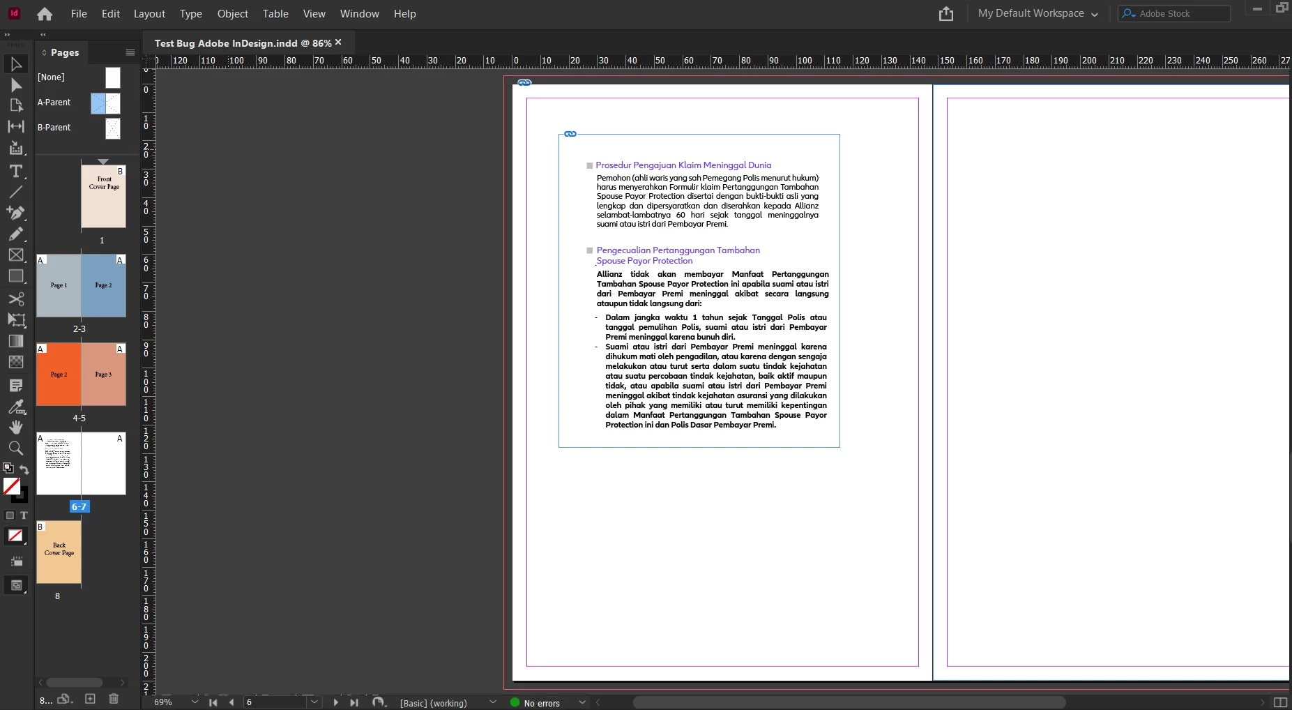

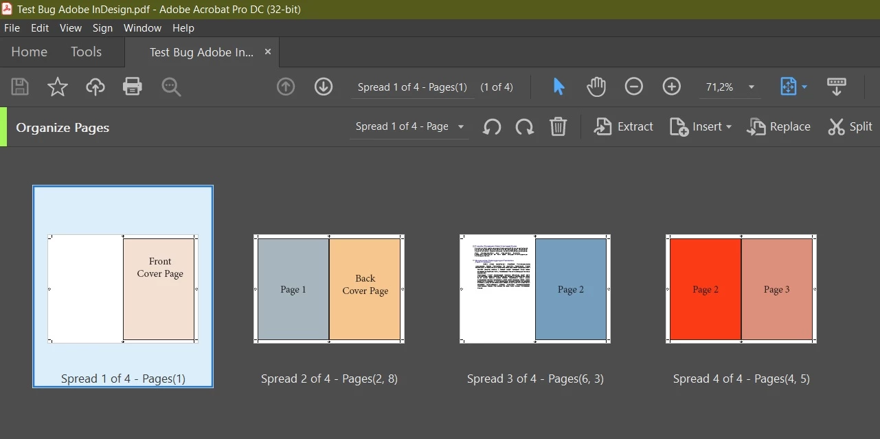

I have same problem also when create a brochure as the facing pages which one page is a blank page, then InDesign cannot sort the page perfectly after export a PDF through Print as a Booklet... please see my sample attached.
The reason I frequently use the Facing Page due to easy to sort a page base on number which for the facing page print as booklet should be have minimun 4 pages then Print as a Booklet to create a PDF with Print & Crop Mark to print in commercial printing facility.

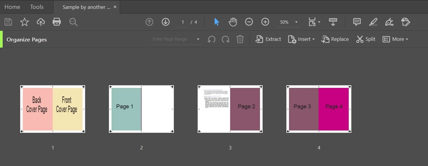

handjojot17224968
July 21, 2022
This Print a Booklet as PDF with correct sort page even with the same layout which page 6 & 7 is facing page and page 7 contain a blank page, no issue after print as a booklet (I use another app.).
I hope from Adobe InDesign Technical Support can assist as to solve this issue.

handjojot17224968
July 21, 2022
Sorry forgot to attach a screenshot the correct PDF layout.
Thank you for the kind attention.
Best regard,

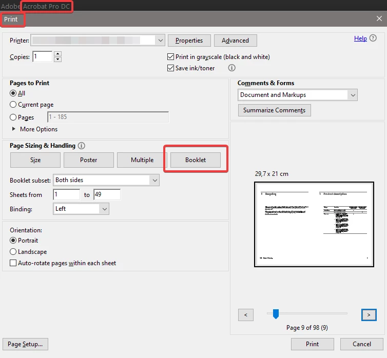

Yes, you should export the PDF as usual from InDesign, then use Acrobat Pro to print as booklet.

February 28, 2020
Sorry,  I propably didn't explain myself correctly.
I meant that when i export the pdf using Print Booklet feature, the exported pdf has some pages blank.
But I didn't know about Acrobat's booklet feature! I used it and got the result I wanted!
Thank you very much!
