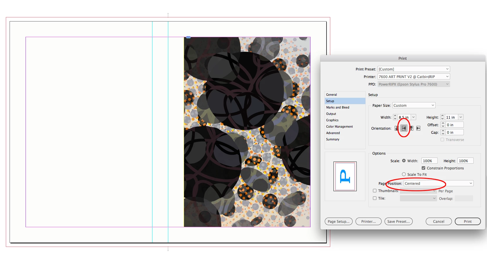

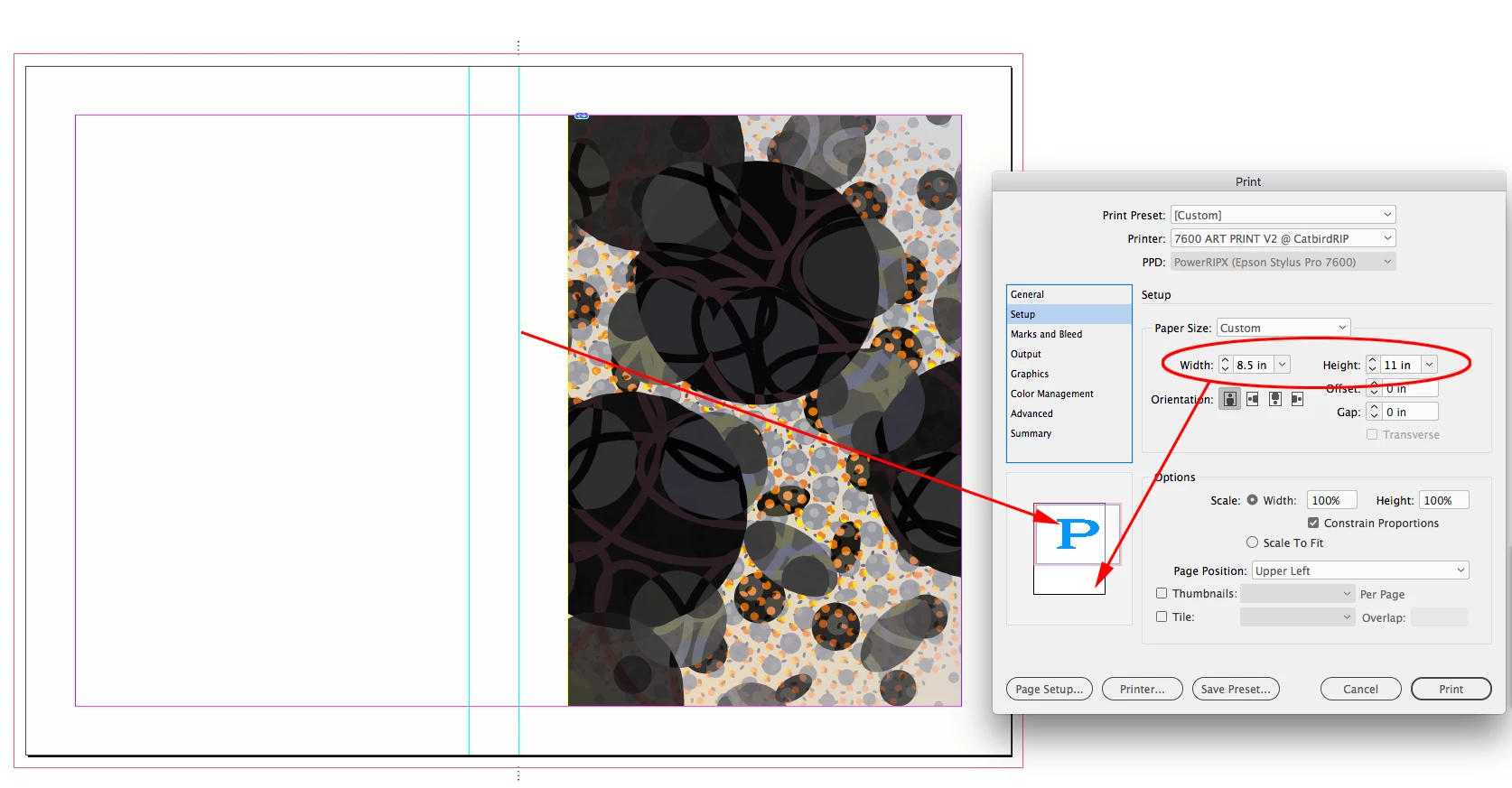

InDesign only provides a page and paper icon preview in the Print dialog, if you Export to PDF as Derek suggests Acrobat has an image thumbnail preview.
In the Print dialog’s Setup tab the rectangle with the P represents the InDesign page dimensions, and the white rectangle behind represents the Paper Size defined in the Width and Height fields. The pink border represents the Bleed set in the Marks and Bleeds tab. Here my ID page dimensions are 10" x 5", and I want to print on an 8.5" x 11" Paper Size. I have the Orientation set to Portrait and the Position set to Upper Left, so the ID page I’m trying to print doesn’t fit on the 8.5"x11" paper.
To get the page to fit, I have to change the Orientation to Landscape with the Position Centered, and the InDesign Page Icon rotates counter clockwise and centers on the Paper Size icon.
