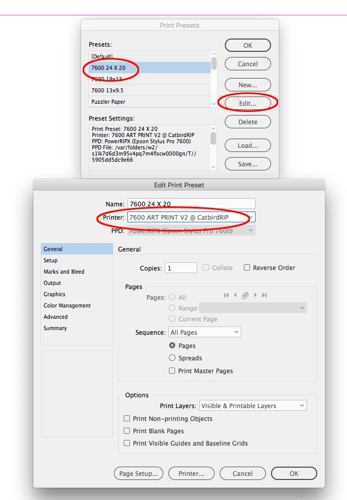

rob day
Apr 17, 2020 1:44 PM UTC
Are both printers using the same driver software? You might check the Presets to make sure the correct Printer is saved with the preset File>Print Presets>Define:
