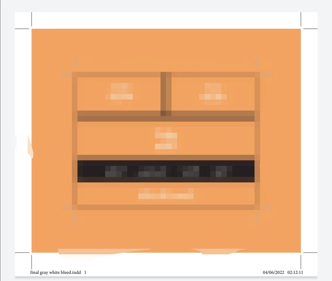

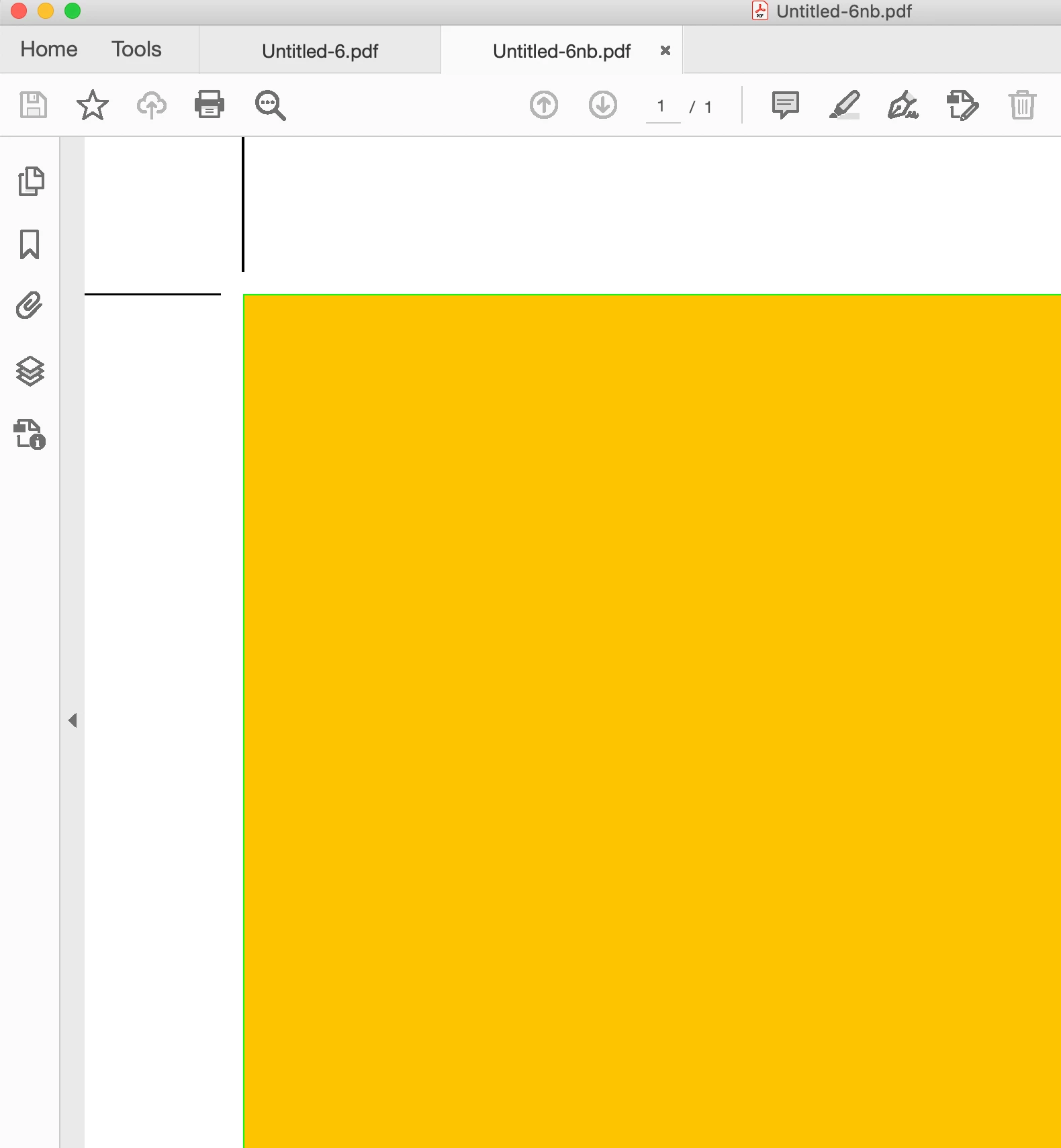

When I save an indesign document, the crop marks and bleed marks are outside the bleed and background and I need them on the background.
The first picture is what I did.
The second picture is what I reed.

Your first picture shows only bleed marks, the second only crops, which, in my opinion, are not properly offest. ALL marks should appear completely outside the bleed area so that they do not accidentally show in case of poor trimming.

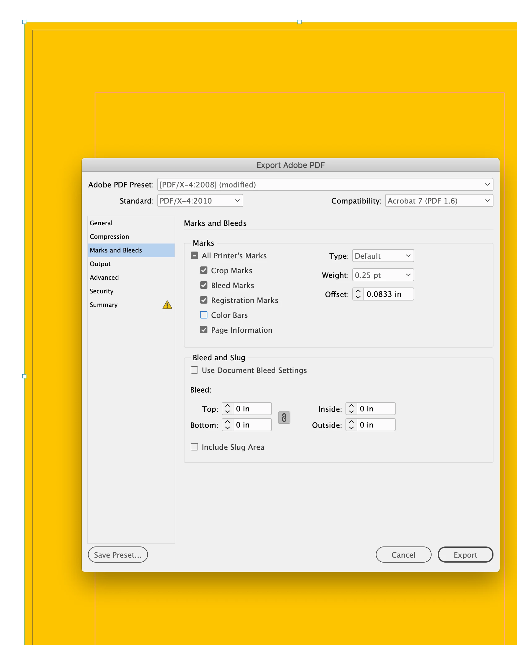

Hi Peter, If the document includes a bleed, but the Bleed is set to 0 in the Print or Export dialog, the Bleed and Crop marks would be on top of each other and there would be no bleed area, which might be what‘s happening in @Pop24801432prm6 ’s first capture

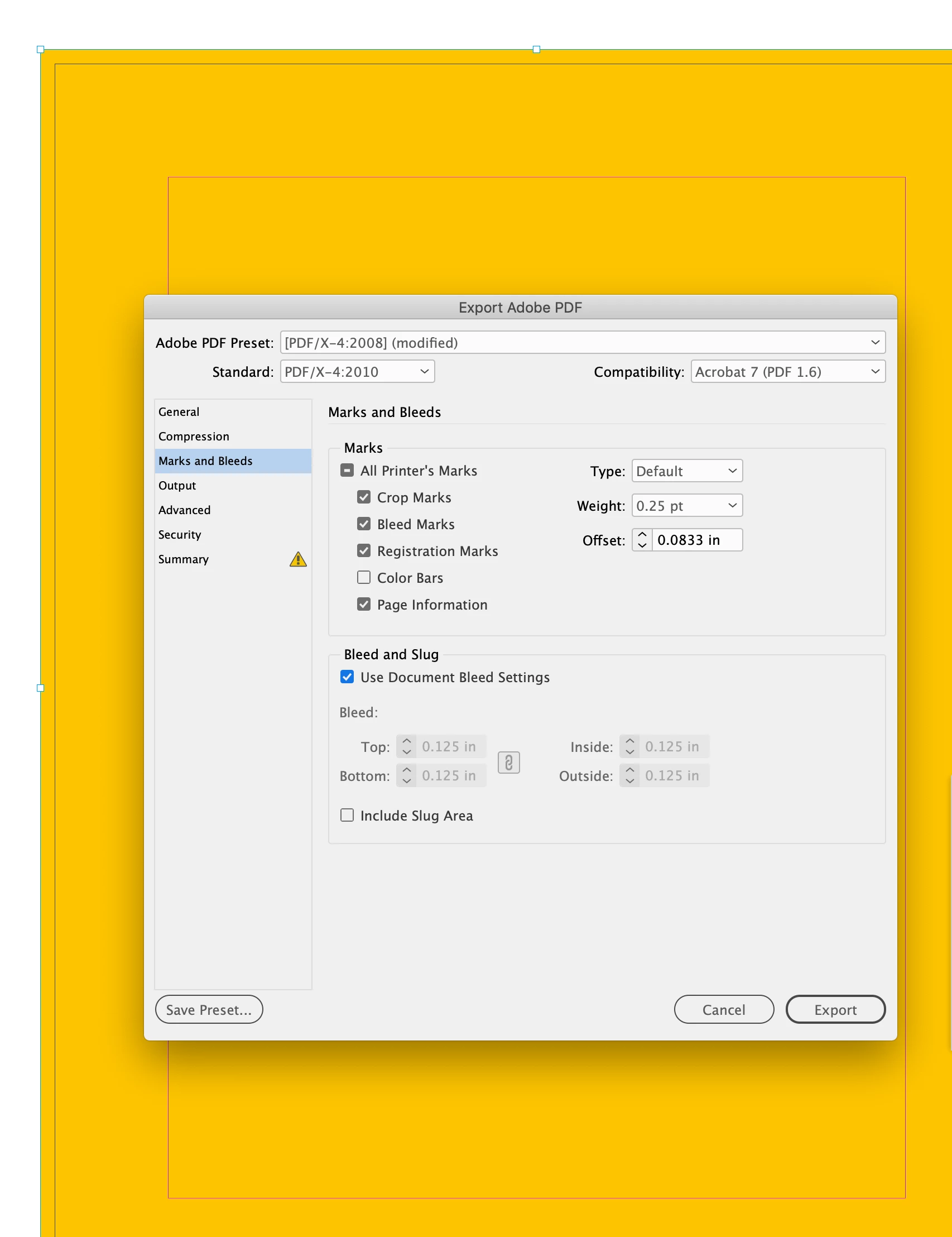

Hi @Pop24801432prm6 , Also in the Print or Export dialog’s Marks and Bleeds tab, make sure you check Use Document Bleed Settings, and the bleed is not set to 0:
