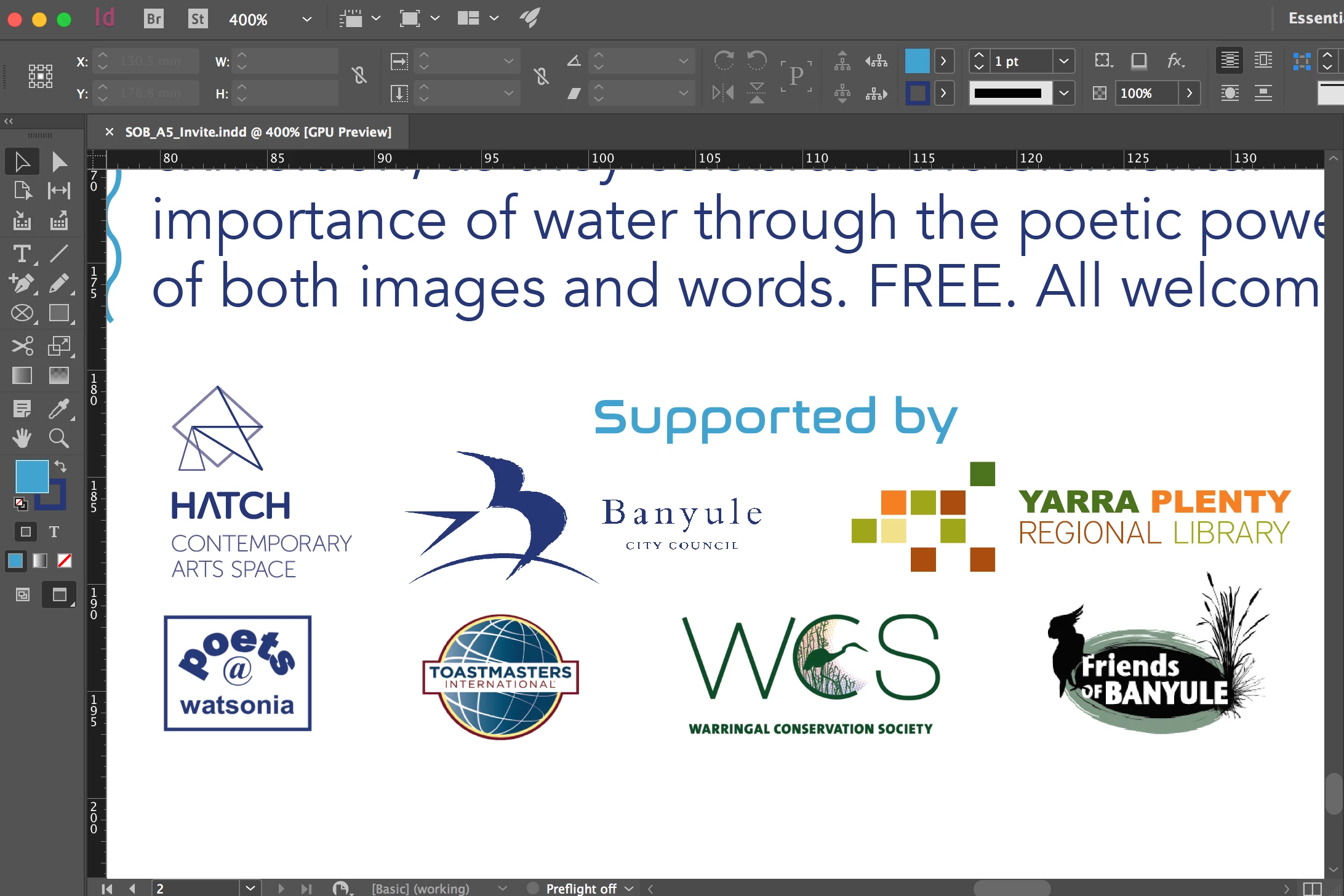

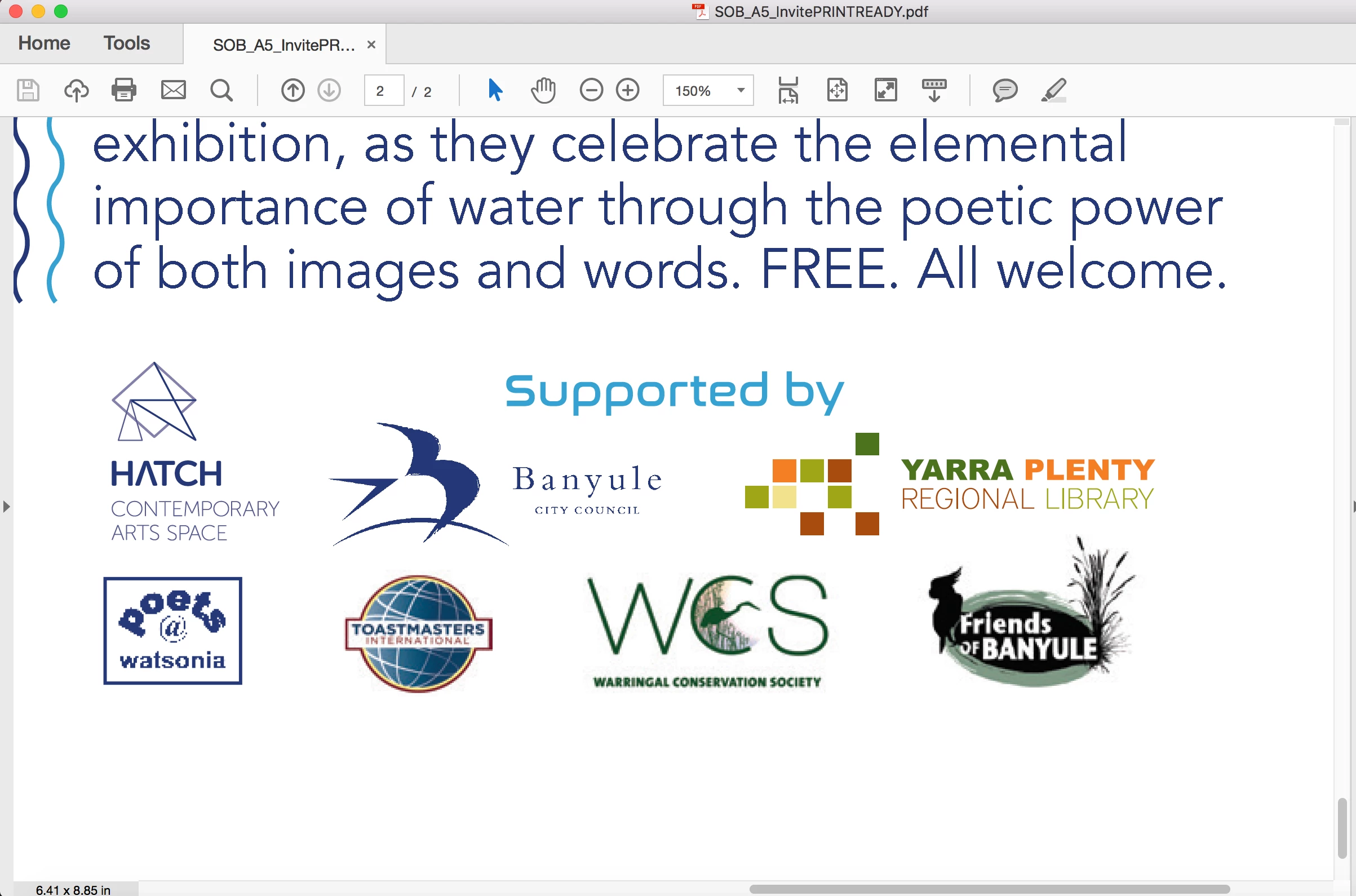

Hi guys, I am preparing a file for print and by exporting to a 'press quality' PDF (the only modification is selecting all printers marks). When I open the exported file to check it in Acrobat, the jpegs are pixelated although reading clear in the InDesign document. The files sizes range from 72dpi to 300dpi and are reduced significantly down to 10-20% of size. If it was simply the 72dpi jpegs pixelating I could understand but even the 300dpi file @17311199% is pixelated on the PDF. Any ideas? This problem has only started since the last update from my Adobe subscription.
    If you scale a 72ppi image to 10% its output or effective resolution would be 720ppi.
    Both the Press Quality and PDF/X-4 presets use the same compression settings, so I doubt switching presets will change the quality of the logos because the setting is to down sample any image with a higher effective resolution than 450ppi. While for most images the 300ppi rule-of-thumb is adequate, you might want to turn off down sampling in this case because the logo's text would benefit from higher than normal resolution—small text needs more resolution.

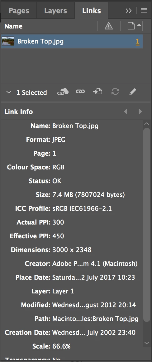

    Check in the Links panel the "Effective PPI" of the images.

    Thanks for the reply Derek, interesting, I've always used the default press quality without issue or complaint. What is the difference? I'm not sure how/where 'Effective PPI' is on the links panel? Just now, by changing all the compression options to 'do not downsample' even though they were set by default to press quality (300dpi) the PDF is all clean. I've not had to do this before. I did try using PDF/X-4 with no change (this was suggested on another forum as a solution).
    Derek Cross
    July 22, 2017
    Re PDF, assuming you're working in RGB color mode (as you should be), PDF/X-4 converts correctly to CMYK and retains transparency. (If you were to be printing to a high end inkjet printer you would chose High Quality Print and this would allow your RGB images to use the Printer's conversion software and allow CMYK+, which has a much wider gamut than CMYK.)
    Here's a screen shot of the Links panel:
