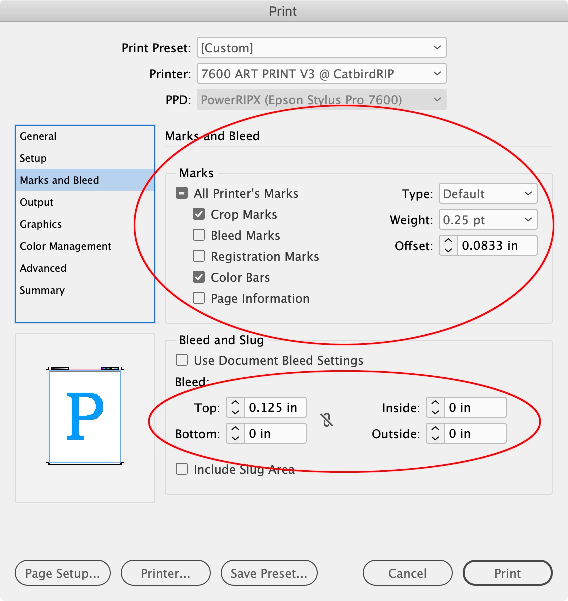

    Hi @DRM5303 , The print requirments for a page layout program like InDesign are more complex than an image editing or illustration application. Generally speaking the print parameters that are not printer specific—do you need bleeds, are you outputting color separations, do you need printer marks, etc—are found in the Print dialog:

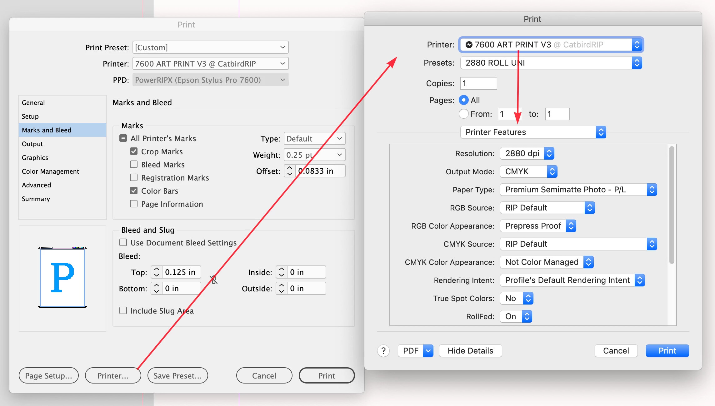

    The Printer... dialog generally has parameters that are specific to the chosen printer and are not universal to all printers:
