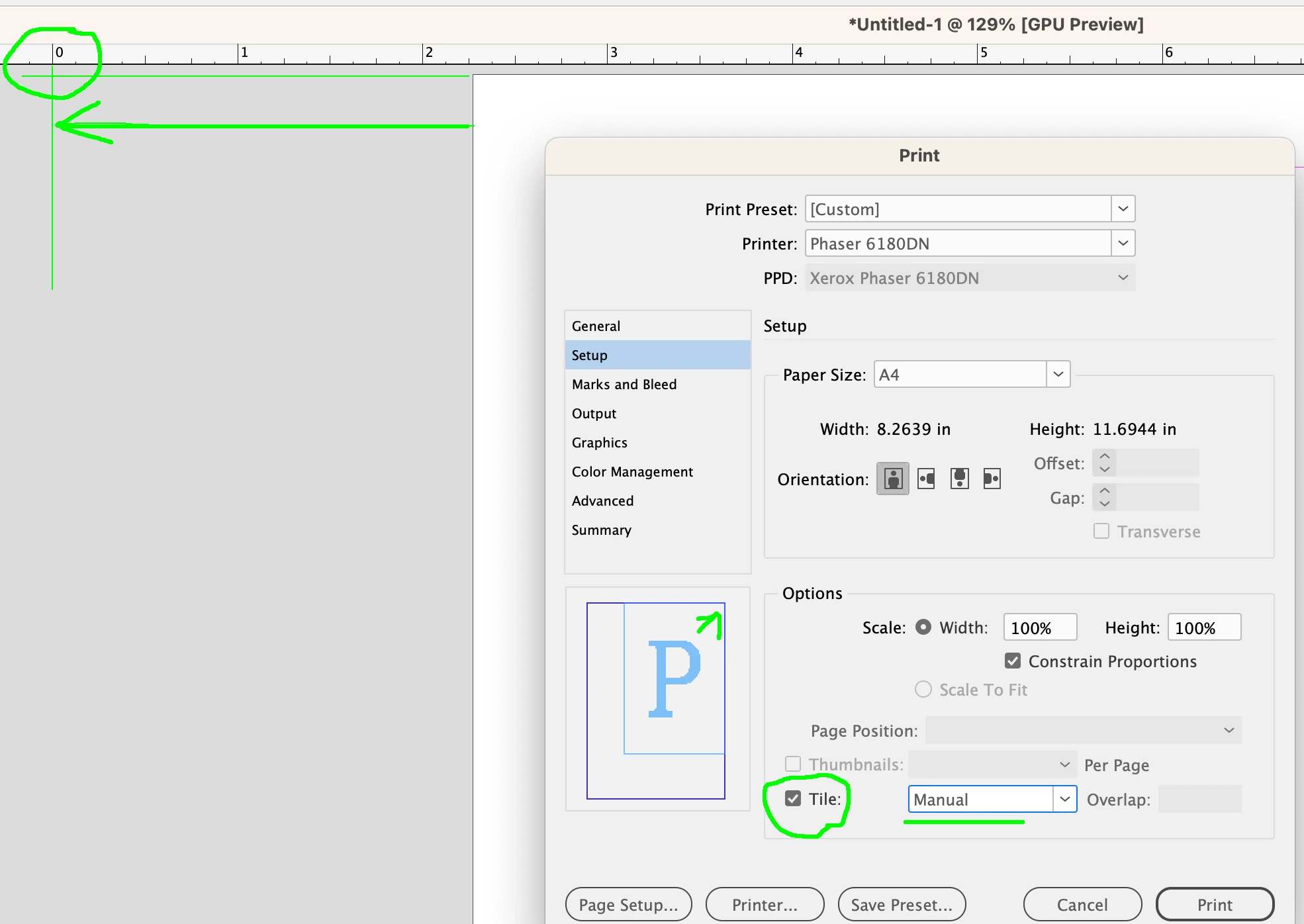

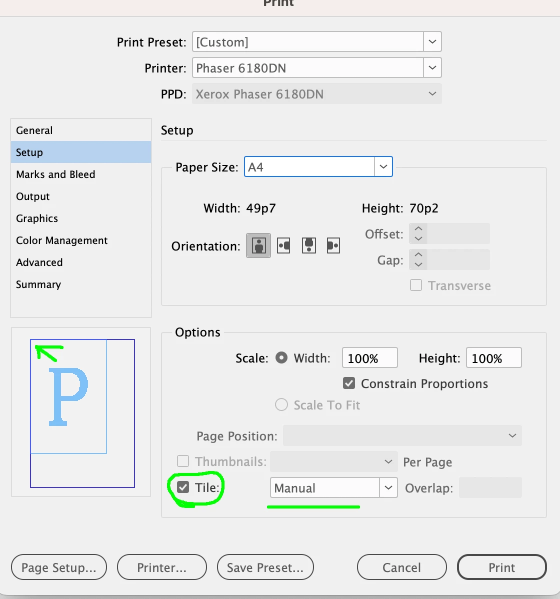

As mentioned, printing centered is the way to go, but if you truly want to print to the corner of a sheet, you COULD do a Manual Tile, but you wouldn’t be able to print both sides automatically. You would have to print all the odd pages first with the Tile origin set at the top left 0,0 mark, then print all the even pages with the Tile origin moved to the left 2.637” (A4 width minus 6”). Not sure it’s worth the time and effort for 200pages ;)
