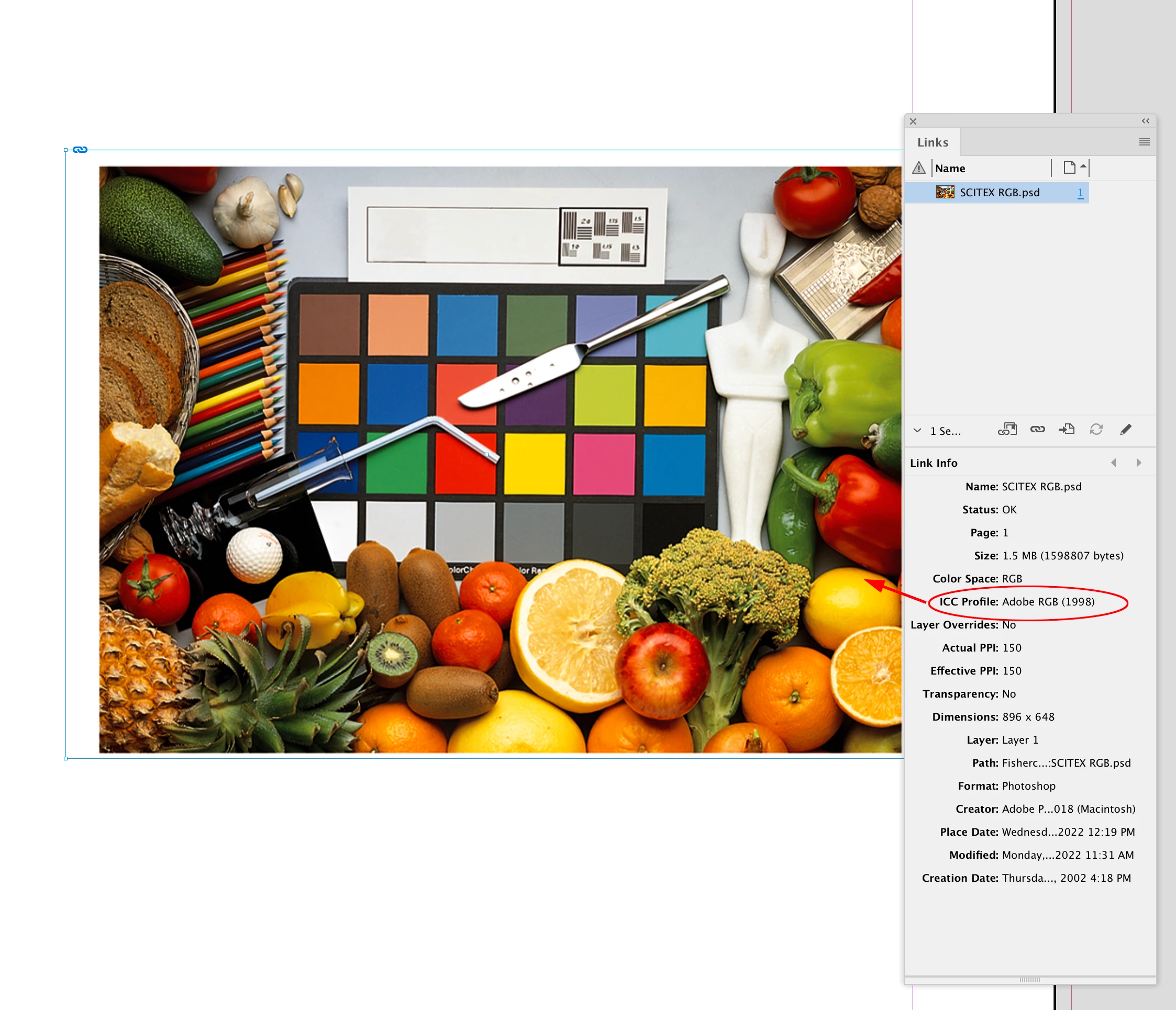

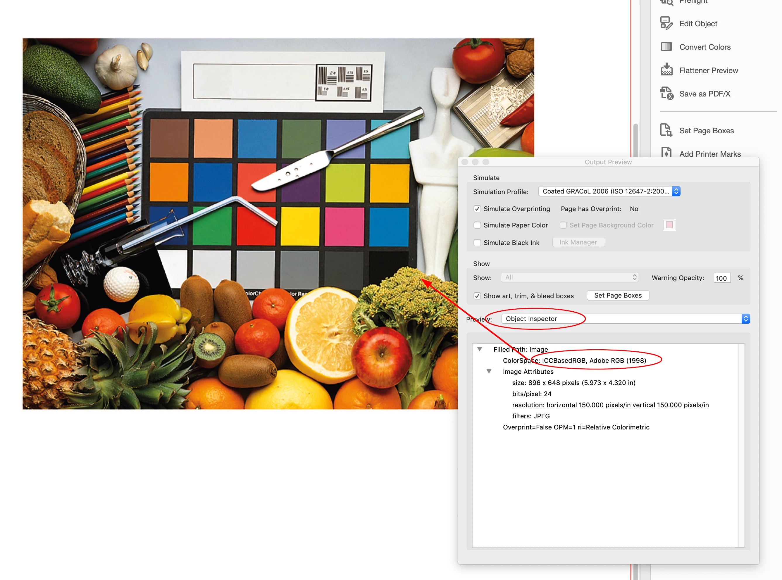

If the print driver is making the final conversion at output (which is usually the case with composite printers), you might get more accurate results by working with profiled RGB images and colors, and let the conversion to the correct output profile be handled by the print driver. You just want to make sure all of the RGB color is exported with a profile. You can use Acobat’s Output Preview Object Inspector to check for color profiles:
