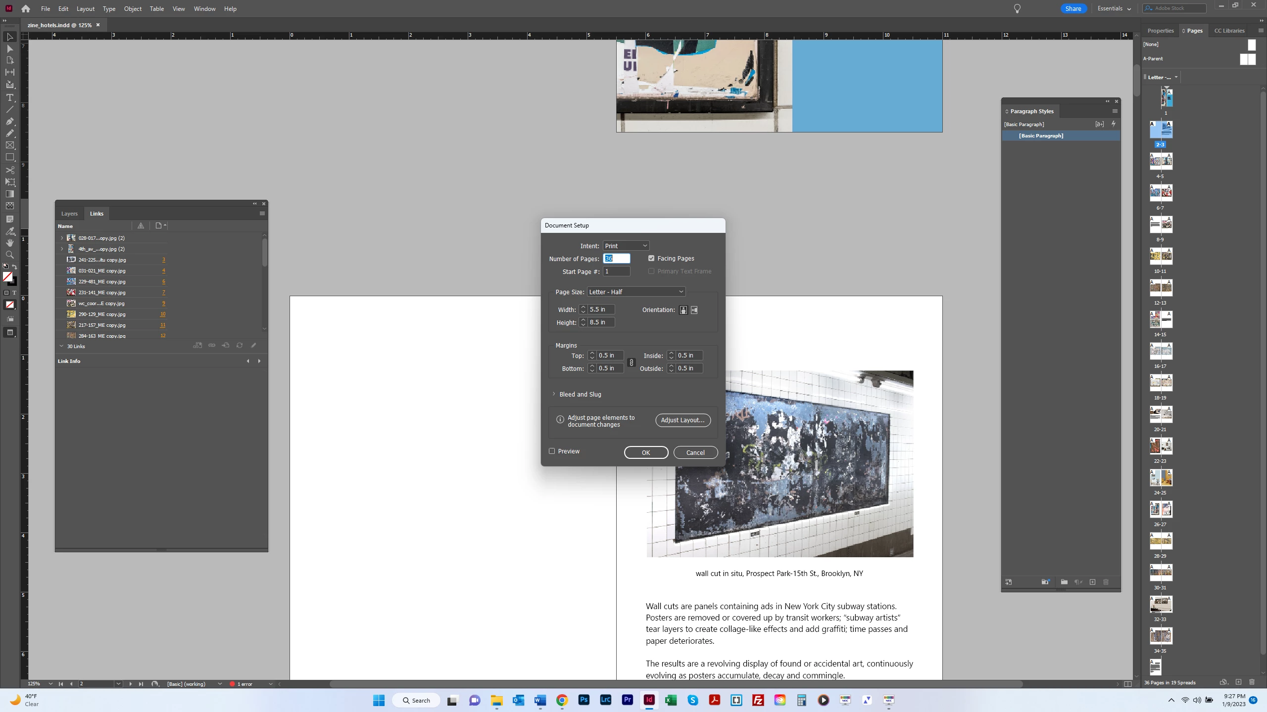

Based on a few posts using "printing a zine" search terms, I'm asssuming what I'm about to ask is impossible.  I created a zine ujsing a document size of Letter - Half, so I could print out my 36 page document on 18 sheets and run them through the printer twice (once for each side - I'm doing this at home).  Is there a way for Indesign to format the zine so that it prints out in the order that results in the pages I need for assembling the book - at least as per the facing pages?  If not, what should I do to achieve that?  Thanks.

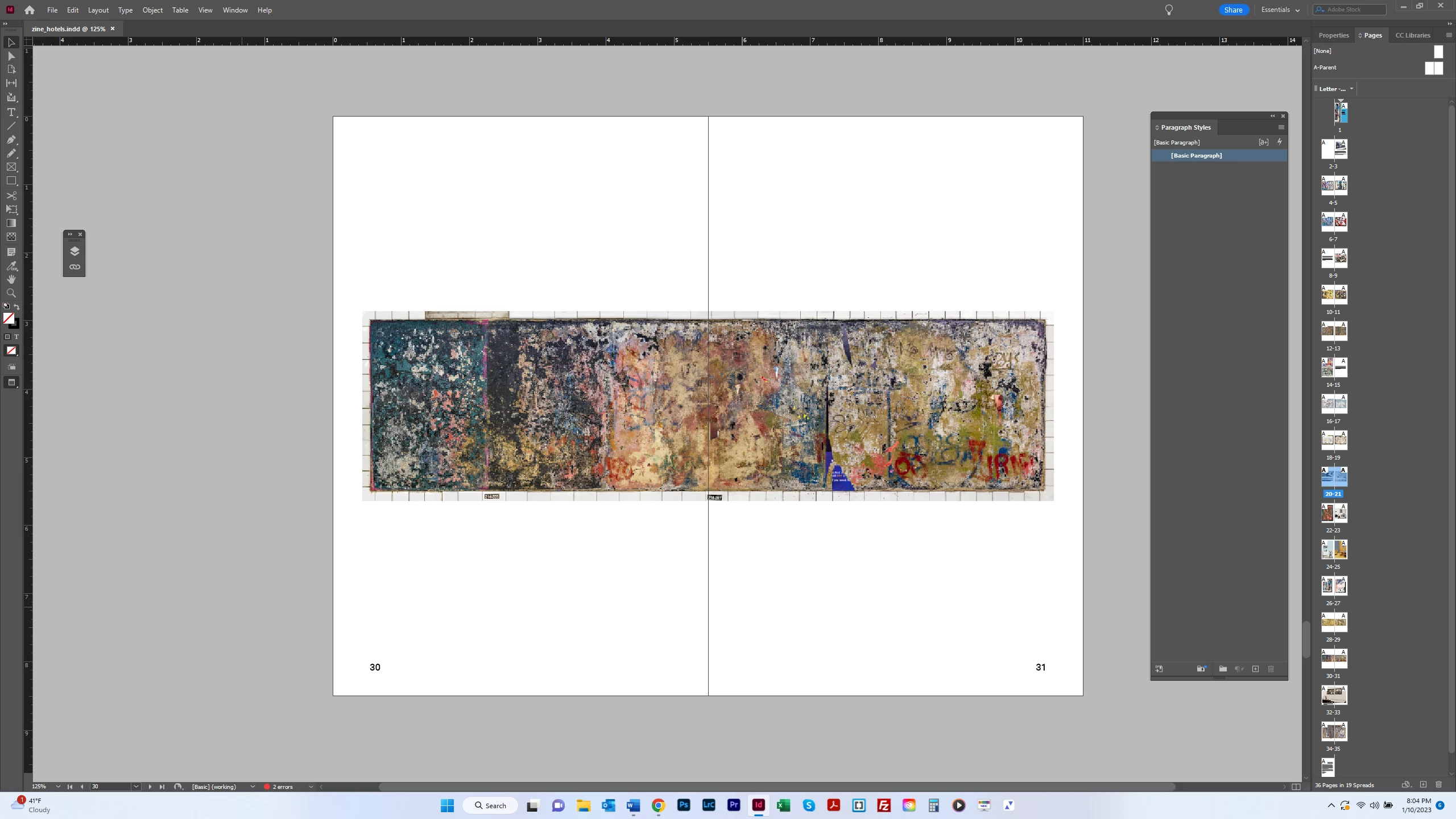

Thank you!  I exported to PDF as advised and chose the Print>Booklet option.  The only thing I had not thought through was having some pages as "spreads," with a wide image printed across both sides of the booklet (see screenshot).  Although I have not actually printed yet, I'm guessing this may not look smooth as the 2 halves are not on the same piece of paper.  I guess this is not done in zines much or is there some workaround which permits a seamless image?  Thanks again, James, Bob, Luke, and Adobe!
Luke Jennings3
January 11, 2023
A cross-over spread is best placed in the center of the book or the front & back cover, if possible. Expect paper movement in a home printer, so it's probably best to avoid cross-over pages anywhere else. A commercial printer will have better control over page registration, binding and creep.
