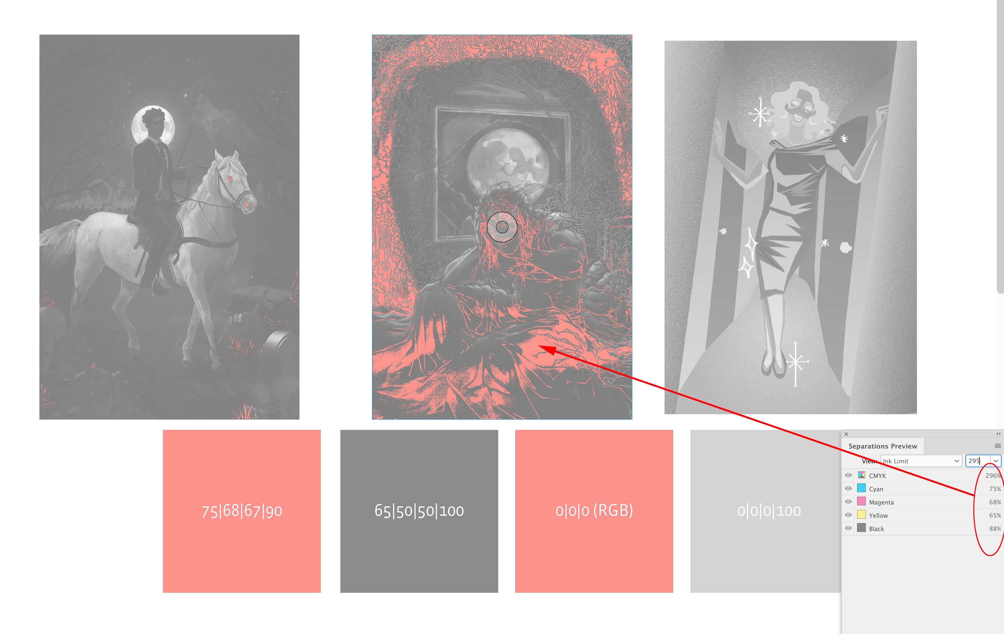

With the exception of the hair in the right image (which was edited in CMYK mode), there are no color corrections you could make to darken the blacks because they are already at the 300% maximum total ink allowed by the SWOP profile. Here I’ve set the Separation Preview’s Ink Limit to 295% so it is highlighting all of the output values between 295% and the 300% max:

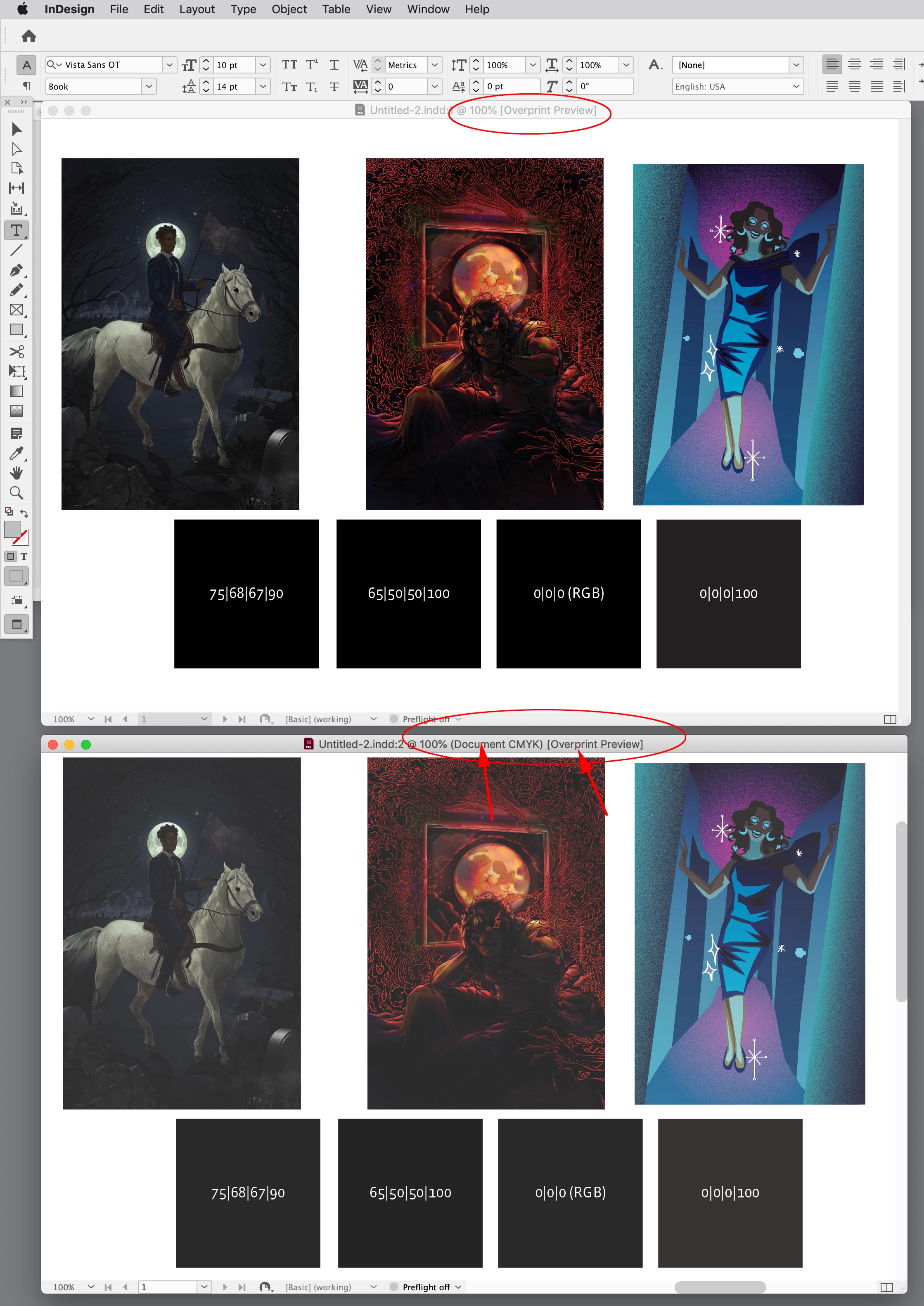

Example below with a section of the original image vs print preview.
Hi @M.Rezvani , Without seeing your CMYK files it looks like you might have Overprint/Separation Preview turned on and Proof Colors on with the Proof Setup set to Document CMYK (your print preview?). If your InDesign document has the US Web Coated SWOP CMYK profile assigned and the CMYK image is also assigned US Web Coated SWOP, there is no need to turn on Proof Colors because Overprint/Separation Preview is already showing the expected US Web Coated SWOP soft proof.
I can replicate your captures by double proofing. These examples have the same CMYK output values, but the bottom soft proof is wrong because I have both Overprint Preview and Proof Colors to Document CMYK turned on.
If I export to the default PDF/X-4 preset Acrobat’s Output Preview uses the SWOP Output Intent profile for the default Simulation Profile, and the blacks are close to the SWOP 4-color black point:
